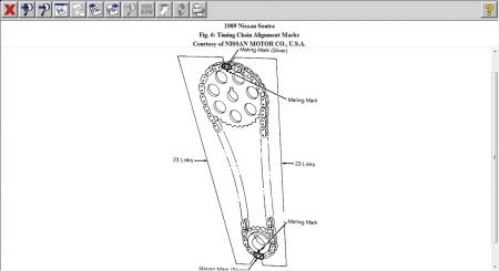

Need correct timing mark setup for top cams and crank pulley. Crank pulley has six matks
