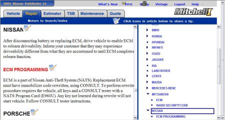

Need help on computer relearn procedure on a 2001 nissan pathfinder, thanks.

This is all I got for the brain to relearn itself-other than to reflash it-no idle relearn see below
