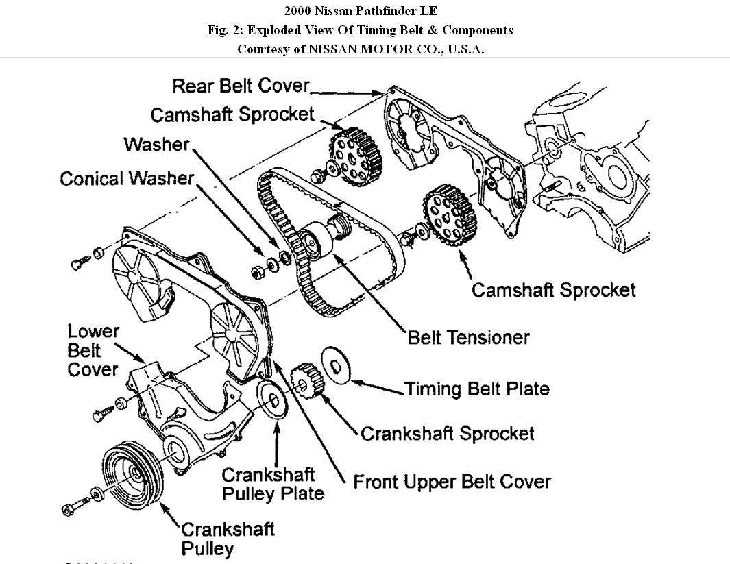

My mechanic has told me that when the timing belt breaks on the V6 engine in our 2000 Pathfinder, that it will not harm the engine. Rather, the engine just stops running. Could you confirm this? Or is my mechanic wrong? Up until the time the mechanic told me this, I was under the impression that if the timing belt broke, I would have a RUINED engine that would have to be totally rebuilt! I need to know whether I am right or my mechanic is right!
Saturday, August 1st, 2009 AT 2:53 PM
14 Replies
DOCFIXIT
  • 18,828 POSTS
Nope your right the engine is an interference type. Pistons strike valve and bend. Are build is not necessary just head removal and replacement of bent valves.
This guide will help you replace the belt look toward the bottom of the page

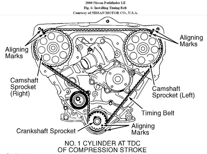

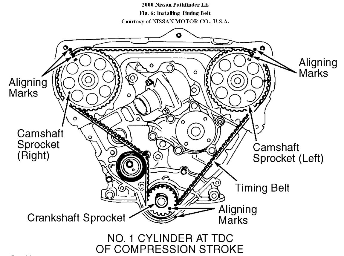

Yes hi, my questeion is how can I put my nissan pathfinder on time. The time belt broke and it seems like no one know whow to put it on time, can u please help me.
+1
Tuesday, June 2nd, 2020 AT 12:58 PM (Merged)
KHLOW2008
  • 41,815 POSTS

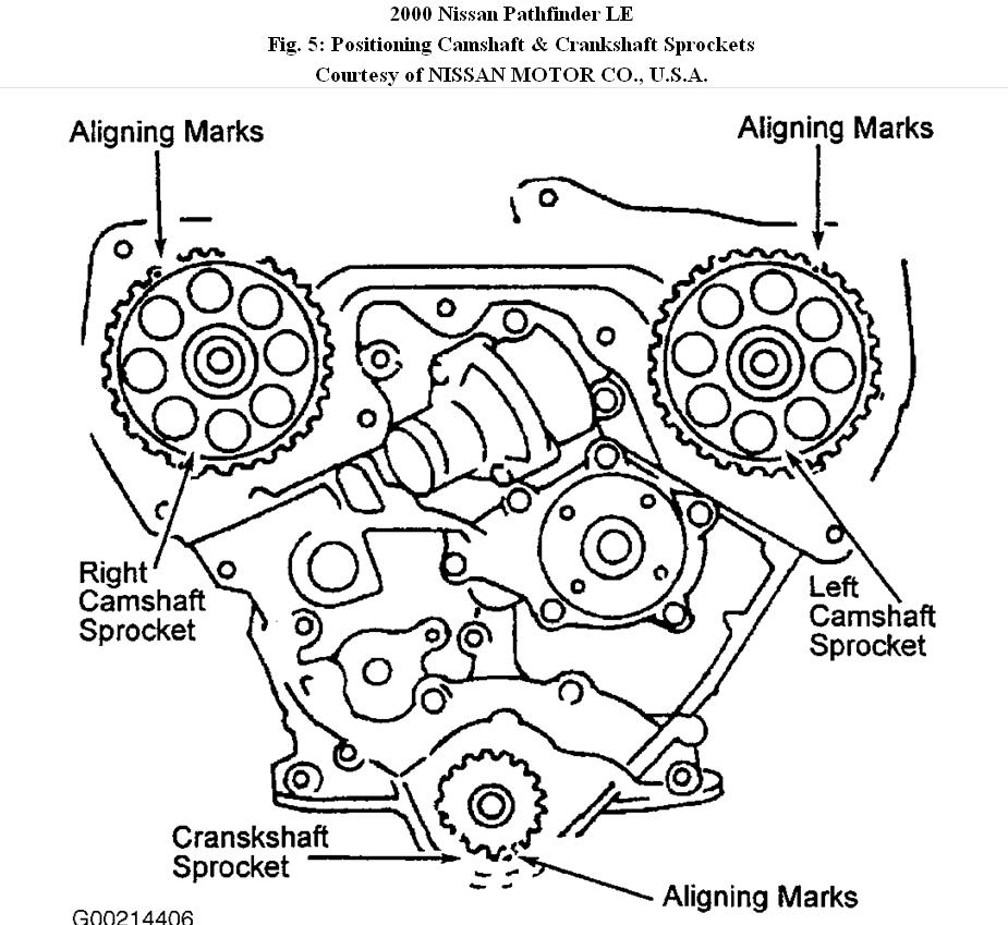

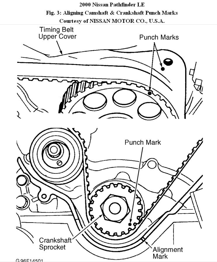

Is engine 3.3 or 3.5 L?
Our database shows only 3.3 L.
This is an inteference engine and miracluously quite a number of engines have survived without any damages to the valves so keep your fingers crossed.
When turning the crankshaft, ensure it does not meet any resistance and DO NOT force. Back off if any resistance is felt. Keep pistons away from TDC before turning the camshafts to desired position.
After camshafts have been aligned then only align crankshaft.

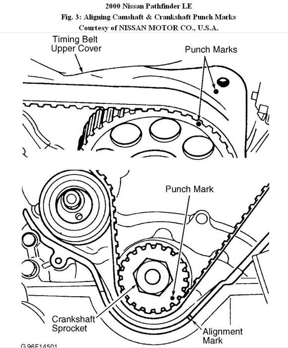

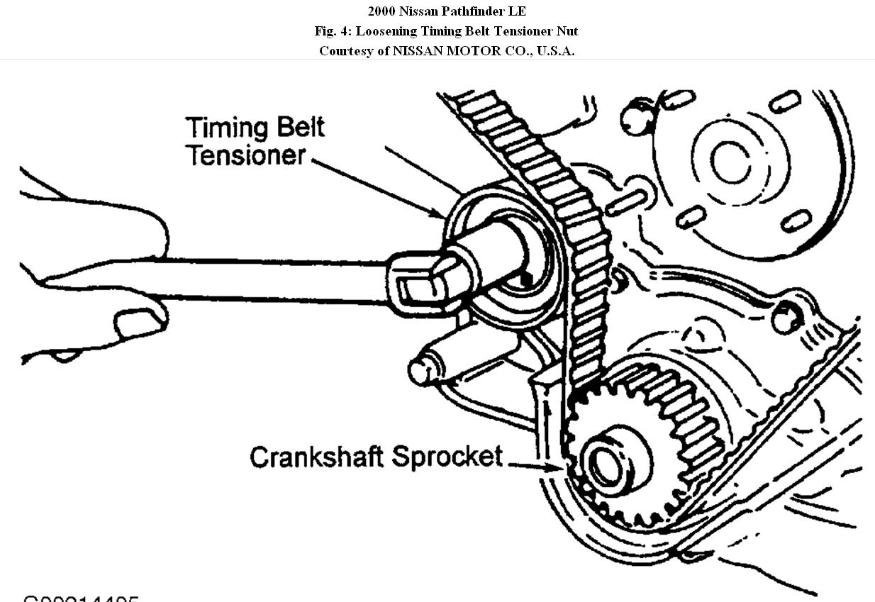

Installation (Frontier, Pathfinder, QX4 & Xterra)
1. Install timing belt when engine is cold. Ensure No. 1 cylinder is at TDC on compression stroke. Crankshaft sprocket mark should align with mark on rear cover. See Fig. 5. If removed, install timing belt tensioner and tensioner spring.
NOTE: If stud for tensioner spring is removed, apply thread sealant to stud threads before installing.
2. Turn tensioner clockwise fully outward with hexagon wrench, and temporarily tighten lock nut. Align White lines on timing belt with punch marks on camshaft sprockets and crankshaft sprocket. See Fig. 6. Point arrow on timing belt toward front belt cover. There should be 40 teeth between left and right camshaft sprockets, and 43 teeth between left camshaft sprocket and crankshaft sprocket.
3. If engine was overhauled or reassembled (rocker covers removed), go to step 6. If only the timing belt was replaced, go to next step.
4. Loosen tensioner lock nut. Using hex wrench, turn tensioner clockwise and counterclockwise at least 2 times. Tighten tensioner lock nut. Turn crankshaft clockwise at least 2 revolutions, then slowly set No. 1 cylinder at TDC on compression stroke. Apply 22 lbs. (10 kg) of force to belt (downward direction) midway between camshaft sprockets. Belt deflection should be 0.51-0.59" (13-15 mm). If not, readjust belt tension.
5. Install lower and upper belt covers. Install crankshaft pulley. Tighten bolt to specification. To complete installation, reverse removal procedures. Fill and bleed cooling system. Adjust drive belts
to proper tension.
6. Loosen rocker shaft bolts to relieve belt tension caused by camshafts. Loosen tensioner lock nut. Using Allen wrench, rotate tensioner by turning Allen wrench clockwise 70-80 degrees. Temporarily tighten lock nut. Rotate crankshaft clockwise at least 2 revolutions.
7. Slowly return cylinder No. 1 to TDC of compression stroke. Using Push/Pull Gauge (J-38387), apply 22 lbs. (10 kg) of pressure to timing belt between right camshaft sprocket and tensioner. Hold tensioner in position with Allen wrench, and loosen tensioner lock nut.
8. Place a.0206" (.5 mm) feeler gauge under tensioner pulley between pulley and timing belt, and rotate crankshaft clockwise until feeler gauge is centered between tensioner pulley and timing belt (timing belt will move about 2.5 teeth). See Fig. 7. Tighten tensioner lock nut to specification.
9. Rotate crankshaft to remove feeler gauge. Rotate crankshaft clockwise at least 2 revolutions, then slowly set cylinder No. 1 at TDC of compression stroke. While applying 22 lbs. (10 kg) of pressure, measure timing belt deflection halfway between camshaft sprockets. If
deflection is not.51-.59" (13-15 mm), repeat steps 6-8. To complete installation, reverse removal procedure. Fill and bleed cooling system. Adjust drive belts to proper tension.

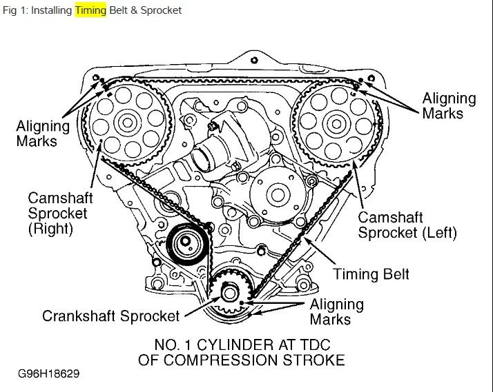

What is the easiest way to fix the timing when I was changing my water pump I managed to knock the timing off how do I fix it?
JDL
  • 16,098 POSTS
I looked at info for 3.3L sohc engine. Our info says this is an interference engine. If you cranked it with valve timing off, you probably have internal engine damage, at the least bent valves, if not more damage.
I can give you alignment marks for cam shaft sprockets and crankshaft sprockets. I can give you info for replacing timing belt, but, if you have internal engine damage, we are spinning our wheels.
Easy or not, I only know one way as far as timing belt.
CARADIODOC
  • 33,752 POSTS
What are you trying to fix? Are you trying to find the timing marks and need to know where to put them, or are you trying to get the timing belt to move a few teeth on a sprocket but can't get enough slack to do that? Are you aware this is an interference engine? Do you have a copy of the manufacturer's service manual?
