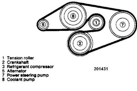

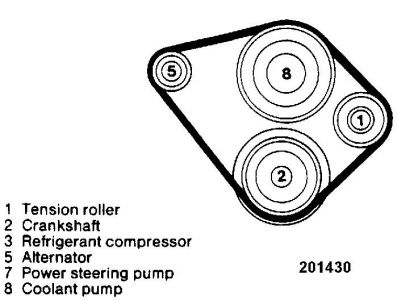

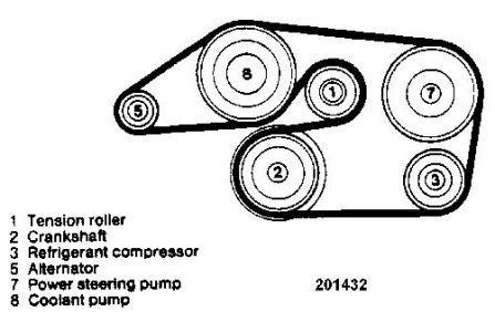

I am installing a serpentine belt on my mercedes 260e 1987. I need the belt routing diagram.
thanks

Here the serpentine belt route:
(there is three fig. choose the one that apply to your car)
