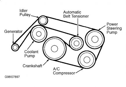

I have a 97 benz e320 3.2L iand my serpentine belt broke I do my own work an I need a routing for my new belt
Wednesday, July 18th, 2007 AT 8:28 PM
GFIMOTORCARS
MECHANIC
673 POSTS
The following is the belt routing diagram for your vehicle.
