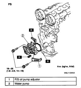

I may need to replace water pump. What is the procedure? Are any pix available? Really need to find a repair manual!
Saturday, January 30th, 2010 AT 11:48 PM
MECHANIC
75,992 POSTS
Hi,Welcome to 2carpros and TY for the donation.
WATER PUMP REMOVAL/INSTALLATION
1.Remove the timing belt.
2.Drain the engine coolant.
3.Remove in the order indicated in the table.
4.Install in the reverse order of removal.
