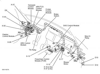

Where is the engine control computer locared on a 1999 mazda millenia? Ineed to replace it.

It is located under center of dash....
