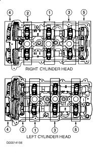

what do the cam caps torque on for the 2.5 engine

Sorry for delay have sequence and torque 100-125 IN. LBS. see diagram for sequence
Hope this helps
Let me know if you need more info

Could you please tell me what that would be in foot pounds

15 ft. Lbs. That, s a little heavy for 1/2 drive torque REALLY recomed use of in. Lb. Torque to prevent damage to caps
