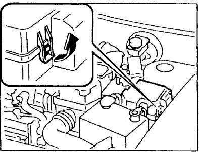

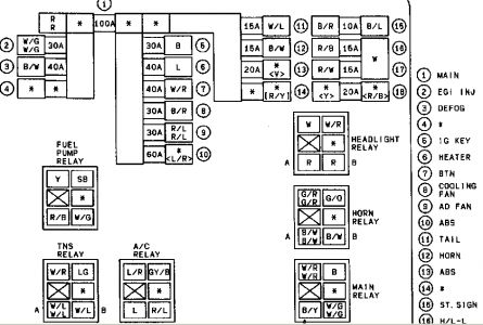

Does anyone know where the fuel pump relay is located in my car or where the fuel fuse is located?
Sunday, February 22nd, 2009 AT 10:55 AM
MERLIN2021
MECHANIC
17,251 POSTS
In the main fuse block under the hood behind the battery.
