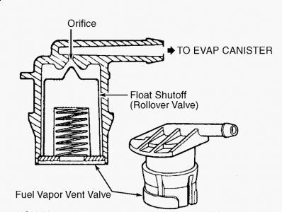

My car makes a gurgling noise from the gas tank and when I put gas in it it keeps spitting the gas out
Saturday, March 13th, 2010 AT 9:28 AM
MERLIN2021
MECHANIC
17,250 POSTS
Check the vent valve on top of the gas tank, and the hoses, check them for leaks or kinks.
And always turn the car off when refueling!
