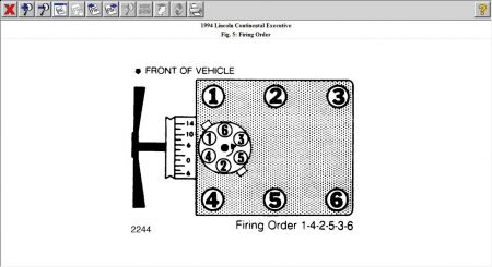

1994 LINCOLN CONTINENTAL
Six cylinder two wheel drive automatic.
I need the firing order for my sister's car listed above it is a 3.8 fuel Injected automatic sedan.
Please help!
Thank you
Saturday, May 30th, 2009 AT 5:44 PM
MECHANIC
75,992 POSTS
Hello PURPLETURTLE036,
Below is the firing order for your sister's car. Thank you for visiting 2CarPros!
