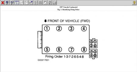

hey guys I need a diagram or picture or anything on where the spark plug wires go to each cylinder
plz help asap stranded at workk!

See below

Hey man u h ave a number I can call or something. I dont know where the wires go from the cylender to the coil or rotor where they all together

Is your engine a 4.6L? If so I just gave you the F/O and follow the diagram above from the coil packs to the sparkplugs
