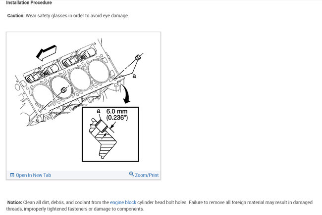

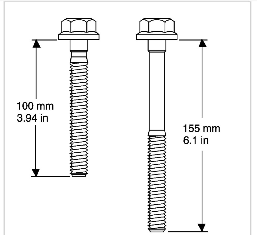

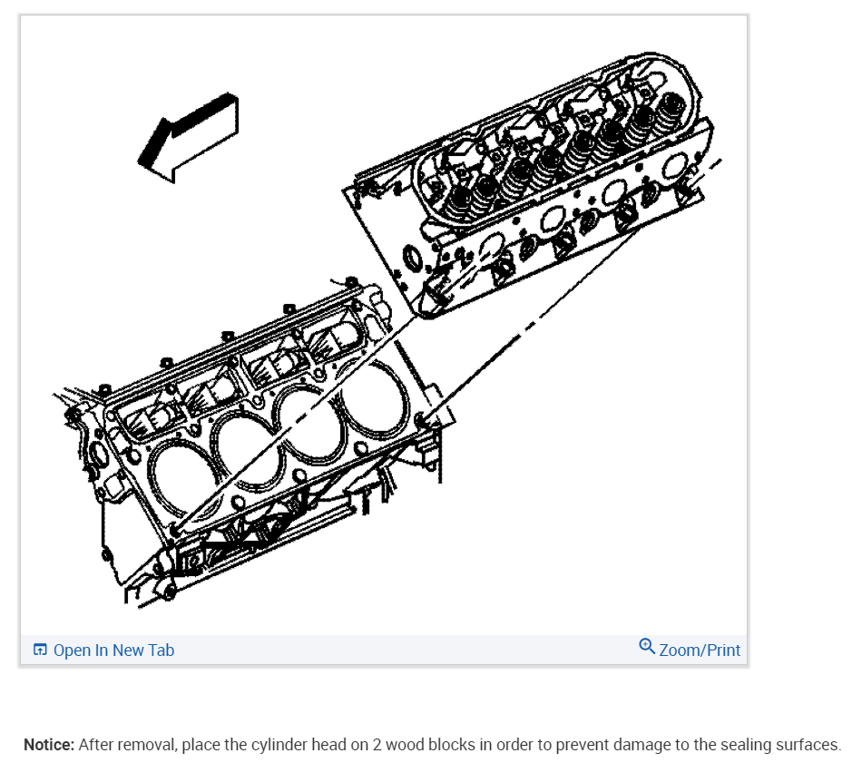

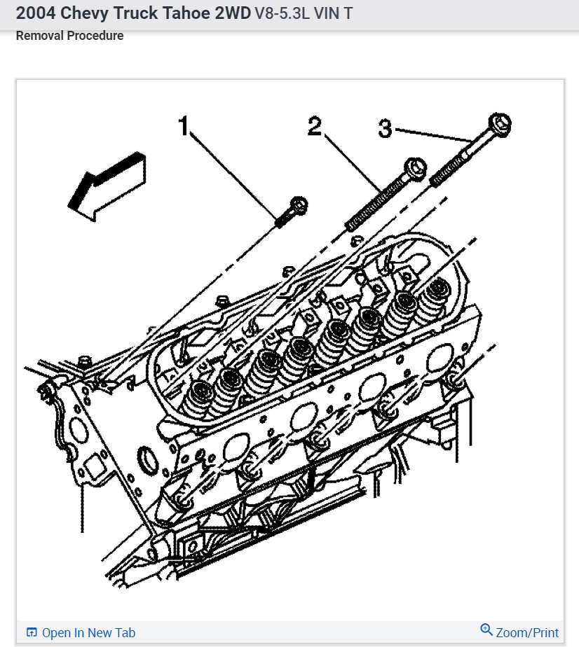

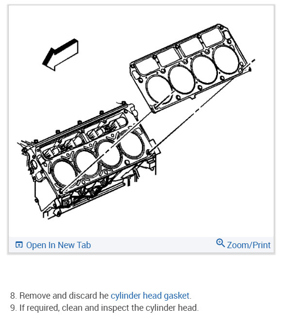

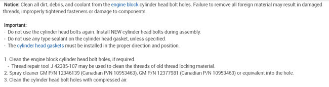

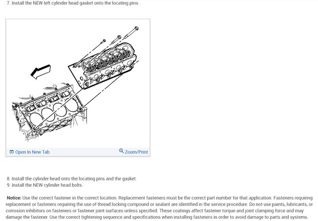

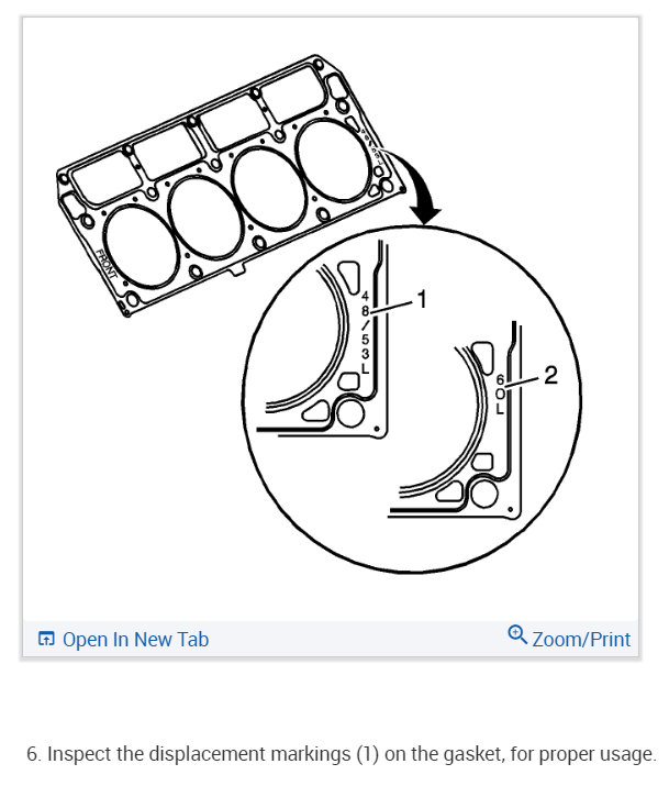

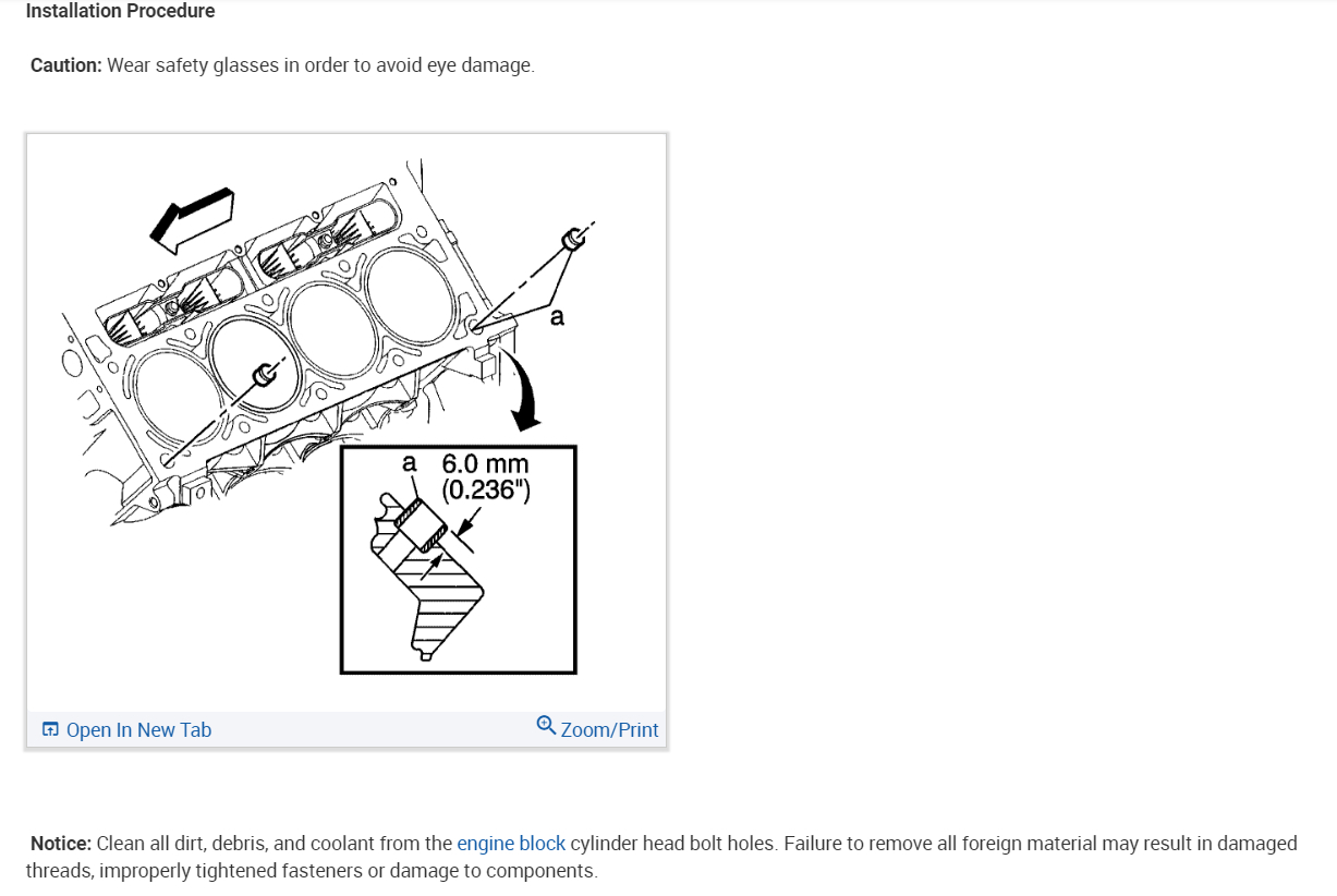

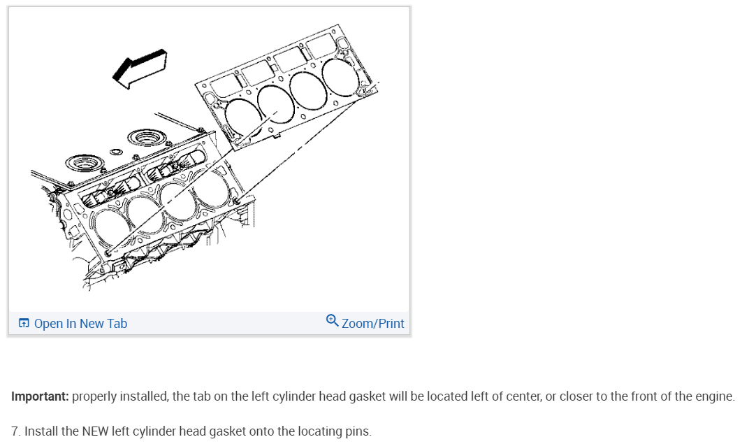

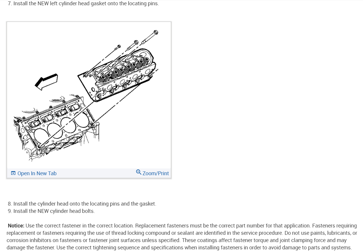

It is best to inspect test all springs and valves to replace as needed, please post pictures or video of the job. Here are diagrams to help you get the job done it shows the torque specs as well. Check out the diagrams (below). Please let us know what you find. We are interested to see what it is.

I am going with new head bolts but not sure if I need first or second design bolt kit.
I will dig deeper.
