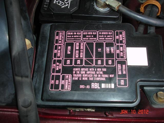

While driving my battery light came on. On the way home I stopped at the local auto parts store to have the battery and alternator checked. The battery was fine but the alternator came up bad. Drove home and parked the car. I went to start it two days later and it would turn over fine but no spark. Could a defective alternator toast my distributor? The distributor was replaced in September by the way.
Monday, January 4th, 2021 AT 12:29 PM (Merged)
HMAC300
  • 48,601 POSTS
The alternator shouldn't toast the distributor but starnger thing have happened. Check your underhood fuses though, there is one for the alternator, I thinkis #41 otherwise it may be an module problem not the distributor. Or a ground for the module.
S1920L
There is no #41 fuse. There is a fuseable link #41 printed on the wiring diagram but no such fuse.
HMAC300
  • 48,601 POSTS
Well check that s they burn up. In our manual it was listed as a fuse. Oh well stranger things have happened.

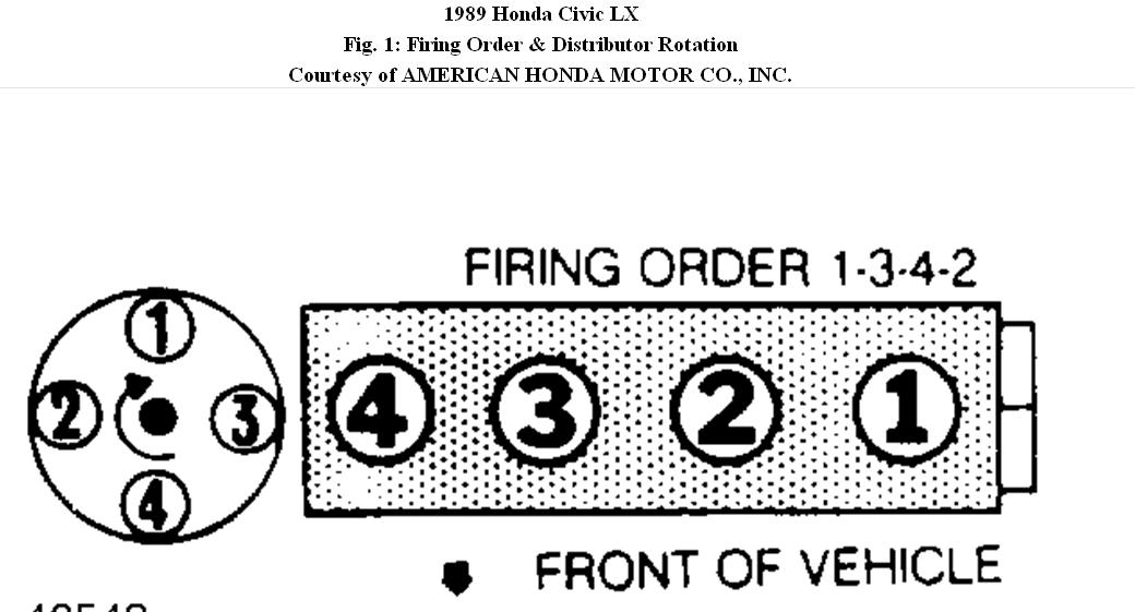

I have a 89 Honda civic lx I put a new distributor on and it won't start its getting gas and had good spark it fires but won't start
Monday, January 4th, 2021 AT 12:30 PM (Merged)
KHLOW2008
  • 41,814 POSTS
Were the firing order of the spark plugs lined up correctly?
What was the reason for replacing the distributor?
BUTCH SWICKARD
  • 10 POSTS
Dome one stole it and the firing orders fight
KHLOW2008
  • 41,814 POSTS
Retime the distributor. Turn piston # 1 to TDC on firing stroke and note if distributor rotor is pointing to # 1 cylinder. Some remand distributors are installed 180 degrees oposite so the firing order would be out.
If engine had been idle for extended periods, check the compression. They could be low due to the cylinders drying out and does not have any lubrications to seal the piston rings. Remove spark plugs and pump some engine oil into cylinders. Crank the engine for a few seconds and reinstall spark plugs and retest.
BUTCH SWICKARD
  • 10 POSTS
How do I put the distributor to number 1 piston
KHLOW2008
  • 41,814 POSTS
Note the position of the spark plug wire for # 1 cylinder on distributor cap and when crankshsft is turned to the correct position, the rotor should be pointing at the place where the #1 spark plug wire should be when distributior cap is installed.
BUTCH SWICKARD
  • 10 POSTS
What is the firing order how do u know which one is the number one looking at it straight on
KHLOW2008
  • 41,814 POSTS
See attached diagram.
BUTCH SWICKARD
  • 10 POSTS
What why I'm I looking at the 1342
KHLOW2008
  • 41,814 POSTS
Have you got it correct?
