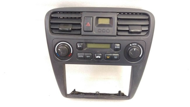

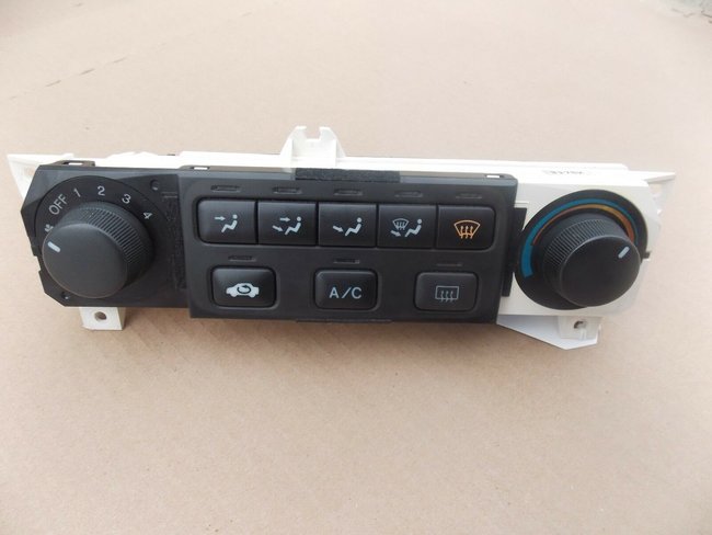

JACKHONDA00
I know my climate control module needs to be replaced on my 2000 Accord LX. The one I have now has all of the manual buttons up top. Can I replace it with the version that has a digital screen? See picts.
-3
Tuesday, October 15th, 2019 AT 6:18 PM
STEVE W.
  • 13,158 POSTS
Welcome to 2CarPros. The short answer is no. This is because the two controls use different internal programming and the body module would need to be re-programmed to make it work. That isn't something that can easily be done.
