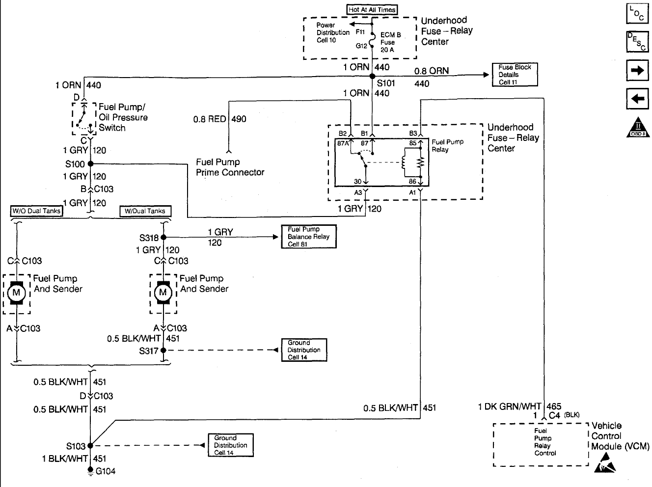

This should help.
You can usually get the pressure tester as a loaner tool at some parts stores.
A way to test around the relay is to find the fuel pump prime connector under the hood and jump it to the battery positive. That will turn on the pump and let you test it easier than needing to turn the key on/off all the time.
I suspect you will find the pump is losing pressure overnight. The issue then is to track down why.
One way to do that is with some vice grips or hose pinch pliers. You run the pump and then clamp off the return line and the feed line. Then watch the pressure.
If it holds steady and doesn't drop your problem is on the pump side. If the pressure drops off then it is on the engine side.

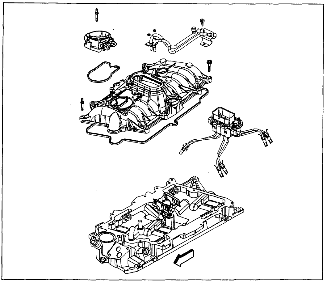

The biggest issue with that is that all of the trouble items are inside the intake manifold! The common issues are a bad pressure regulator, the "nut kit" AKA the fuel lines inside the intake and the poppet injectors themselves.
If you discover it is inside the engine, you can get a conversion kit that replaces the OE spider unit with a much better unit that uses real injectors and does not leak. It makes them start and run much better.

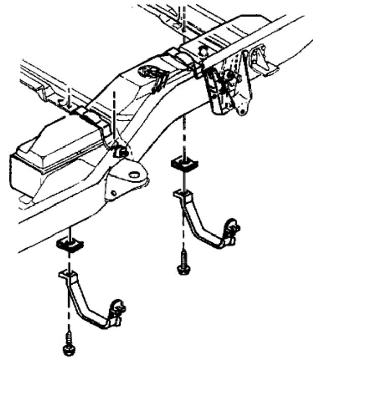

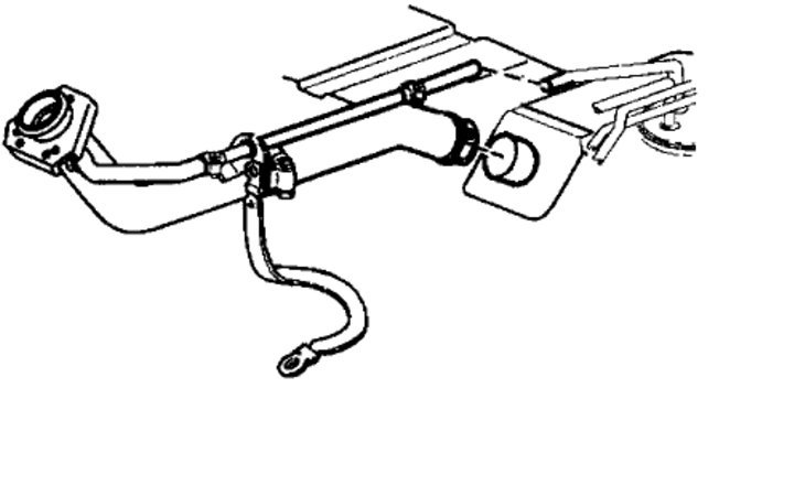

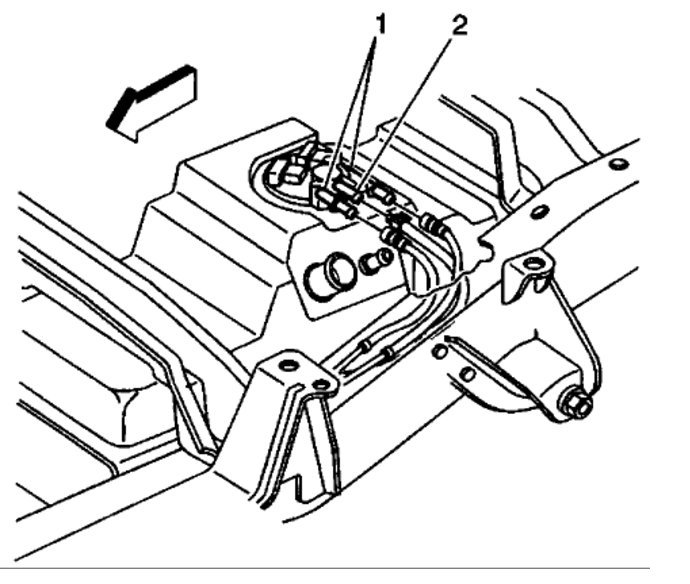

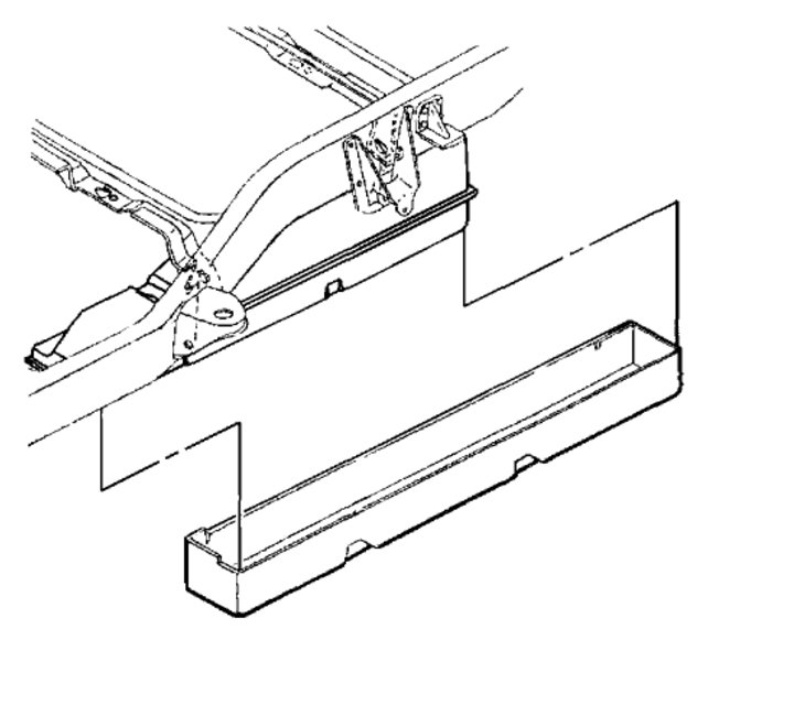

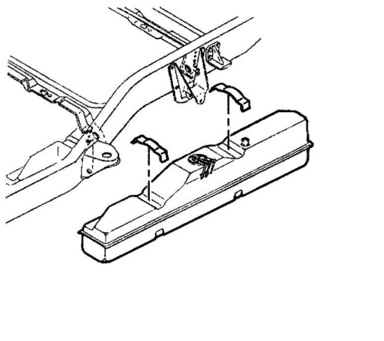

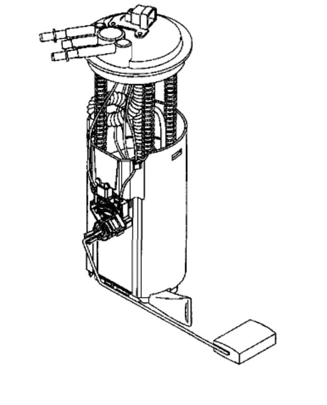

Here is a guide and some diagrams to help you get the job done.
This guide will give you an idea of how the job is done.
https://www.2carpros.com/articles/how-to-replace-an-electric-fuel-pump
You will need to raise the car safely,
How to drain the gas.
https://youtu.be/Q5MH2gnyFH0

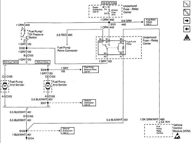

Here are the diagrams (below).
Saturday, June 5th, 2021 AT 2:51 PM

Good to hear. Pull the relay out and look inside at the terminals in the socket. You are looking to see if there is corrosion or melting. If it is corrosion spray some contact cleaner in there and plug the relay in/out a few times. Then apply a dab of dielectric grease to the terminals. That should stop it from corroding any farther.
+1
COREY H JENKINS
  • 80 POSTS
No corrosion but it does look like one of the prong slots has some melting. Should I do what you said for corrosion or something else?
STEVE W.
  • 13,118 POSTS
Melting is a common issue with them. What happens is the pump starts to draw more current as it ages. The extra current creates heat. That heat makes the contacts at the pump end and the relay lose some of their spring tension. The "loose" connection makes it worse and they heat up more. The heat builds until the connector melts.
Normally I pull the fuse/relay box and replace that connector. Or if it's melted real bad I'll just add a new relay outside the box. If the melting is VERY slight I have also used a fine pick to pull the spring piece of the contact in to make it tighter.
