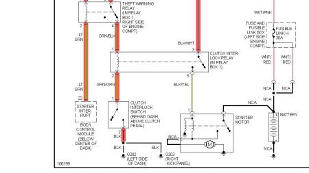

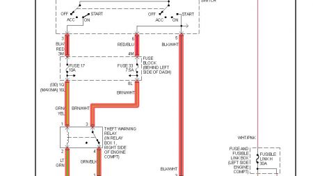

When I try to start the car the dashboard all lights up and the radio comes on but the engine wont crank over. I keep trying to do this for about thirty minutes, eventually it will crank over and it starts right up.
I have tried a new battery a new starter/anti-theft relay. I have a temporary solution and if I disconnect the battery before I go inside, and reconnect it before I am about to leave it will start on the first try.

It sounds like the start motor is no good. To be sure here is a guide to help you confirm the issue.

We used a starter tester and determined the starter wasn't the issue and so we started tracing everything through and found out it was the inhibitor/starter cut off relay. So we ordered a new relay and will keep you posted on if it fixes the issue. Thank you for the reply and the useful information!

Due to a defective door switch which causes false alarms I want to disable/disconnect the factory alarm system permanently
please direct me as to the... Wire to cut. The fuse to remove. Or the module to disconnect so as to achieve my goal without of course affecting and interfering with the starter in the vehicle.
Its an 18 yr old car.I don't want to spend a dime or any time and effort on the alarm system. The vehicle has also had some strange starter issues which have persisted even after several starter replacements and i'm trying to take the alarm out of the equation entirely.I know that all the security system really has is a starter interrupt which I believe works through a relay marked "inhibit clutch interlock" if you cant tell me how to disable it entirely how about just the starter interrupt part of it

Ok but just to get this out of my head. The alarm system starter kill relay is closed when the alarm is not triggered correct? So it probably couldnt be a factor as regards this starter issue right?
If that is the case would you check to see if different types of starters were used on the maxima for the 1995 model year. The car will start but once its been running for awhile and shut off it will not restart until it sets for some time then the cycle repeats. The engine has a lurching sound as it is cranked over as if the engine is in vapor lock but I know that it is not. Ive swapped the starter several times because they seem to heat up and fail. Im wondering if its the tooth engagement to the flywheel causing the lurching sound? They keep giving me the same starter as a replacement

When the alarm is not going off or set the starter disable should be closed correct. Also when it wont start does the starter work at all?Because you mentioned teeth engagement then were talking about it cools it starts so kinda confusing. Also if its a matter of the starter inop then you could even have a bad neutral safety switch getting hot and becoming inop.

No it doesnt crank over at normal speed but I think I have the solution.I bought and returned several starters from auto zone and o reillys because they failed.I talked to napa and they said there are 2 different starters."8 tooth and one other" I put that one on and it appears to work fine. Incorrect tooth engagement seemed to be the problem
