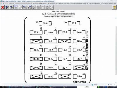

1994 GMC Jimmy fuel pump fuse
HOFMANN2
MEMBER
1994 GMC JIMMY
Electrical problem
1994 GMC Jimmy 6 cyl Four Wheel Drive Automatic 175.00 miles
were can U find this fuse under the hood or in side car.
Wednesday, February 6th, 2008 AT 10:11 AM
MERLIN2021
MECHANIC
17,250 POSTS
#9 ECM Batt 15 amp Engine computer (Battery) ABS Battery, Fuel Pump.
In car.
