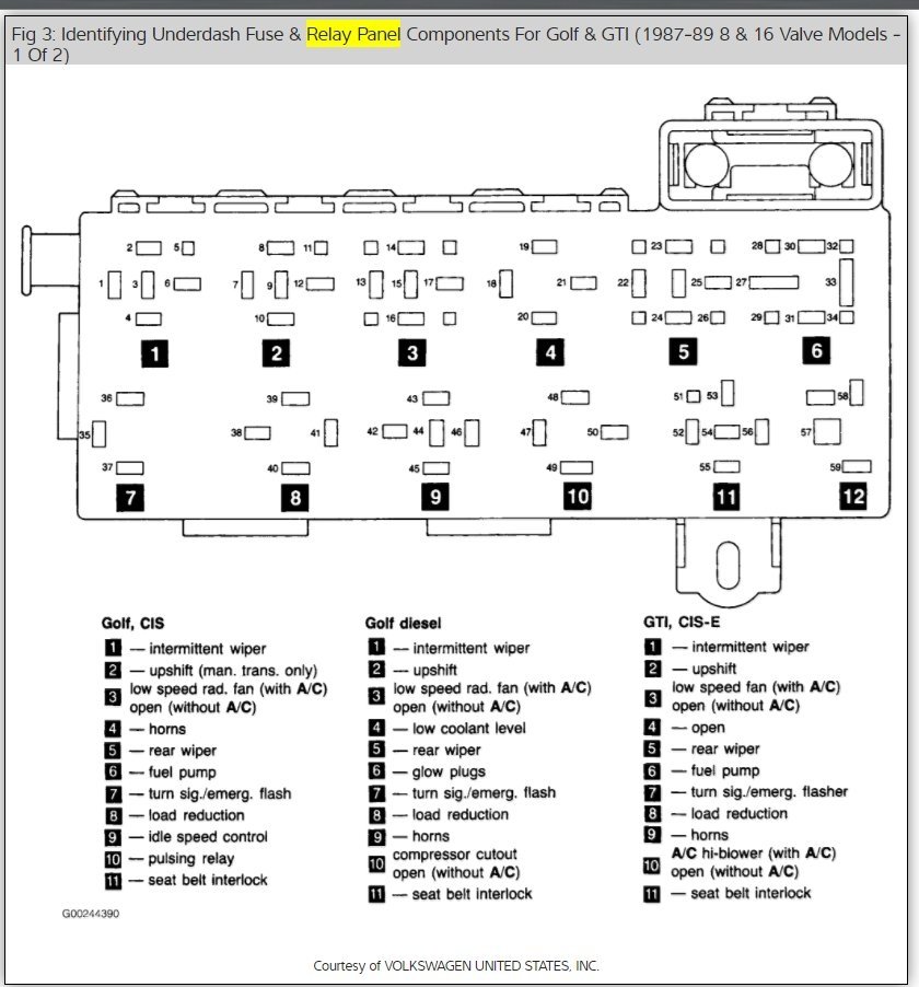

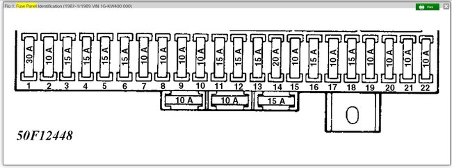

I need help I am trying to connect some wires that I noticed were disconnected from the fuse box. I have a few missing fuses, but I do not know where wires belong or what fuse goes where.

I have found this fuse box diagram (below) for you which should help you get the problem fixed.

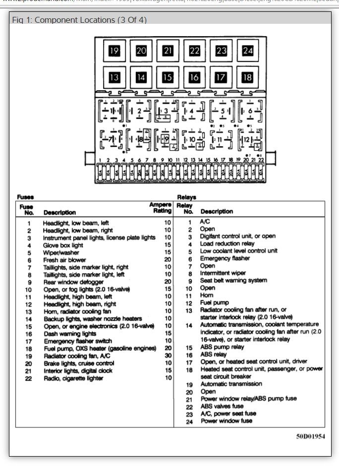

My son took the fuse box apart & I have no idea now where everything goes. Please Help!

MHPAUTOS
  • 31,937 POSTS
Hi there,
Fuse box layout as per pic.
Mark (mhpautos)
https://www.2carpros.com/forum/automotive_pictures/61395_Graphic_11.jpg
Tuesday, July 14th, 2020 AT 12:19 PM (Merged)

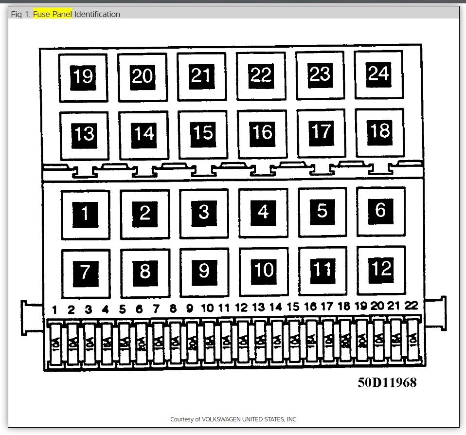

Jetta2 cli fuse box diagram

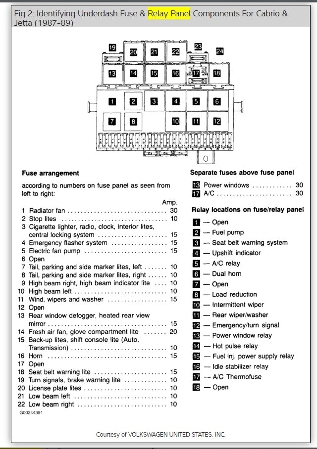

I found the complete fuse box guide for you with diagrams (BELOW)
1 - 10 Amp Left Headlight Low Beam
2 - 10 Amp Right Headlight Low Beam
3 - 10 Amp Instrument & License Lights
4 - 15 Amp Rear Window Wiper, Glove Box Light
5 - 15 Amp Windshield Wiper/Washer
6 - 20 Amp A/C, Fresh Air Fan (16-Valve)
7 - 10 Amp Right Taillight & Side Marker Light
8 - 10 Amp Left Taillight & Side Marker Light
9 - 20 Amp Rear Window Defogger
10 - 15 Amp Fog Lights (2.0 16-Valve Only)
11 - 10 Amp Left Headlight High Beam & High Beam Indicator Light
12 - 10 Amp Right Headlight High Beam
13 - 10 Amp Horn, Radiator Cooling Fan (16-Valve)
14 - 10 Amp Backup Lights, Washer Nozzle Heaters
15 - 10 Amp 2.0 16-Valve Only: Engine Electronics, Stabilizer Valve, Cold Start Valve
16 - 15 Amp Instrument Panel Warning Lights, Multi Function Indicator (16-Valve)
17 - 10 Amp Emergency Flasher, Turn Signals
18 - 20 Amp Fuel Pump, Oxygen Sensor
19 - 30 Amp A/C, Radiator Cooling Fan
20 - 10 Amp Brakelights, Cruise Control
21 - 15 Amp Interior Lights, Digital Clock, 16 Valve: Luggage Compartment Light, Central Locking System, Multi-Function Indicator
22 - 10 Amp Radio, Cigarette Lighter
and
