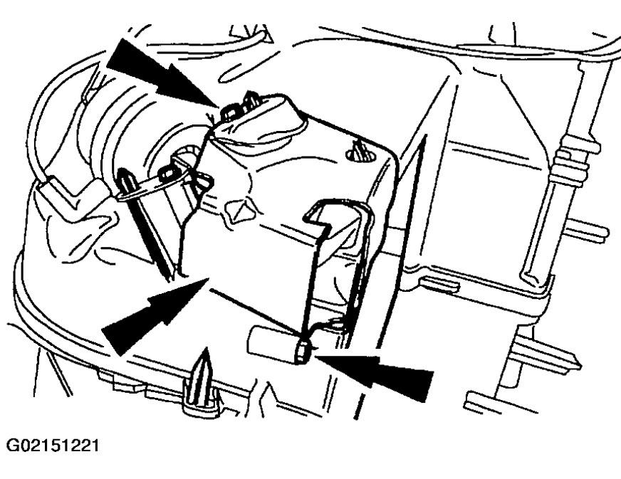

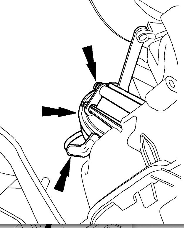

Replaced actuator, found broken small vacuum line under hood and glove box, spliced and repaired. Air conditioner still blowing from defrost. I do not know where to go from here.
Tuesday, June 22nd, 2021 AT 11:00 AM (Merged)
HMAC300
  • 48,600 POSTS
See if vacuum is going to motor in picture. It can be reached through driver's foot well. If it is the vacuum motor is bad, if not check for a vacuum leak at heater switch it may be leaking there.

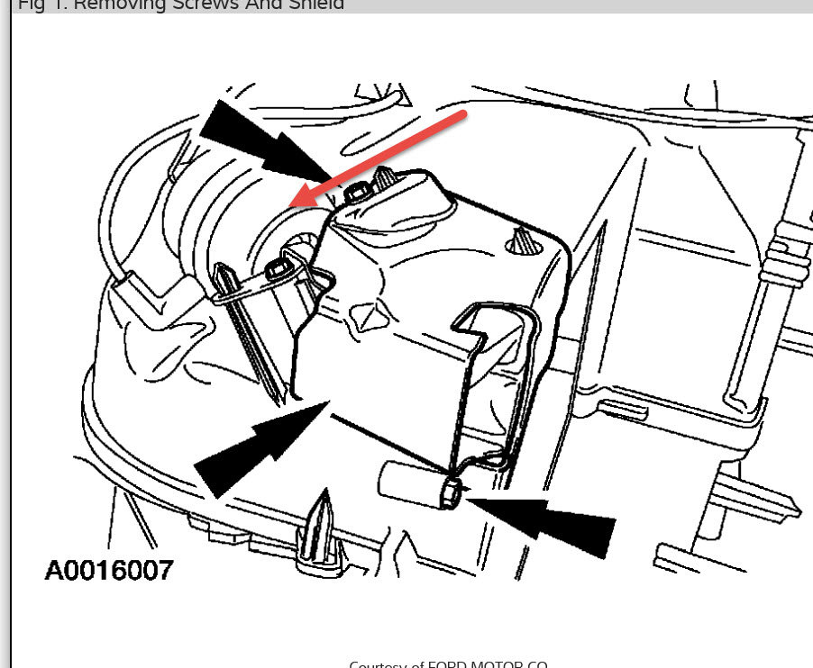

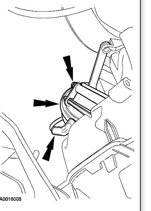

No leak at heater switch, it appears to be no leak under the hood. I need a better picture of what the vacuum motor looks like. Pulled the radio again and new actuator is doing what it is supposed to be doing. Question? If blend door is opening when turn controls from hot/cold, will it be quiet? I am to the point where I feel that I am going to have to sell a grandchild to get it fixed. Air is blowing cold, just need it to blow at me instead of front windshield. Perplexed in Houston, TX.
HMAC300
  • 48,600 POSTS
The red arrow in picture shows what this looks like this is accessed through driver's foot-well. That means by the gas pedal. There is a shield that other arrows point to so it can be removed.
+1
YOGIBEAR10
  • 5 POSTS
Finally! The simplest thing, I retraced my steps & checked everything I had done. The problem was the tiny black hose was connected to the wrong valve behind the glovebox, now have AC Blowing out the dash. Replies very much appreciated.

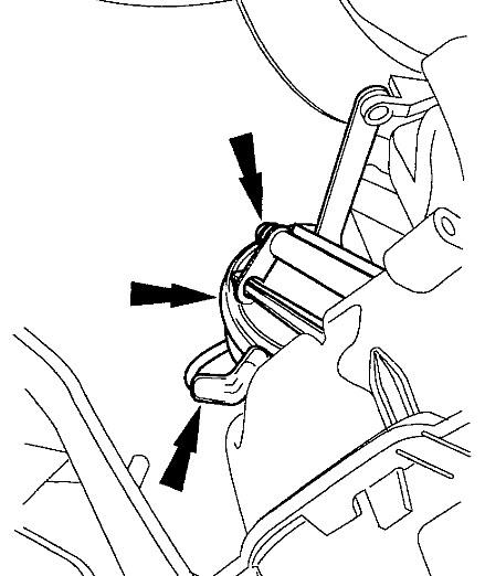

My air conditioner only blows out air from the defroster and floor and not the front vents.
Tuesday, June 22nd, 2021 AT 11:04 AM (Merged)
HMAC300
  • 48,600 POSTS
Check for a vacuum leak to the panel/vacuum motor it is accessed through drivers footwell, see picture. If motor gets vacuum when set on dash then the motor is bad, if no vacuum it may leak at control.

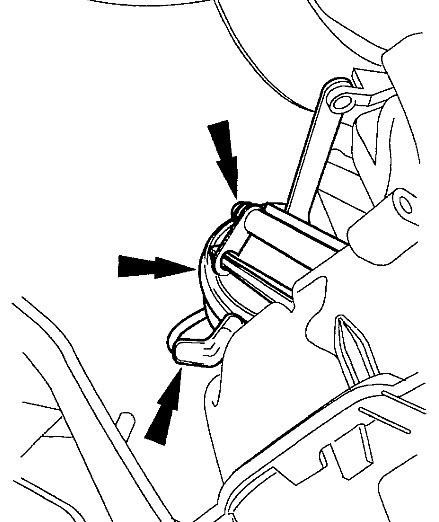

Cold air blows out top vent but not front vents
HMAC300
  • 48,600 POSTS
Check for a vacuum leak the mode door is the problem it may not be getting vacuum or the control Is leaking vacuum and not sending to mode door. See pics it's accessed from drivers side footwell
