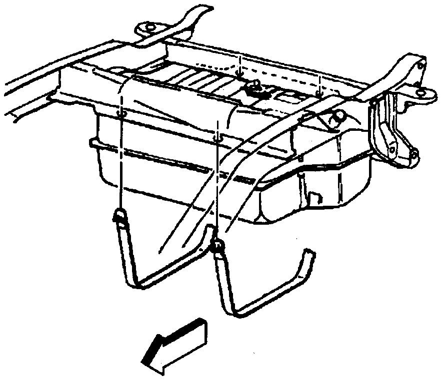

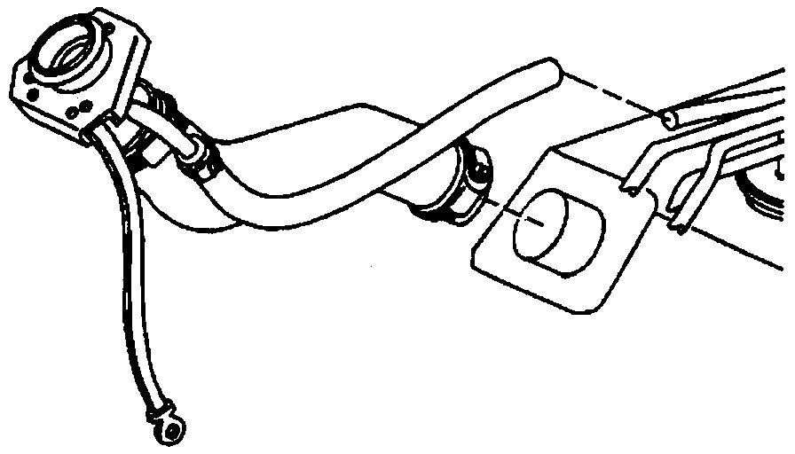

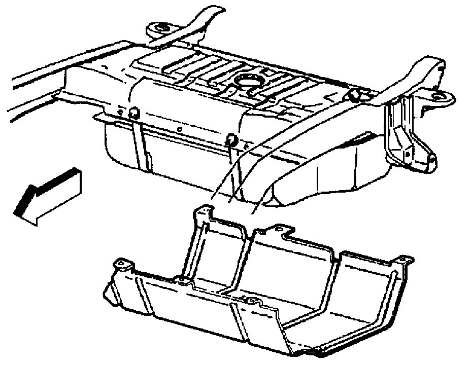

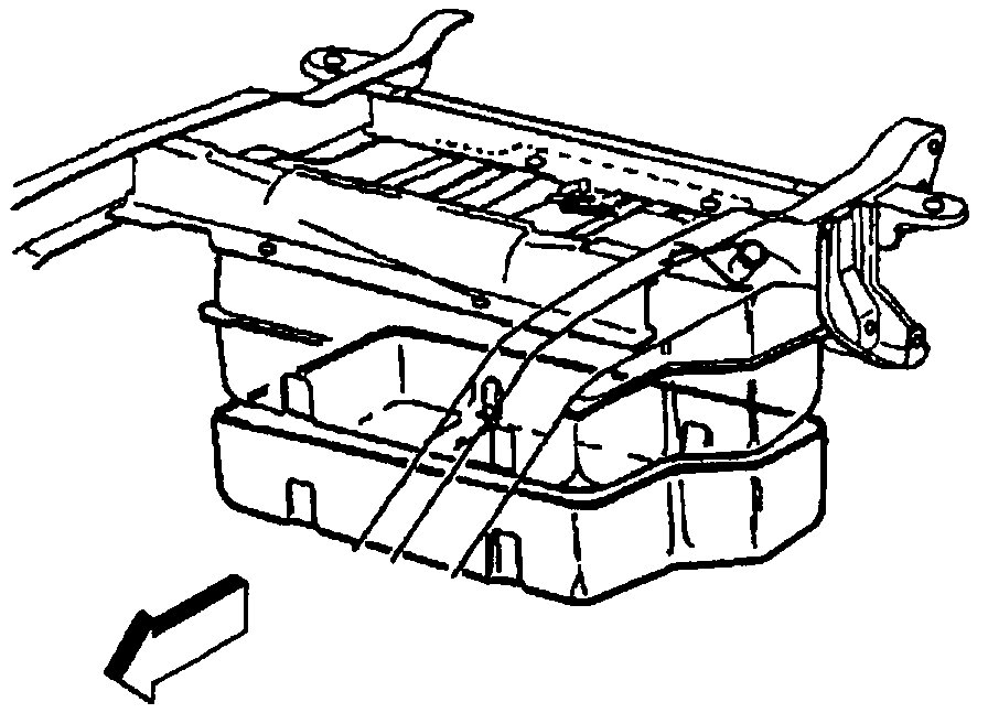

My vehicle will start with starting fluid and run with sufficient starting fluid and then shuts off when the starting fluid used up. There is also a fuel line pressure leak I believe because after I attempted to start the engine it cranks and then the fuel line or something right by the fuel tank is bleeding off gas after the attempted start?

If it is leaking, that is why it won't run. The pressure is being lost. You need to remove the fuel tank to determine which line is leaking.
Here are the directions for removing the tank. The attached pics correlate with the directions.

Removal Procedure
1. Drain the fuel from the tank. Refer to Draining Fuel Tank.
2. Raise the vehicle.
3. Remove the fuel tank off-road shield, if equipped.
4. Loosen the filler neck hose clamp at the fuel tank and disconnect the fuel tank filler neck from the fuel tank.
5. Support the fuel tank and remove the tank straps and insulator strips, if equipped.
6. Lower fuel tank shield.
7. Lower the fuel tank. Disconnect the fuel feed and vapor hoses. Disconnect the electrical connections at the sender.
8. Remove the fuel sender assembly and seal ring, using tool J 39765. Discard the old seal ring. Purge the tank, if the tank is being repaired.
