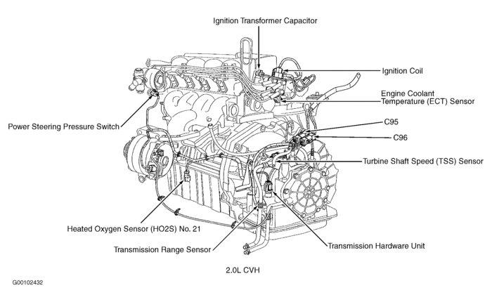

Where is the coolant temperature sensor located?
Monday, June 1st, 2020 AT 9:39 AM (Merged)
SCHRIMPIEMAN
  • 166 POSTS
. Near water outlet. Follow upper radiator hose as it snakes its way under the intake plenum. Sensor is either located on the water outlet itself (some models) or on the engine block/head near the water outlet.
Easiest (Hmmmph.) Way to access it is to remove the passenger side headlight assembly. The headlight assembly is just a chore to take off; Just when you think you have the easy screws dismounted from the top, there's a "hidden" 10mm bolt behind the moulded bumper which can only be accessed from underneath.
. Enjoy.

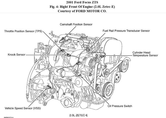

I have a ford focus from the year 2001 and have noticed that the coolant temperature sensor is not working anymore, but as much as I look I cant find where it is located and if I find it, I need to know step by step how to change it, please help
IMPALASS
  • 3,112 POSTS
Hello - I need to know the exact model and size of your engine in liter. What I have given you is for a Ford Focus LX 2.0L. There are no procedures for this. Disconnect the electrical plug and using a wrench unscrew. Install new one.
