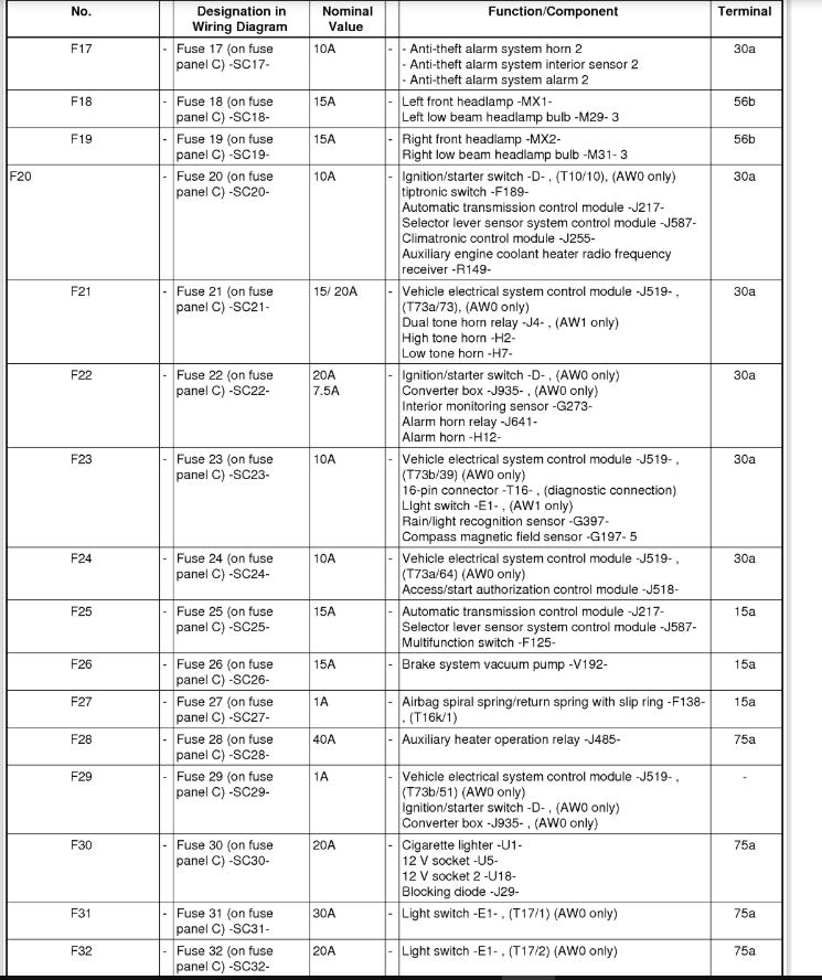

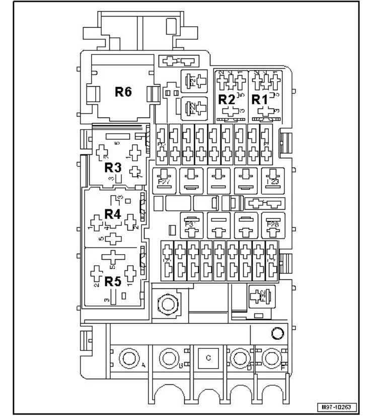

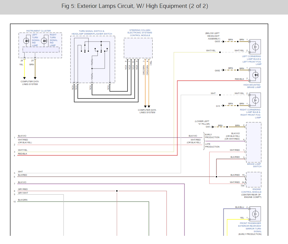

My left tail light went out the other day, so I went to advanced auto parts and purchased a replacement. The replacement light bulb was installed successfully, but once I turned the lights on - it still was not working. The brake lights work fine, just not the left tail light. I am not sure if this is a fuse issue or some type of socket or wiring issue. Ive tried to find fuse diagrams online to see if I could find the fuse for the tail lights to check to see if this was a fuse issue - but there is no information out there. Does anyone know if this is a fuse issue or if this is a different problem Thanks.

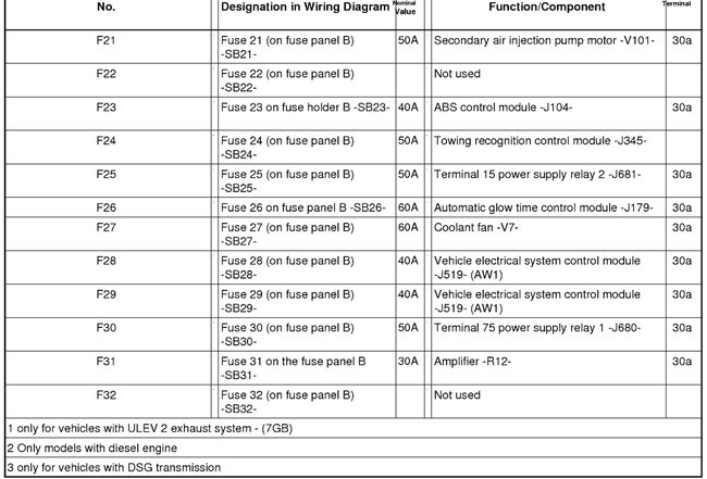

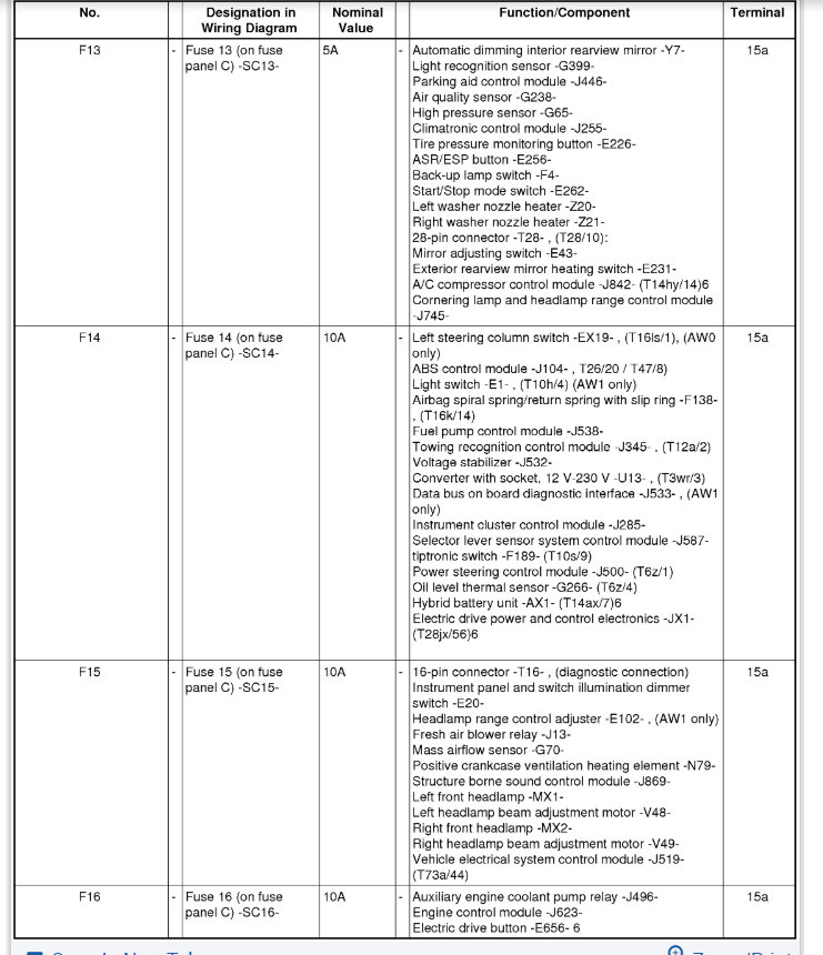

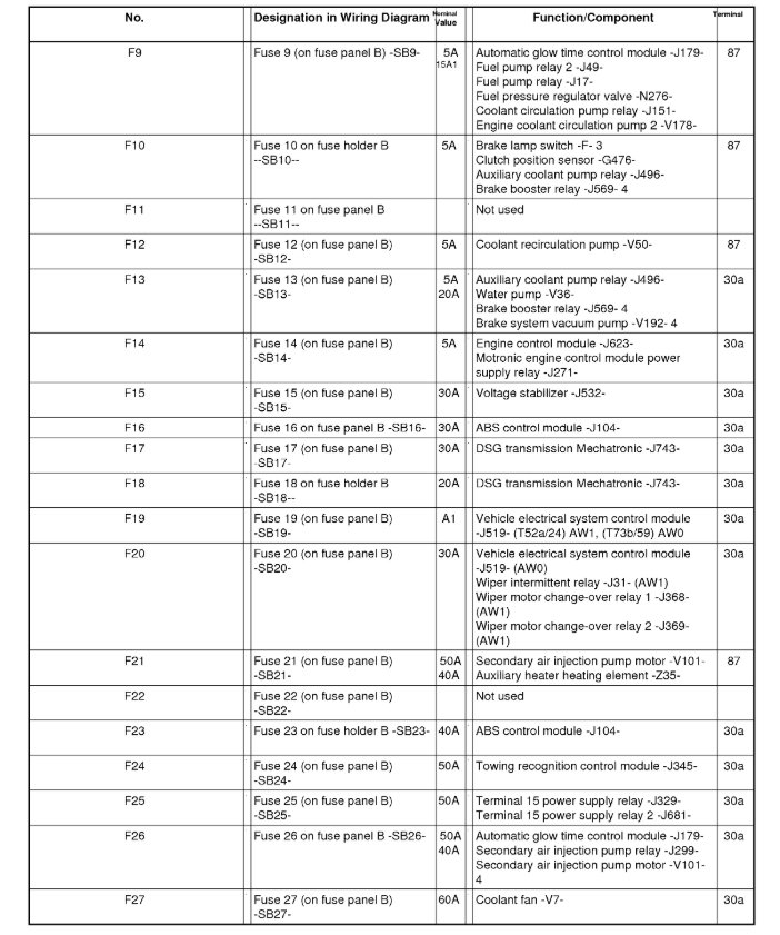

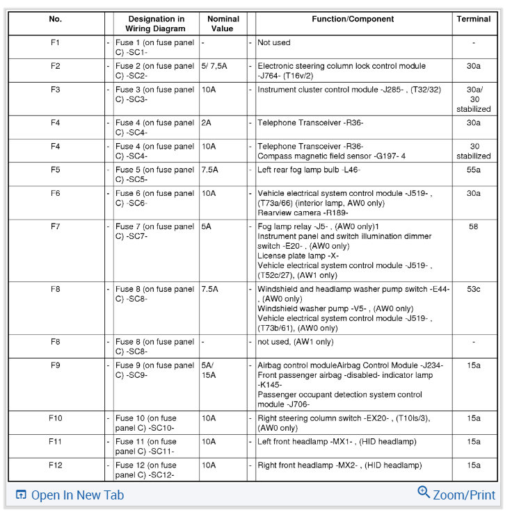

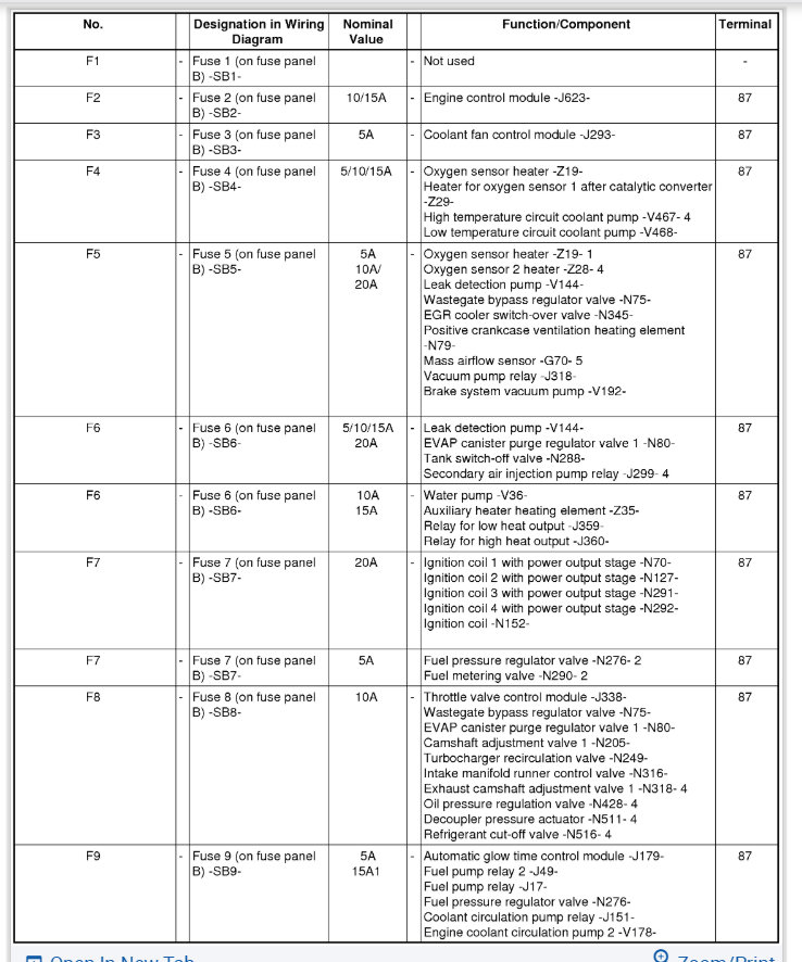

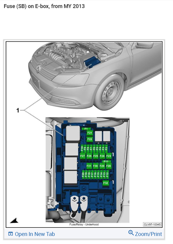

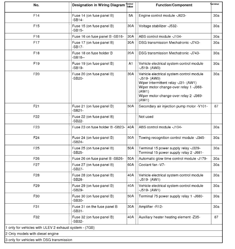

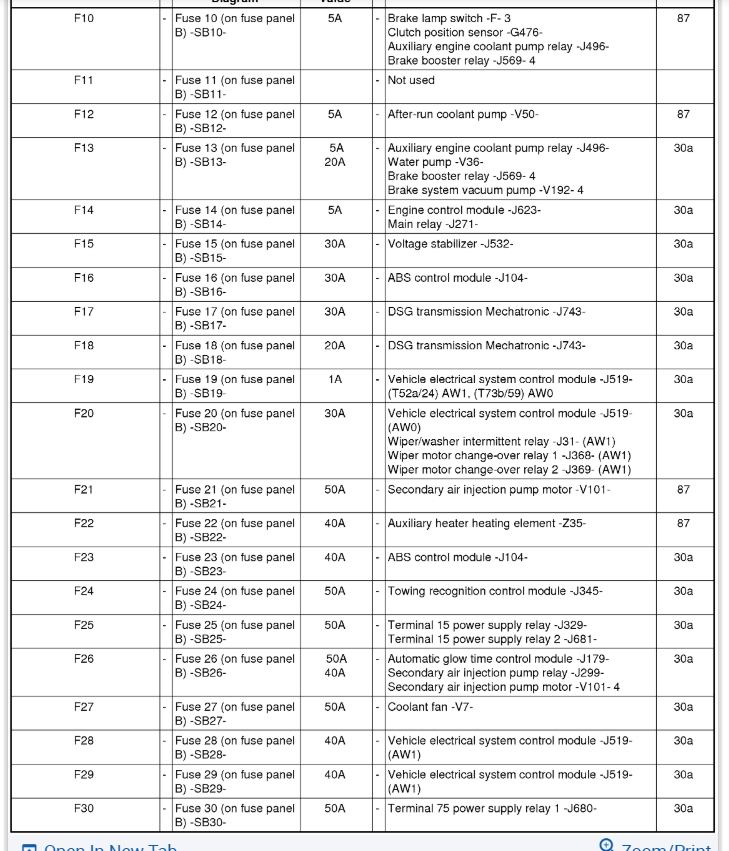

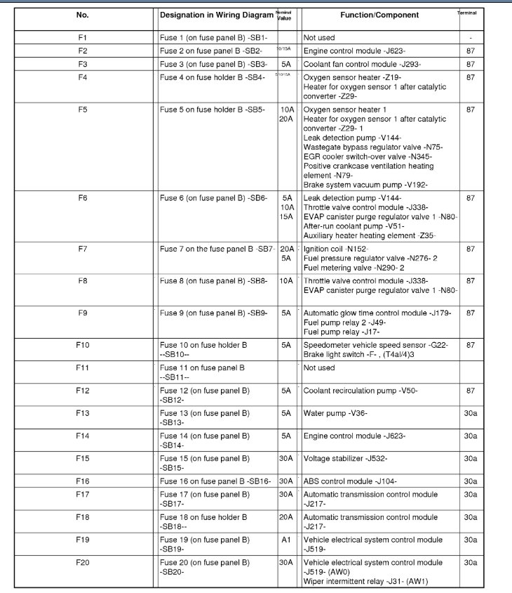

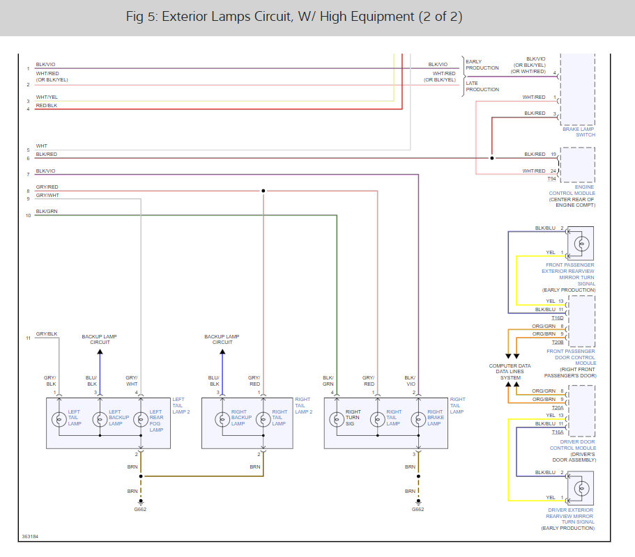

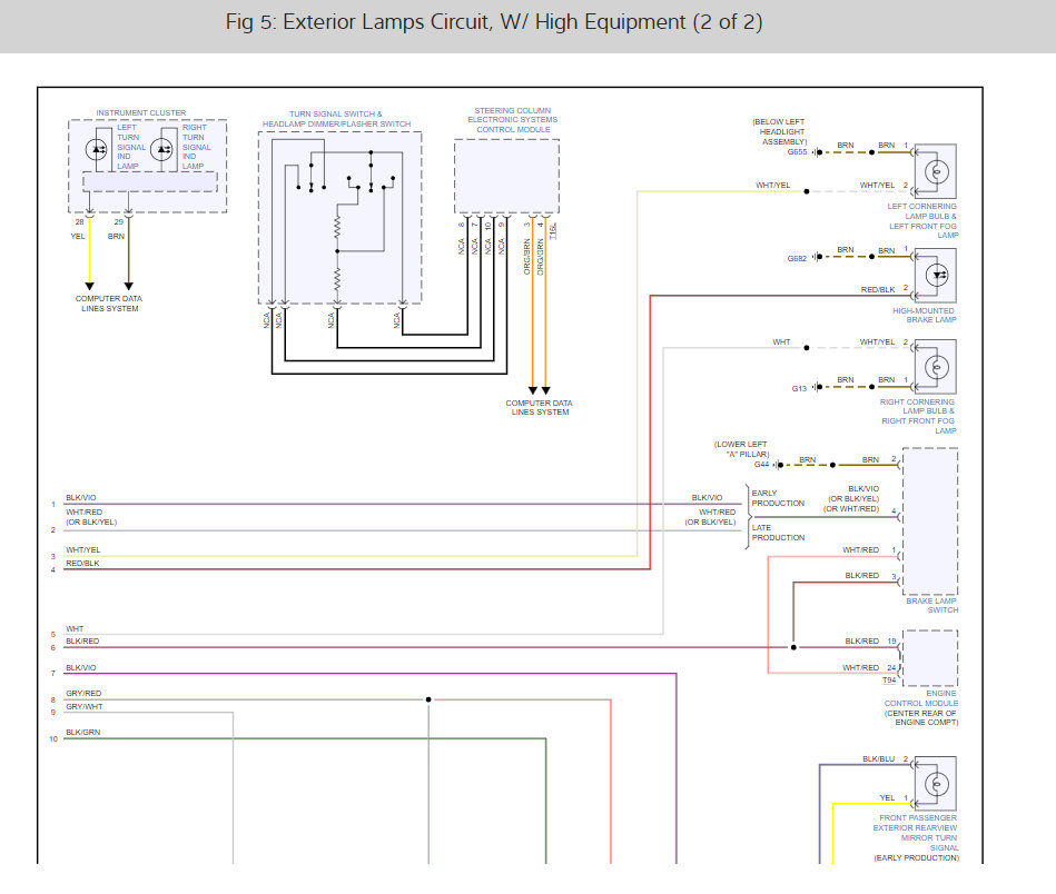

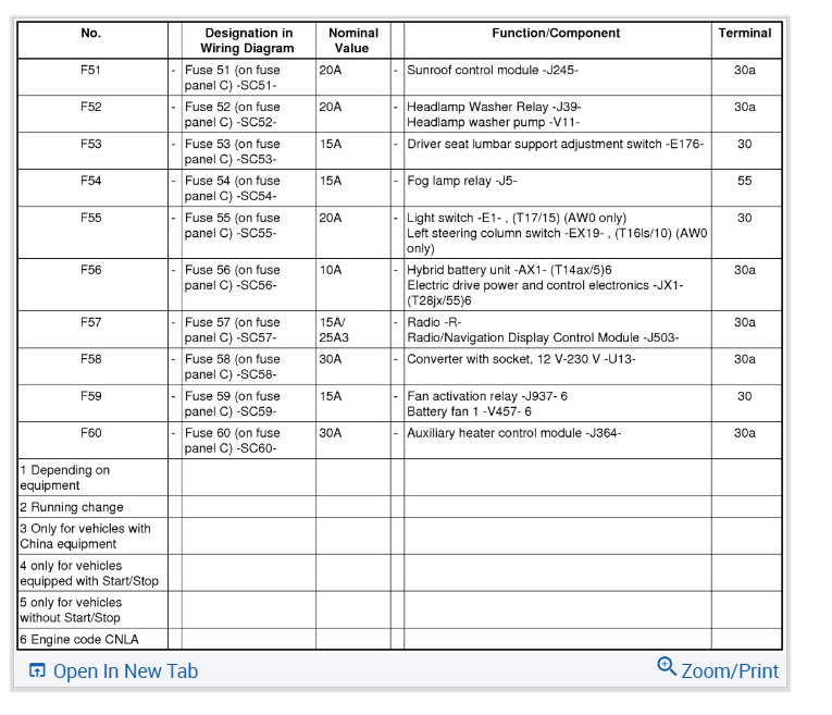

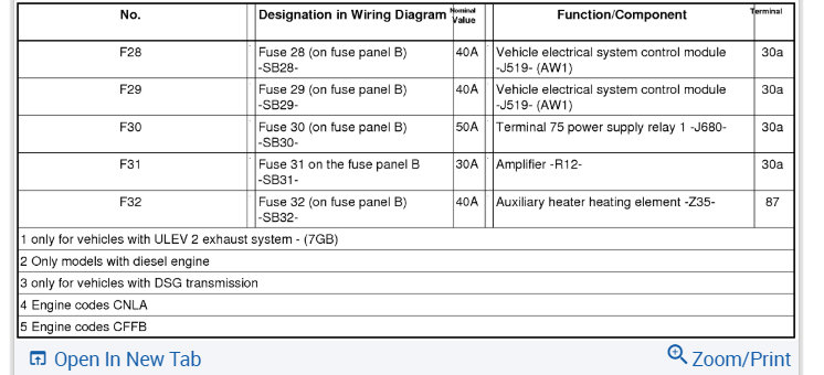

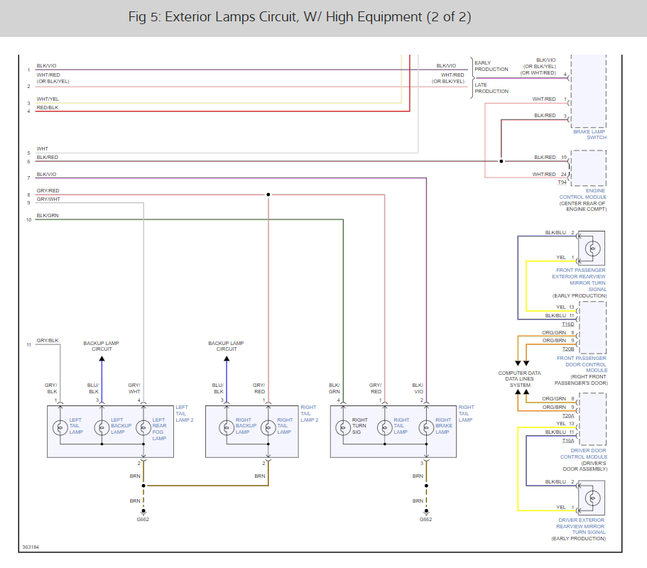

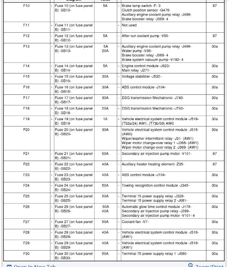

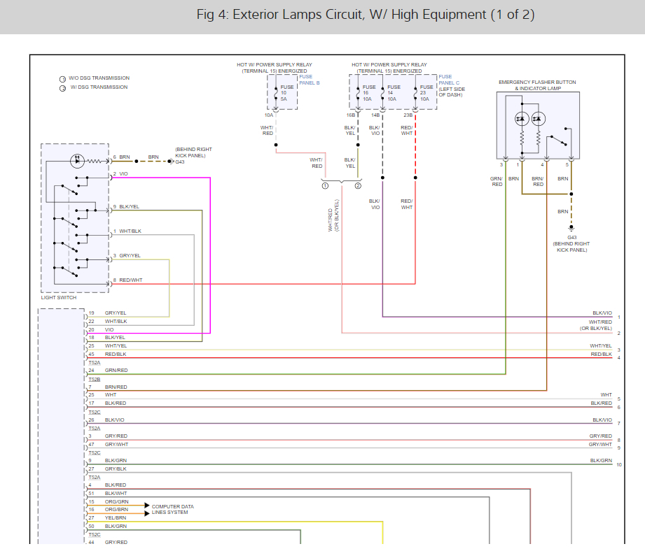

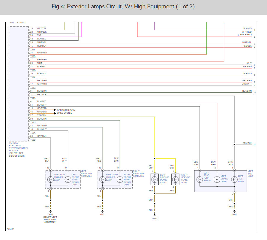

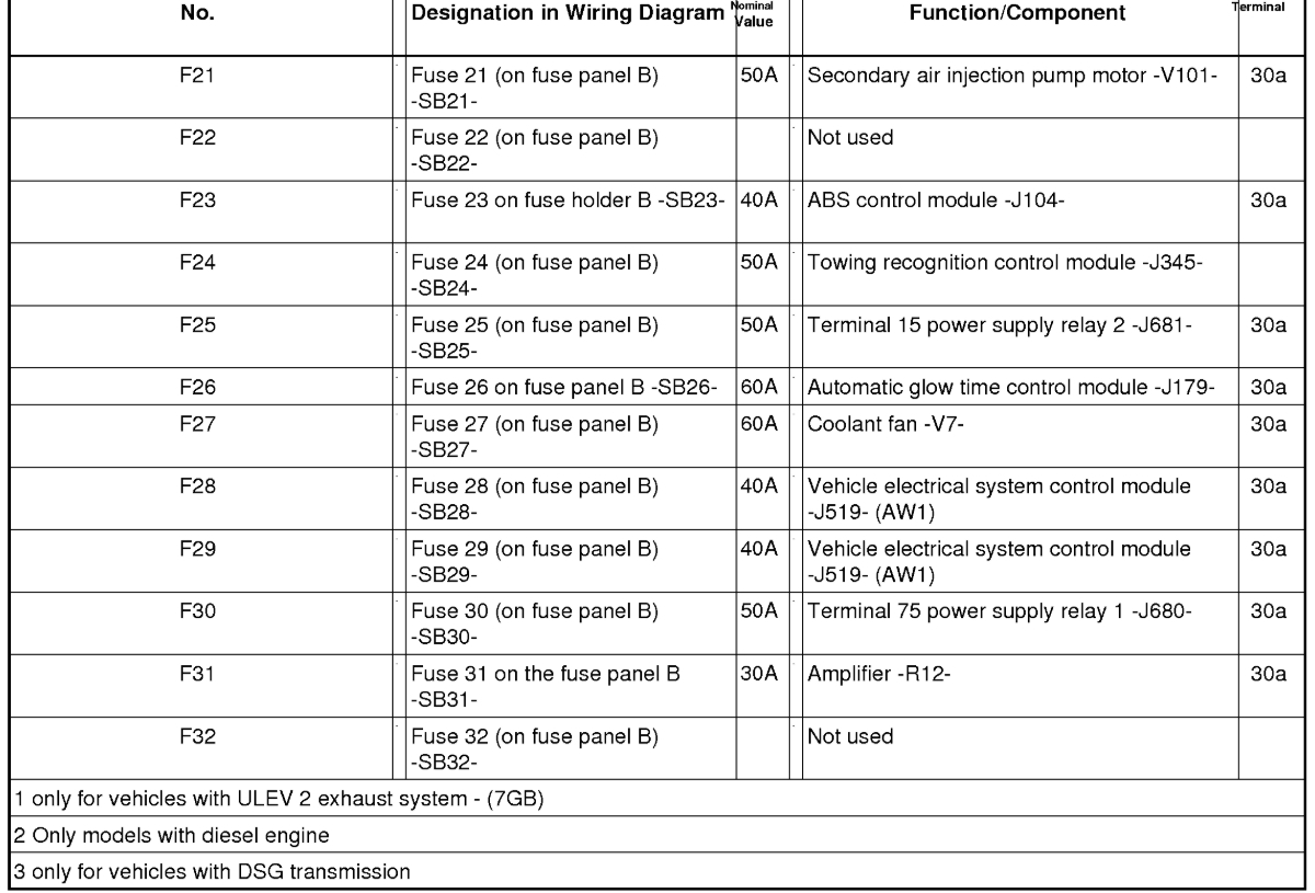

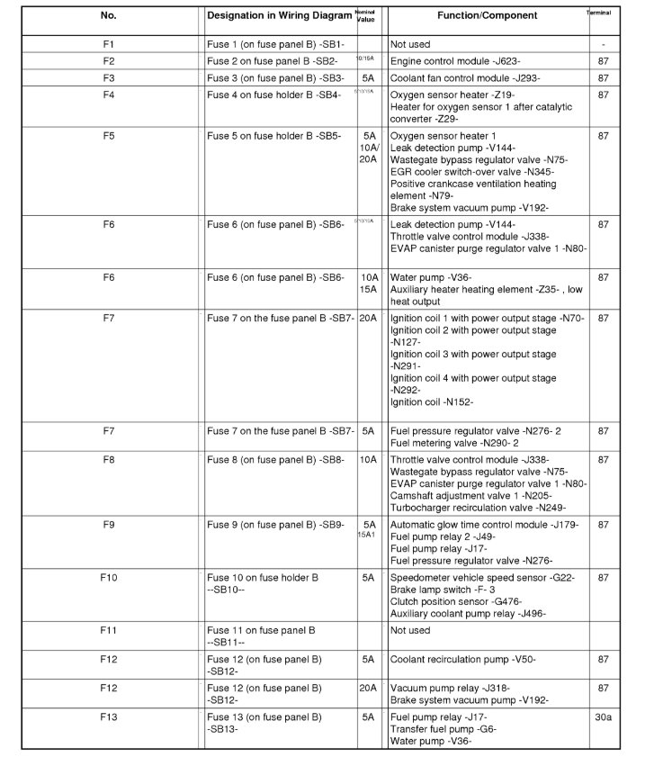

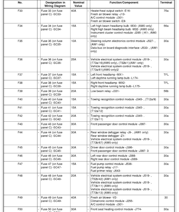

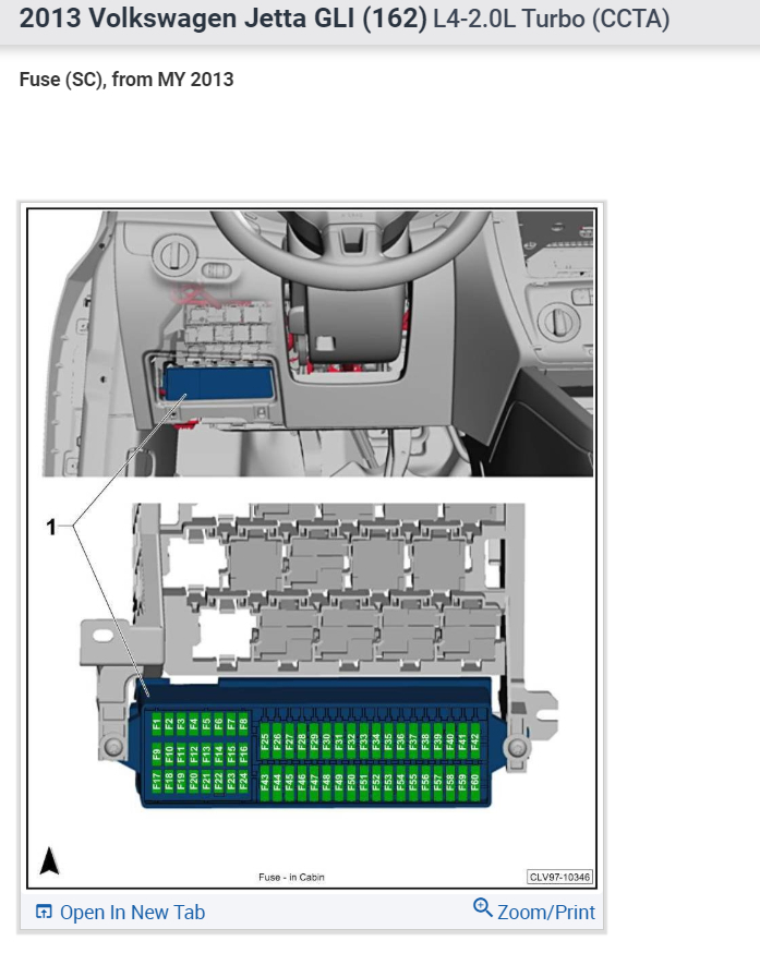

It could be a fuse or the bulb connection, here is the wiring diagrams so you can see how the system works with a guide to help test the bulb for power to see if it is a socket problem and a guide to help check the fuses, the fuse locations are in the diagrams below.
and
https://www.2carpros.com/articles/no-tail-lights-exterior-running-lights-tail-lights-out
Check out the diagrams (Below). Please let us know what you find. We are interested to see what it is.

Thanks for the guides and fuse diagrams, I checked the fuses they were okay I found the socket had got wet and corrosion covered one of the terminals, all fixed now what a great site this is :)
