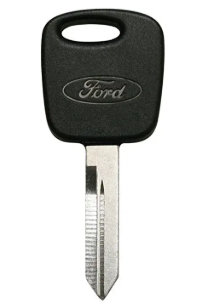

Engine will turn over (cranks), but will not start (run). It has randomly started once or twice. I have good fuel pressure. Changed both the crank and cam sensors. Upon connecting my scan tool it will scan all modules by itself, and the only code it shows is P1000. Incomplete monitoring more or less. Now when I self test the modules by their self I get one DTC that I cannot clear, B1845, ignition tamper CKT fail in the Central Security module. When I run a live data stream I have a "IGNTAMSEN" that shows out of range. I would think the two related. I am unsure what exactly IGNTAMSEN is and its location. Also, I would think the "theft" light would be flashing with those two items and the theft light does not. I have also programmed two new keys to the truck after it quit running. Further information: I have No injector pulse or spark. The cop's have power to them but no GND pulse. Theft light comes on when key is turned to run. Goes out after 3 seconds and stays out. Flashes every 2 seconds when key is off. Any ideas or direction to go with would be great.

The keys that you are using, are they actual Ford keys with the Ford Logo on them?
This seems like it is the key issue. Basically it is not in theft mode which is why the theft light is operating normally. It doesn't enter theft mode when an incorrect key or (improperly programmed key) is inserted. It just doesn't allow the start and sets the B code that you are getting.
I have seen this exact issue a number of times when using a Walmart key or some other OEM. The Central Security Module does not like anything but OEM Ford keys. I would suggest getting one from Ford or atleast one that is a known OEM key and seeing what happens. Because the no spark and no fuel is the PCM not allowing the pulse or spark due to the key not being good. This doesn't mean you programmed it wrong, but if it is an aftermarket key then it is just a product that the module doesn't recognize.
