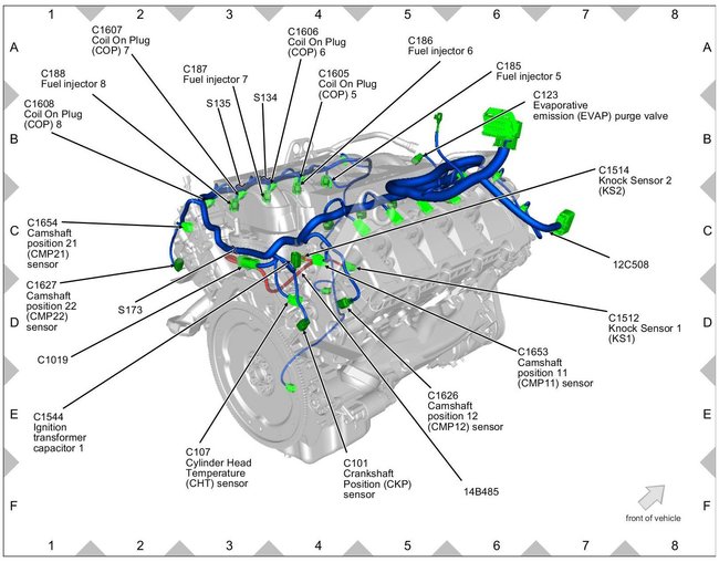

Coolant temperature sensor location needed please?
MICHAEL PARKER2
  • 2014 FORD F-150
  • 5.0L
  • V8
  • 2WD
  • 43,000 MILES

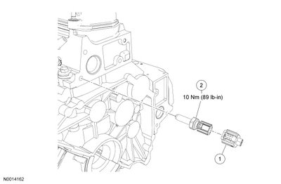

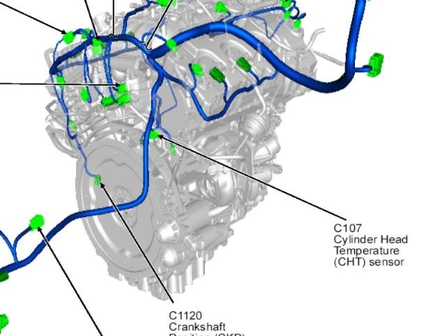

A rodent got into my engine bay and ate some of my insulation but also appears to have eaten through the wiring to the engine temperature sensor. I cannot find where it is located on my engine to check the wiring.
+1
Friday, May 7th, 2021 AT 11:18 AM (Merged)
STEVE W.
  • 13,167 POSTS
The sensor is back at the engine/bell housing split. Mounted to the passenger side cylinder head on the inner rear of the head. Item C107 in the picture.

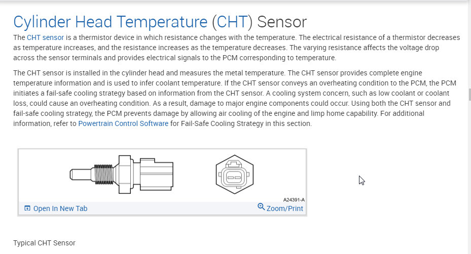

Where is the engine coolant sensor located?
STEVE W.
  • 13,167 POSTS
Ford doesn't use a conventional style coolant temperature sensor, they use a cylinder head temperature sender. It is on the rear of the engine on the right side above the bell-housing flange on the 5.0 engine. What is the issue you are having?

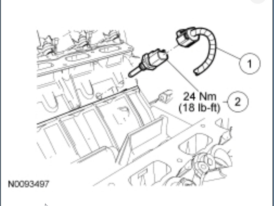

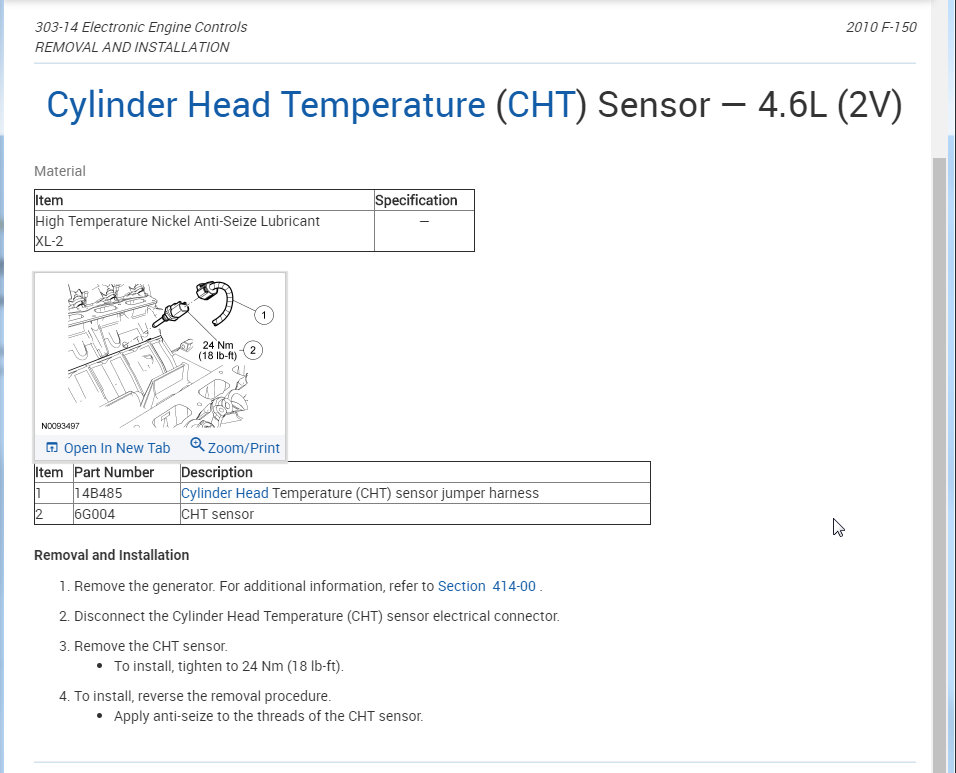

Looking for location of coolant temperature sensor.
This is a pretty common question for these engines. You have what is called a cylinder head temperature sensor. Exact same thing as an engine coolant temperature sensor, it is just in the cylinder head. Now the unfortunate part, it is under the intake manifold. If you take a look at the picture you will see the intake ports are exposed in order to access it.
Let me know if you need more info. Thanks

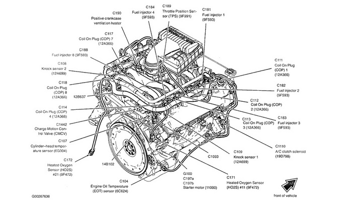

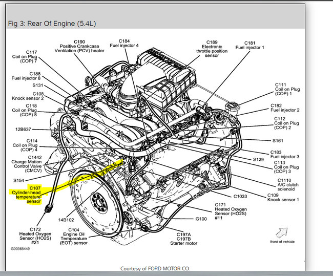

Trying to locate the coolant temperature sensor.
SCGRANTURISMO
  • 4,897 POSTS
The information that you requested is in the diagrams down below. It is located on the top rear of the engine.

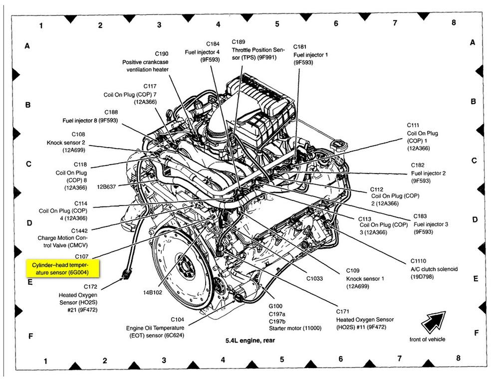

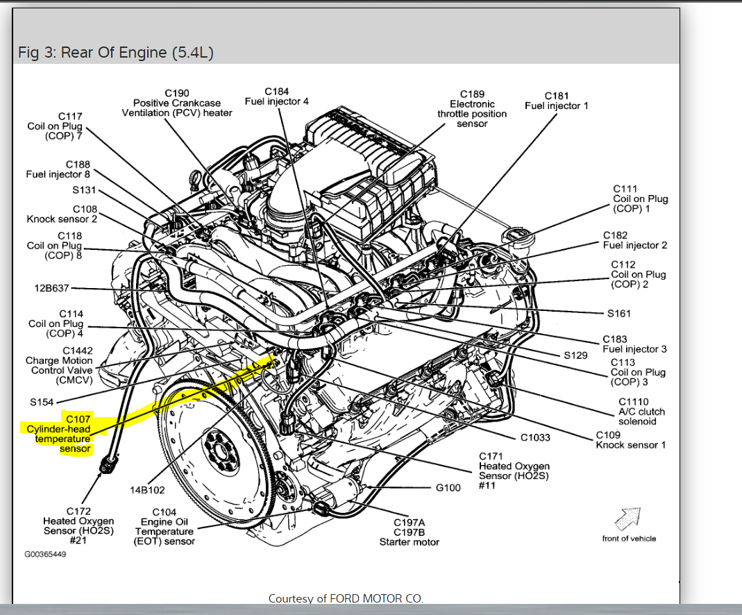

Where is a coolant temperature sensor located on a Ford F-150?
Friday, May 7th, 2021 AT 11:19 AM (Merged)
JDL
  • 16,098 POSTS
My info shows this for the 5.4L. Cylinder head temp sensor, back side of cylinder head on the passenger's side. Check out the diagrams (Below). Please let us know if you need anything else to get the problem fixed.

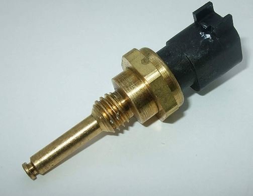

I located the cht sensor but can't find the temp sensor Ect thanks
OHYEA
  • 153 POSTS
Your engine doesnt have a traditional ECT(engine coolant temperature) sensor, instead it employs a cylinder head temperature(CHT) sensor.
