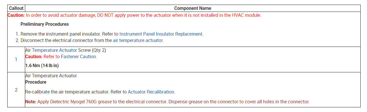

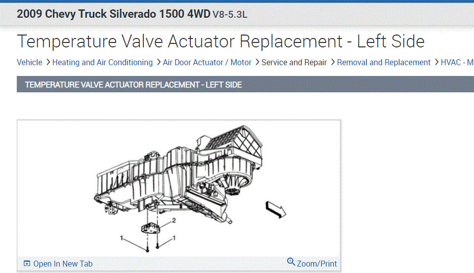

I noticed my driver side vents blowing hot so I replaced the blend door and nothing has changed. My driver side is unbearably hot while my passenger side is nice and cool.
Tuesday, May 25th, 2021 AT 11:42 AM (Merged)
  • 108,501 POSTS
Did you recalibrate the new actuator? It should be done with a scan tool, but can be done without.
Take a look at the first two pics below. They are the directions for replacement. I'm adding them so you can confirm nothing was missed.

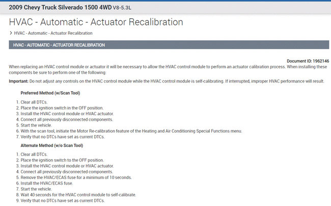

Pic 3 below is the recalibration directions.
Try that and let me know if it helps.
PATRICKBRUNO
Yes I have recalibrated every way the internet provides and it still blows hot
