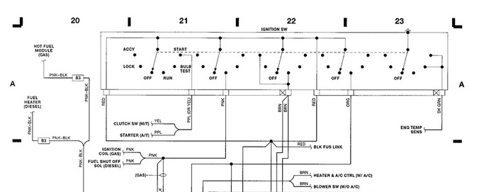

I replaced the coil that is outside of distributer. Where the coil wire goes.

How about the pink, use a voltmeter, should be hot/voltage with the key on.

You said you have no spark. Without at least a voltmeter or testlite, it's hard to do any testing.

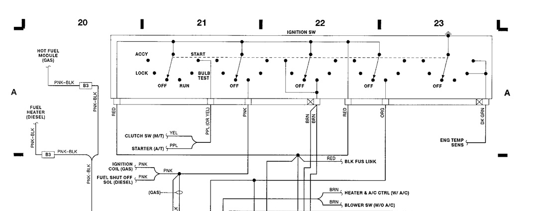

I just checked the pink wire coming out of the ignition module. My testlite did not light up with ignition ON
Monday, November 11th, 2019 AT 6:20 PM (Merged)
JDL
  • 16,098 POSTS
Then check feed to and from ignition switch. The pink wire to ignition coil is in the diagram, the feed comes from the ignition switch.
Follow pink wire under the hood, see if goes to an electrical connector, check voltage on both side of connector, key on. Might be a problem with ignition switch or wiring circuit?
