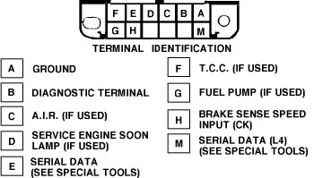

To extract a trouble from the computer for diagnostic purposes, the Assembly Line Communication Link (ALDL) connector is used.
Ground terminals A and B with the ignition "ON" and engine not running. The system will enter the diagnostic mode. In this mode, the computer will display a 12, three consecutive times, by flashing the "CHECK ENGINE", "SERVICE ENGINE SOON" or "MALFUNCTION INDICATOR LAMP" or light. A 12 consists of one flash, a short pause, then two flashes in rapid succession.
After 12 is displayed, any stored trouble s will be displayed by flashing the "CHECK ENGINE", "SERVICE ENGINE SOON" or "MALFUNCTION INDICATOR LAMP" light. All s are displayed 3 times each then a 12 will repeat. In the diagnostic mode, the computer will also energize all computer controlled relays and solenoids.
![https://www.2carpros.com/images/question_images/199296/original.jpg](https://www.2carpros.com/images/question_images/199296/original.jpg)
ALDL Connector (Located Underdash)
Image (Click to make bigger)
