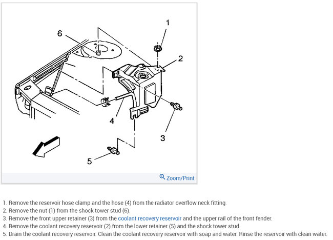

DOCFIXIT
  • 18,828 POSTS
There is a sensor in the coolant recovery tank that has gone bad you may need to replace the tank as a unit ehre is a guide to help you see what you are in for when doing the job.

JDL
  • 16,098 POSTS
That sensor should be mounted in the radiator? When you removed the old radiator, did you unplug an electrical connector? The new radiator probably has a plug in the threads, where the sensor goes.
