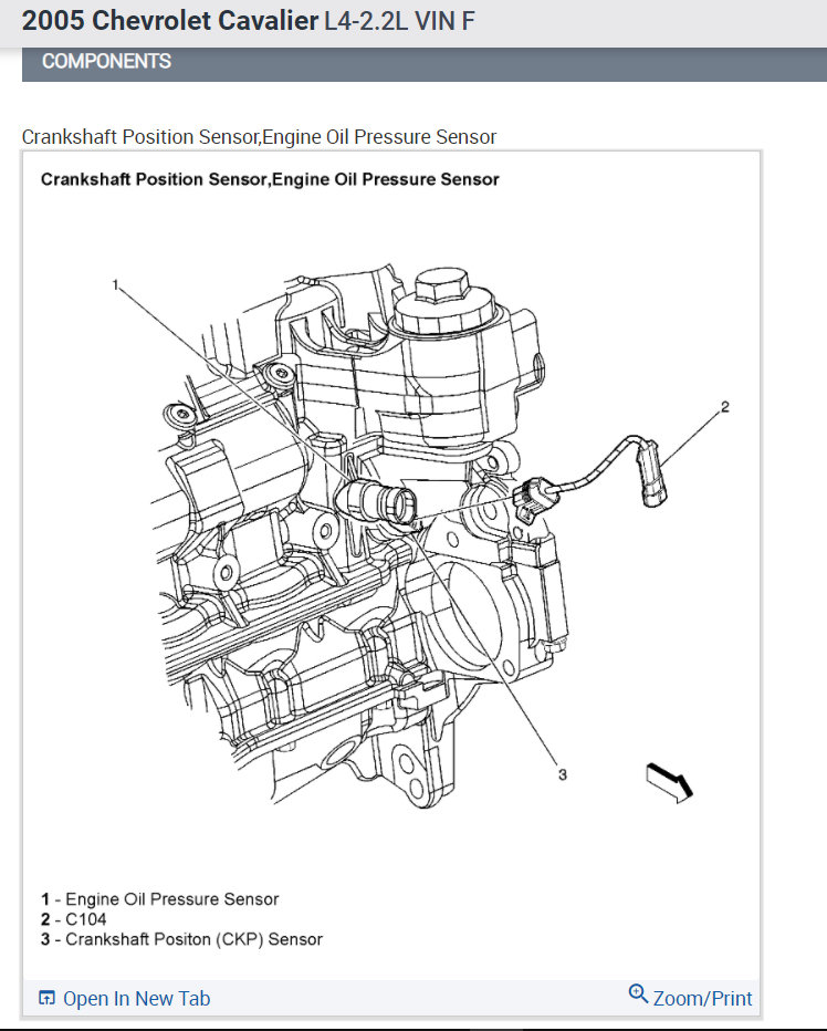

I have a 1997 Chevy Cavalier. When driving the car for long periods (30 mins or so) it starts to shake, jerk sometimes stall, and even cuts off sometimes when I stop or slow down. I've had a coil pack replaced, radiator replaced, fuel filter (brand new) and fuel pump replaced. The transmission has been rebuilt also. The car is still doing the same thing. Sometimes it stops on me and after sitting for 10 mins or so I can restart it and slowly get to my destination. I've tried almost everything.

This sounds like the crankshaft angle sensor is going ot which is common here is a guide to help walk you through the steps with the location of the sensor for your car in the diagrams below.
and this guide can help as well
https://www.2carpros.com/articles/engine-stalls
Check out the diagrams (Below). Please let us know what you find.
