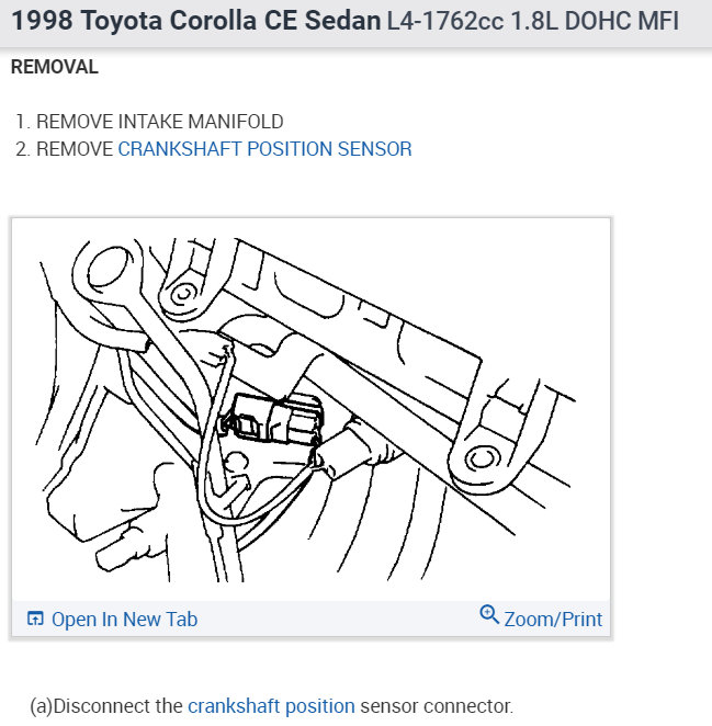

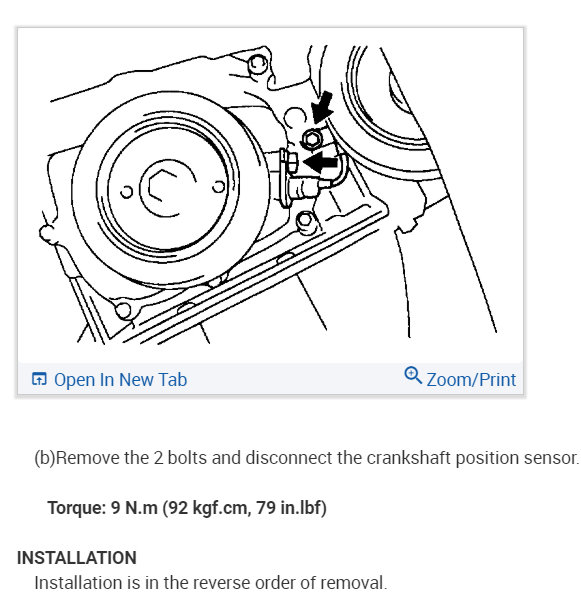

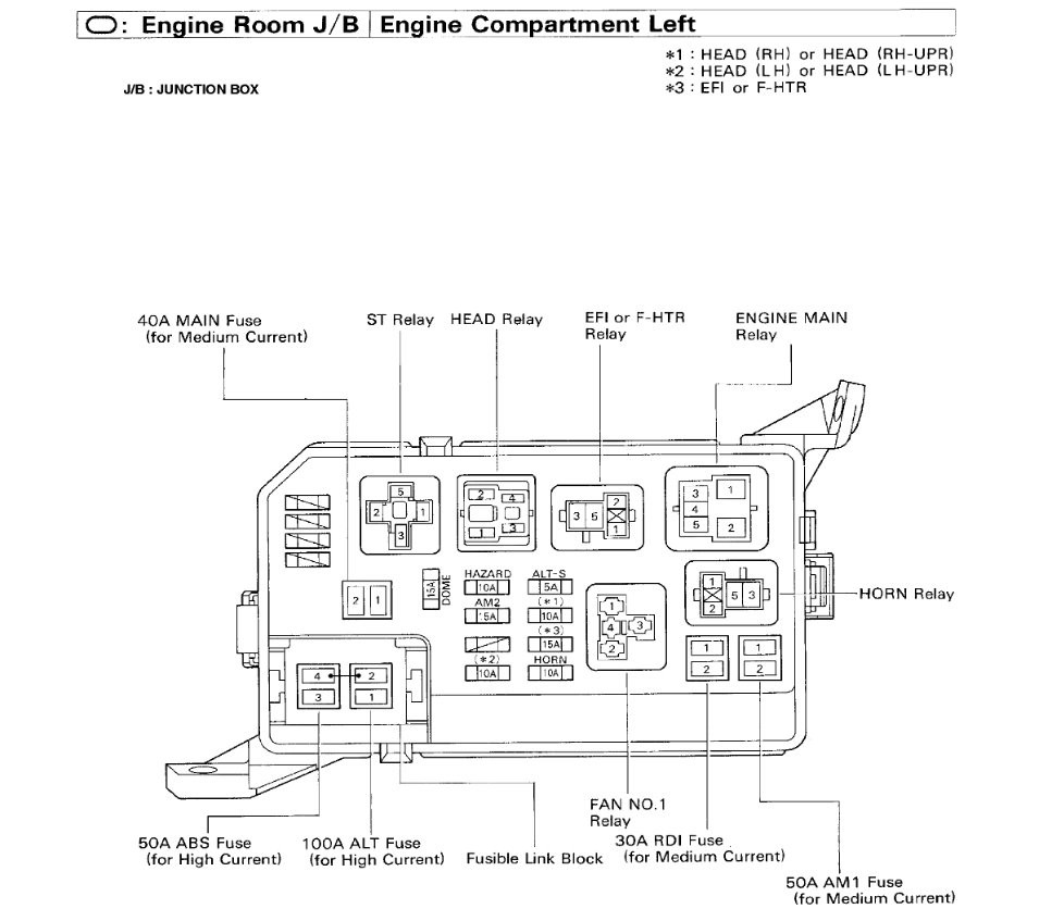

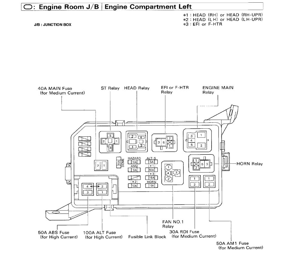

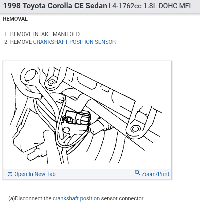

KEN L
  • MASTER CERTIFIED MECHANIC
  • 43,542 POSTS
It sounds like the crankshaft angle sensor is going out or the PGM FI - Engine relay is overheated and shutting down. Let's start by running the codes to see what comes up.
Here is the location of the sensor and the relay below. Check out the diagrams (Below). Please let us know what you find. Cheers, Ken

LOUISOW
Sorry for the late reply KEN and thanks on your speedy reply, I just got your text today so I will be meeting the Mechanic tomorrow to check on the PGM FI-Engine relay sensor as soon as that is done I will post you up for update I was able to have it fixed thanks a lot Ken.

LOUISOW
Hello Ken. I finally met with the technician but did not still have a positive respond. I guess the mistake was coming from me because I did not give you the exact specification of my car like the model. I was saying it was Toyota Corolla 1998 which is not correct. The model of my car is Toyota Corolla Compact VII (E100). Please check on this and let my know which part I could lay my hands on for the Tec to check it up ASAP waiting on your speedy reply thanks.
Thursday, January 21st, 2021 AT 2:35 PM (Merged)
KEN L
  • 43,542 POSTS
Is the relay not in the place the diagram states or? What is the problem with the information.? Looks the same on my end :)
