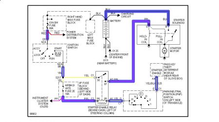

Car won't start. I replaced battery about 3 months ago. When I turn ignition; lights, radio, etc. Operate as usual, but the engine makes no sound to turn ov er (i.E., I don't think it's the battery).
Tuesday, August 4th, 2020 AT 1:05 PM (Merged)
  • 75,992 POSTS
Get the battery and alternator load tested if both okay make sure cables/posts are cleaned and properly tightened. Problem continues to exist, check and test the Airbag/VATS fuse 2E 10amp in I/P fuse block behind left side of dash,starter,starter enable relay located behind the dash left of steering column - park and neutral switch on the left side of transmission and ignition switch
