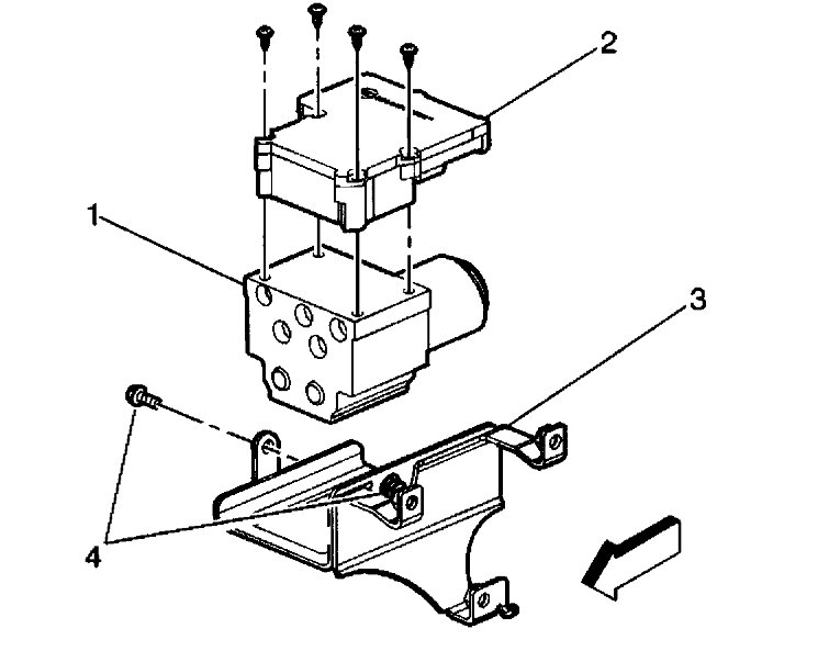

No bleeder screws on this one just 3 connectors and it’s under the truck. I was just thinking why bleed the lines when no fluid goes into the ABS Module. It’s literally a small flattish metal and plastic box with 3 connection spots and a circuit board inside.
Tuesday, February 23rd, 2021 AT 9:17 AM (Merged)
AL514
  • 4,214 POSTS
Okay, I see. I thought you were replacing the whole hydraulic unit. Yes the modules just bolt right on top of the hydraulic unit. I think this the same module as you're doing in this video . I don't see why you would have to flush the fluid in this case. Unless it's black, that means the seals in the master cylinder are going bad.

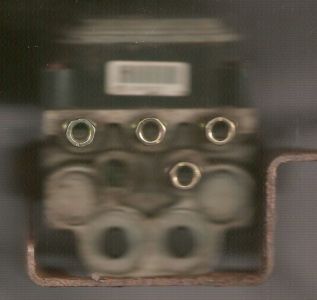

MY truck is a 1999 2wd ext cab. 56000 mi. 6cyl.
The abs module has 5 ports for hydraulic lines. Three in a row near the top of one end of the unit and two spaced just below those. Two of these ports are for input lines and three are for output. I need to know which ports are input (one front input and one input for the rear) and which are output (one output rear, two output front.)
http://www.2carpros.com/forum/automotive_pictures/82139_KHABS_1.jpg
DODGERAM333
Looking at your pict. Tr goes to rear brakes. Ct goes to rf, tl goes to lf. Bl goes thru proportioning valve and to the front of the master cylinder. Ll goes thru prop. Valve and to the rear of master cylinder. 02 dodge ram 3500.
