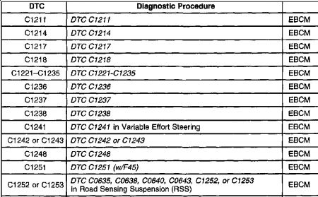

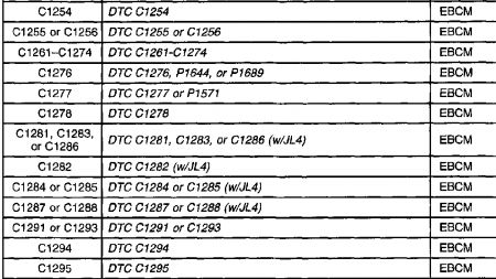

Gstacey, good work on this one! Just thought since I have access to the codes, I would lend you a hand..
DIAGNOSTIC TROUBLE CODE (DTC) DIAGNOSIS DTC Description C1211 ABS Indicator Lamp Circuit Malfunction C1214 System Relay Contact or Coil Circuit Open C1217 Pump Motor Shorted To Ground C1218 Pump Motor Circuit Shorted to Voltage or Motor Ground Open C1221 LF Wheel Speed Sensor Input Signal is 0 C1222 RF Wheel Speed Sensor Input Signal is 0 C1223 LR Wheel Speed Sensor Input Signal is 0 C1224 RR Wheel Speed Sensor Input Signal is 0 C1225 LF Excessive Wheel Speed Variation C1226 RF Excessive Wheel Speed Variation C1227 LR Excessive Wheel Speed Variation C1228 RR Excessive Wheel Speed Variation C1232 LF Wheel Speed Circuit Open or Shorted C1233 RF Wheel Speed Circuit Open or Shorted C1234 LR Wheel Speed Circuit Open or Shorted C1235 RR Wheel Speed Circuit Open or Shorted C1236 Low System Supply Voltage C1237 High System Supply Voltage C1238 Brake Thermal Model Exceeded C1242 Pump Motor Circuit Open C1243 BPMV Pump Motor Stalled C1248 EBCM Turned the Red Brake Warning Indicator On C1251 RSS Indicated Malfunction (w/F45) C1254 Abnormal Shutdown Detected C1255 EBCM Internal Malfunction C1256 EBCM Internal Malfunction C1261 LF Inlet Valve Solenoid Malfunction C1262 LF Outlet Valve Solenoid Malfunction C1263 RF Inlet Valve Solenoid Malfunction C1264 RF Outlet Valve Solenoid Malfunction C1265 LR Inlet Valve Solenoid Malfunction C1266 LR Outlet Valve Solenoid Malfunction C1267 RR Inlet Valve Solenoid Malfunction C1268 RR Outlet Valve Solenoid Malfunction C1271 LF TCS Master Cylinder Isolation Valve Malfunction C1272 LF TCS Prime Valve Malfunction C1273 RF TCS Master Cylinder Isolation Valve Malfunction C1274 RF TCS Prime Valve Malfunction C1276 Delivered Torque Signal Circuit Malfunction C1277 Requested Torque Signal Circuit Malfunction C1278 TCS Temporarily Inhibited By PCM
C1281 VSES Sensors Uncorrelate C1283 Excessive Time to Center Steering C1286 Steering Sensor Bias Malfunction (w/JL4) C1282 Yaw Rate Sensor Bias Circuit Malfunction (w/JL4) C1284 Lateral Accelerometer Sensor Bias Malfunction C1285 Lateral Accelerometer Sensor Circuit Malfunction (w/JL4) C1287 Steering Sensor Rate Malfunction C1288 Steering Sensor Circuit Malfunction (w/JL4) C1291 Open Brake Lamp Switch Contacts During Deceleration C1293 Code C1291 Set in Previous Ignition Cycle C1294 Brake Lamp Switch Circuit Always Active C1295 Brake Lamp Switch Circuit Open P1571 TCS PWM Circuit No Frequency P1644 Delivered Torque Output Circuit P1689 Traction Control Delivered Torque Control Circuit...lets try it like this...
https://www.2carpros.com/forum/automotive_pictures/62217_B1_1.jpg
https://www.2carpros.com/forum/automotive_pictures/62217_B2_1.jpg
https://www.2carpros.com/forum/automotive_pictures/62217_B3_1.jpg
