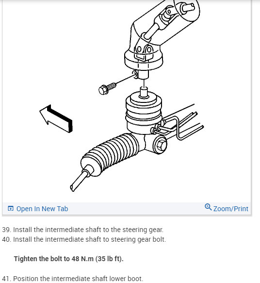

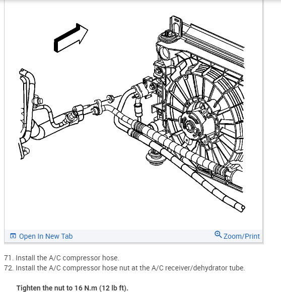

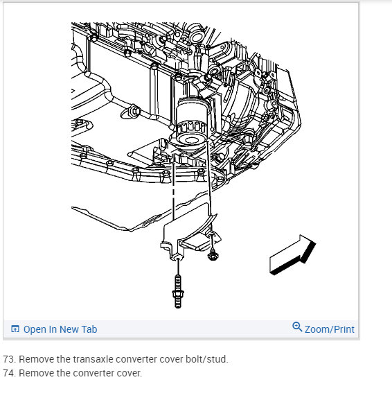

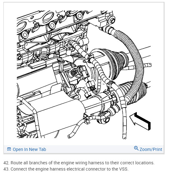

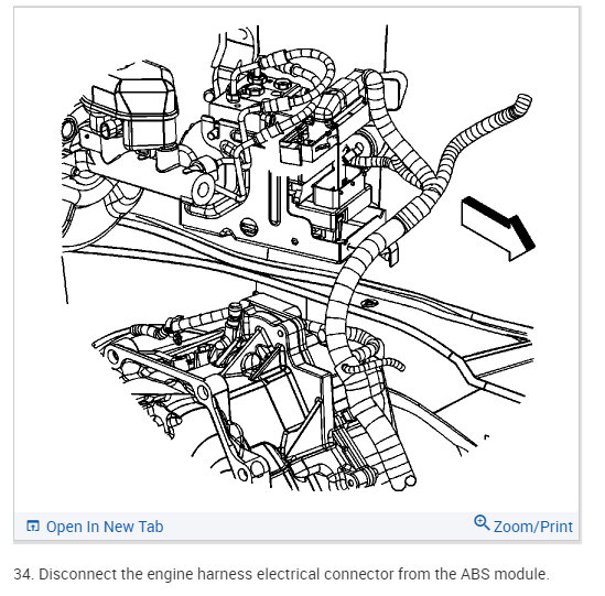

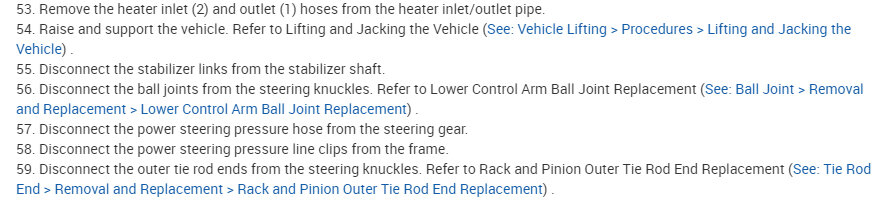

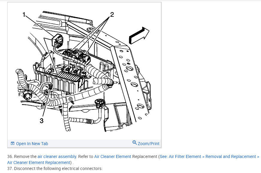

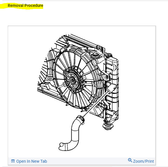

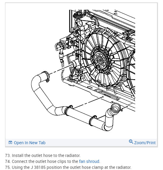

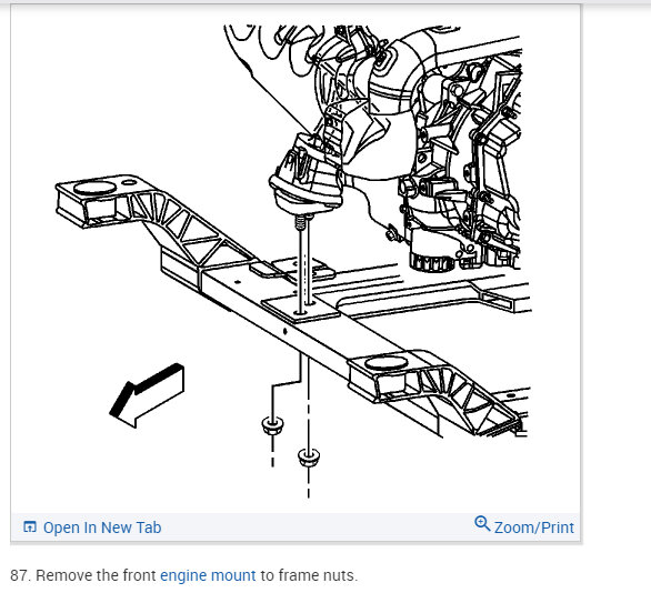

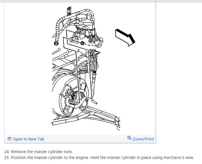

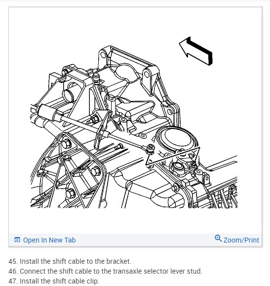

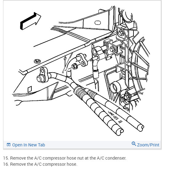

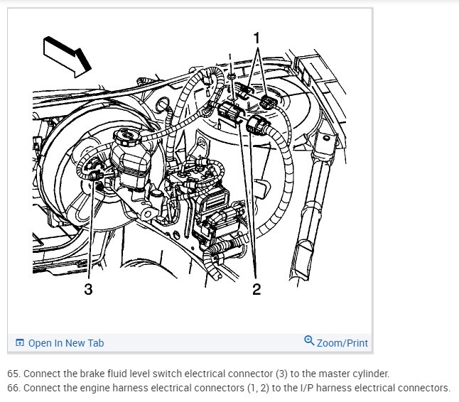

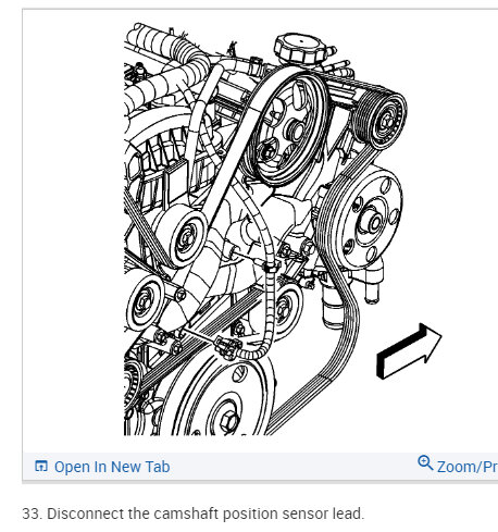

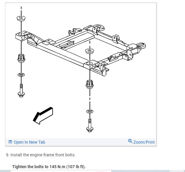

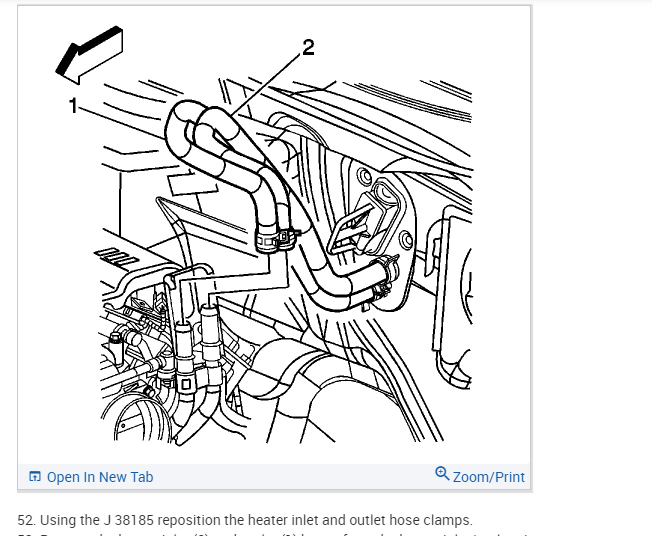

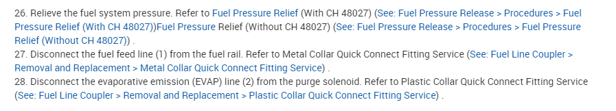

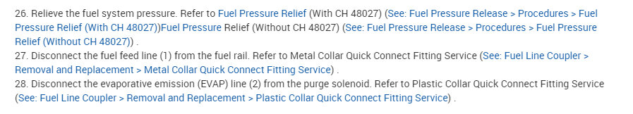

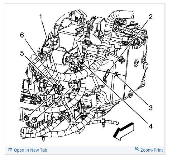

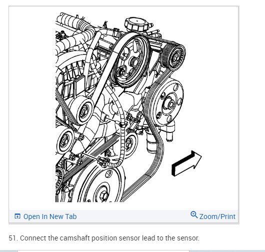

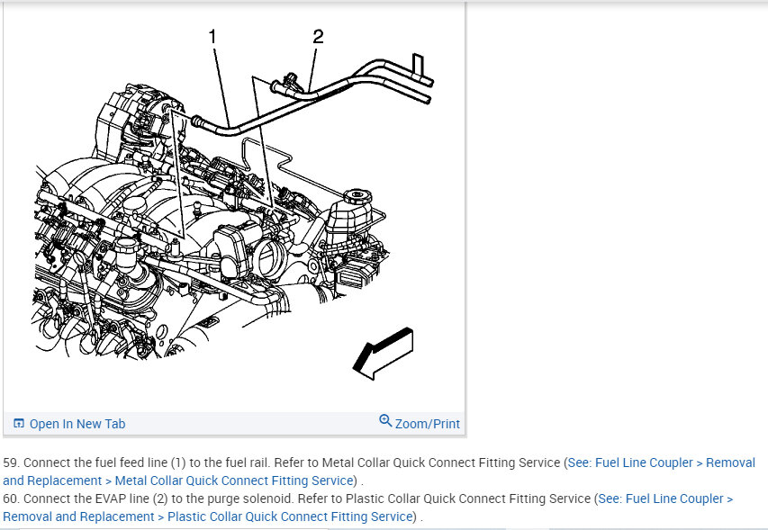

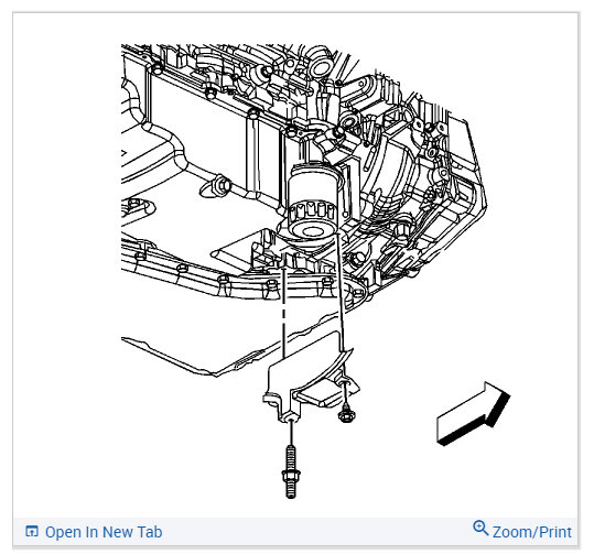

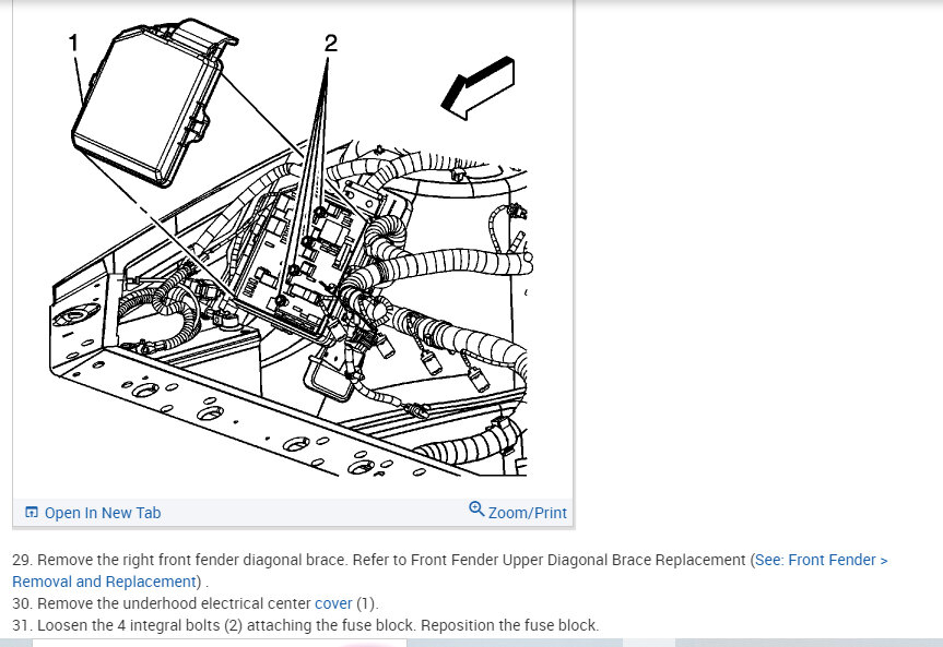

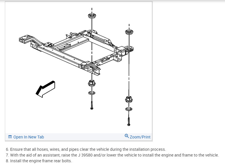

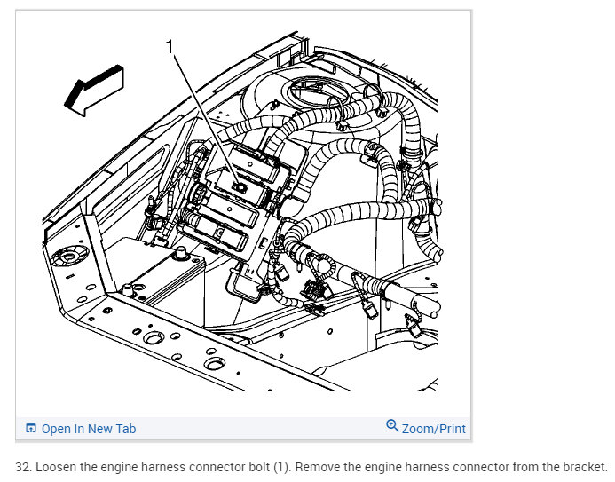

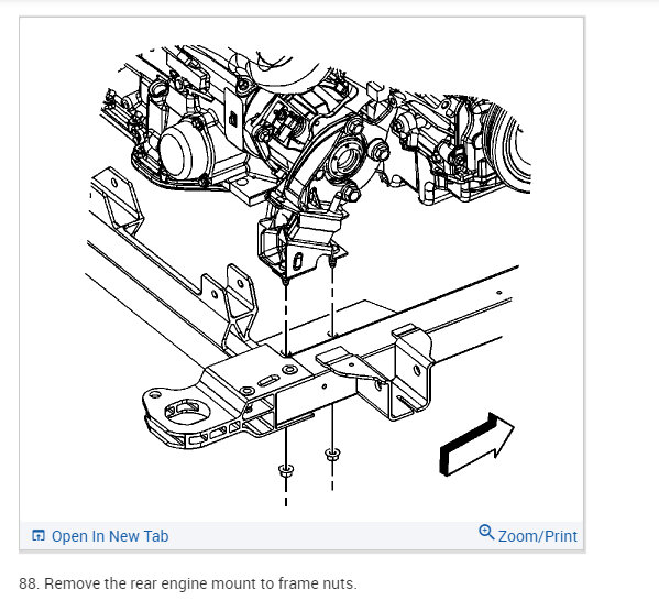

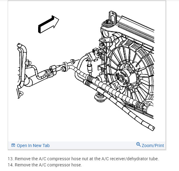

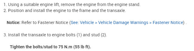

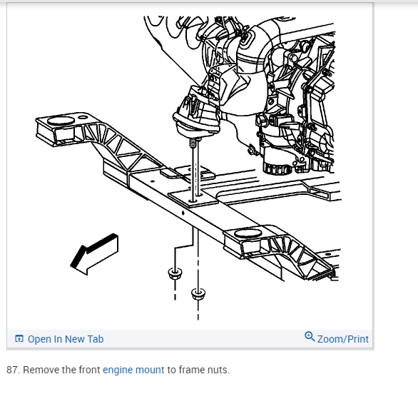

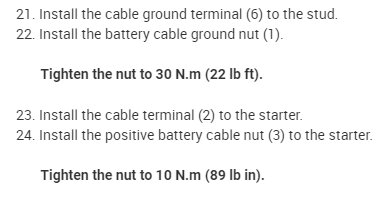

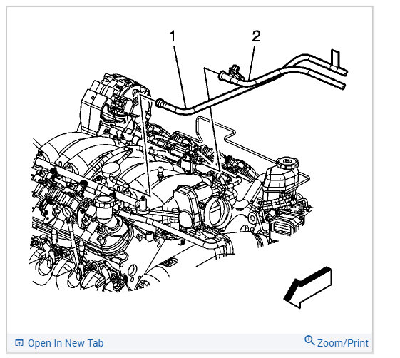

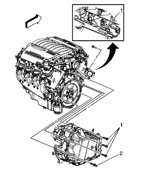

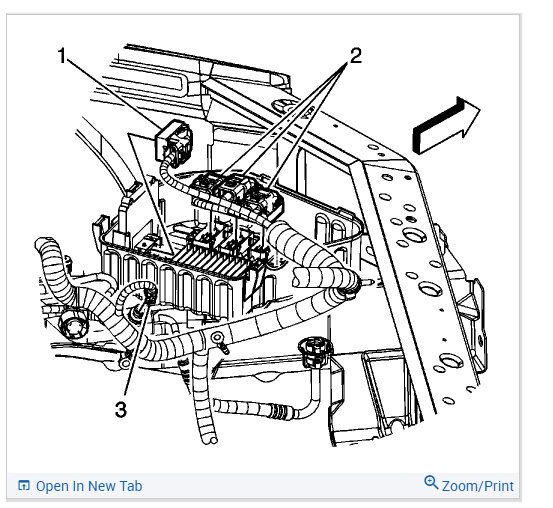

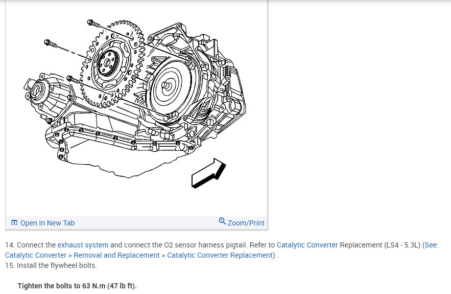

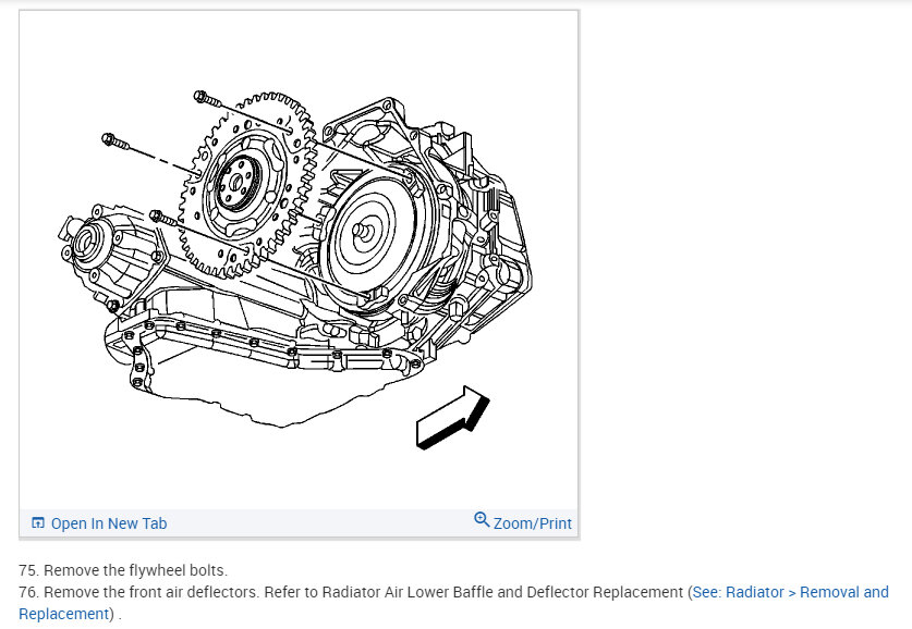

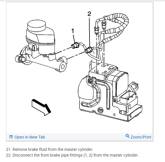

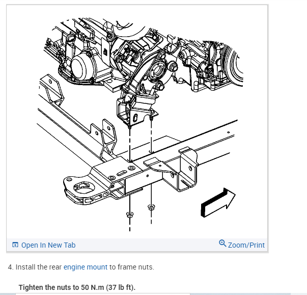

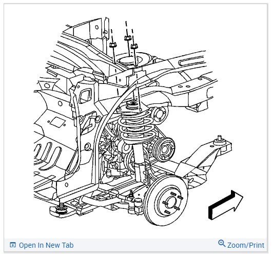

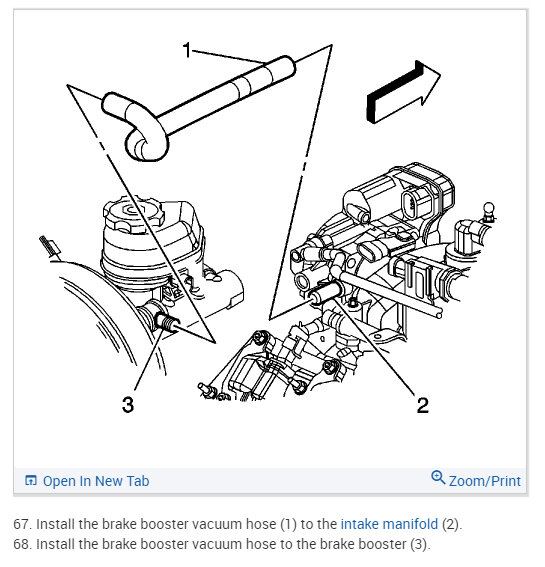

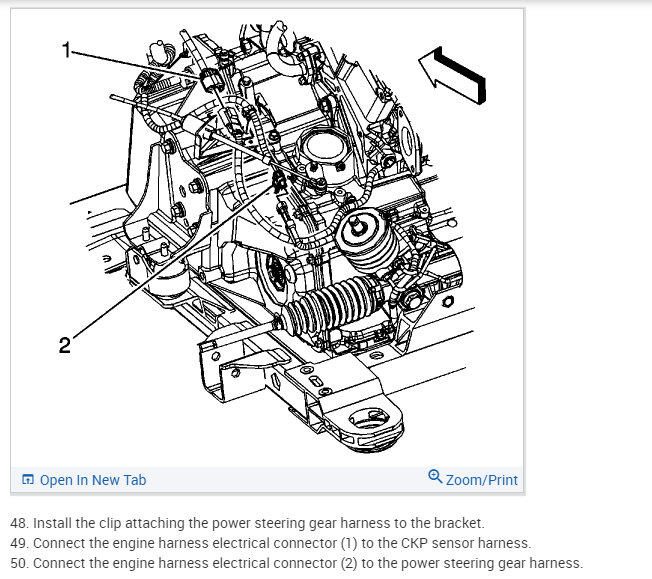

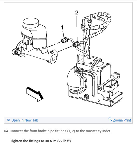

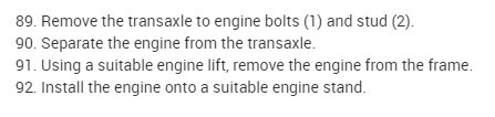

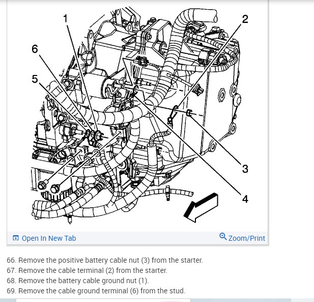

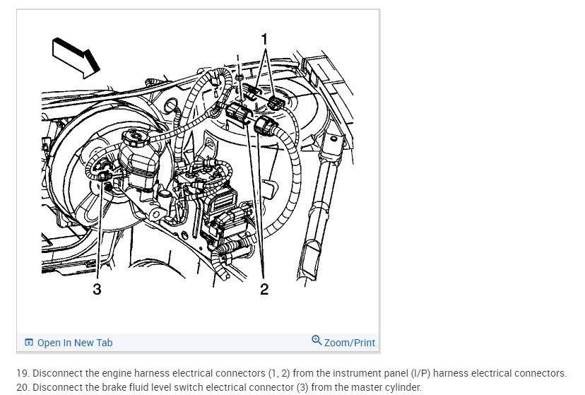

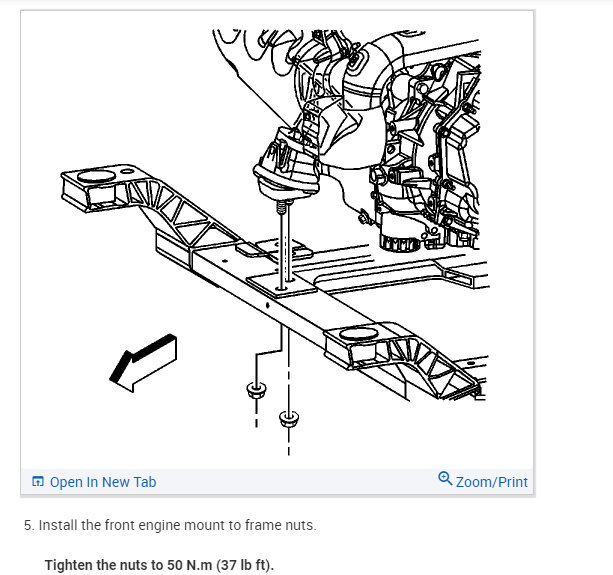

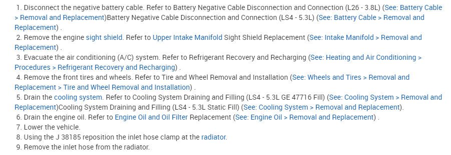

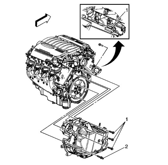

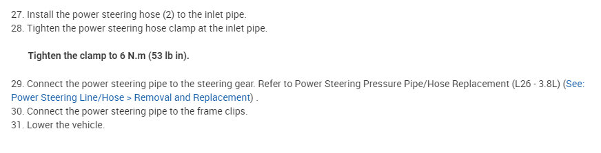

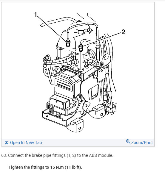

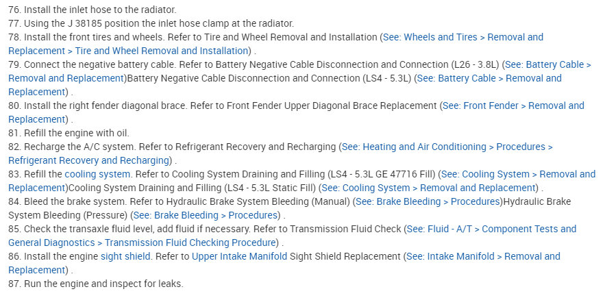

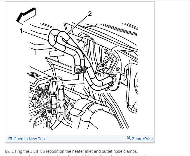

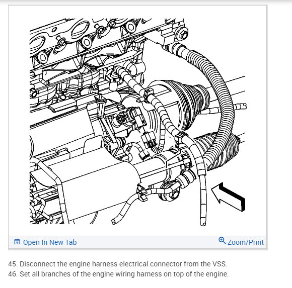

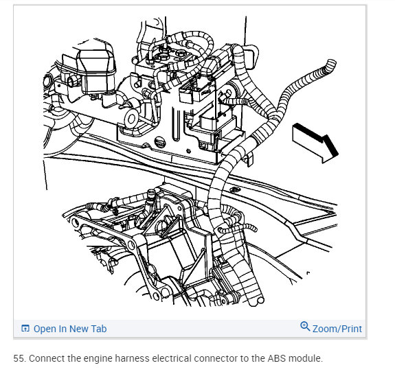

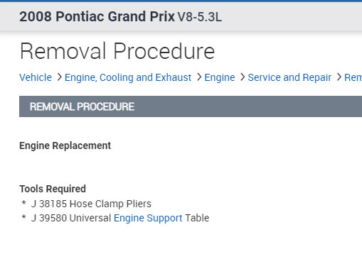

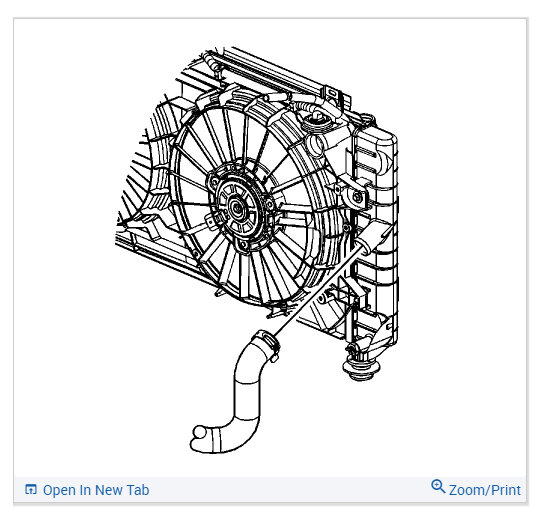

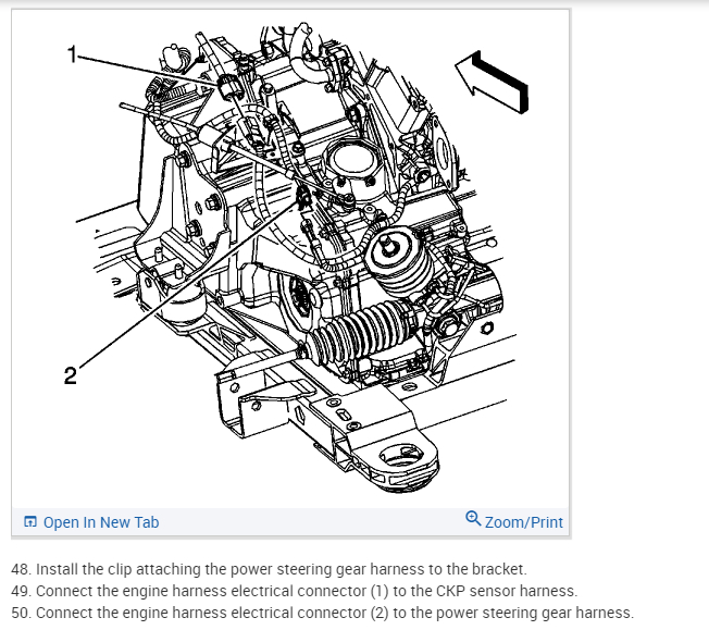

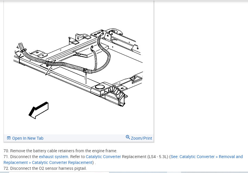

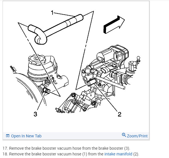

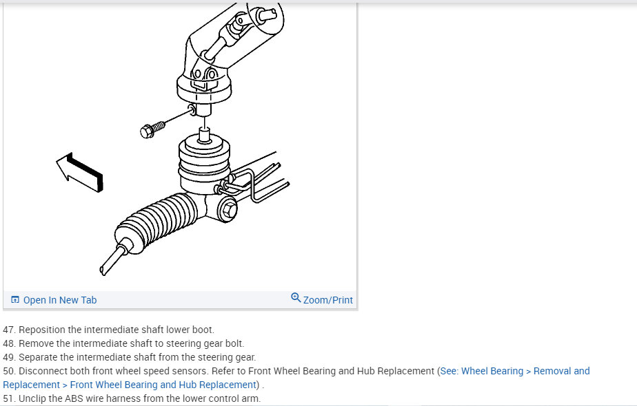

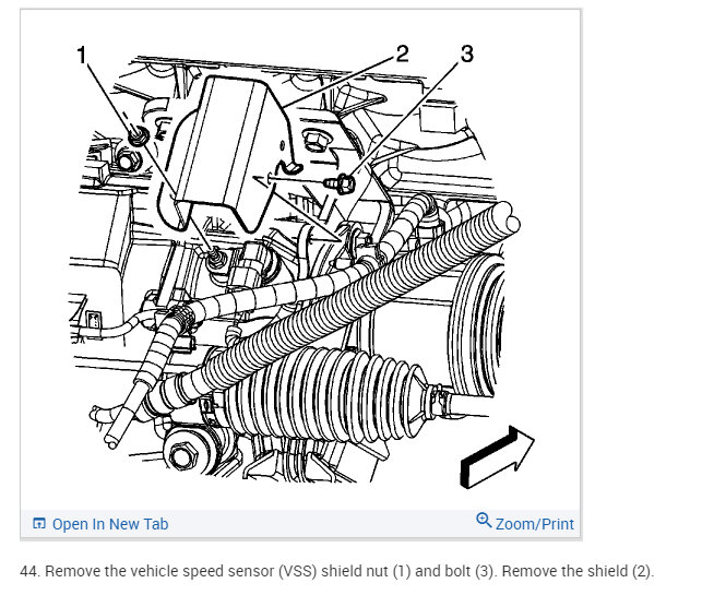

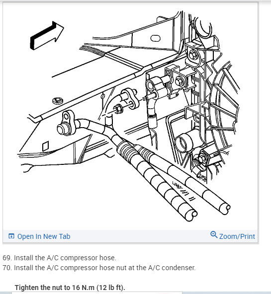

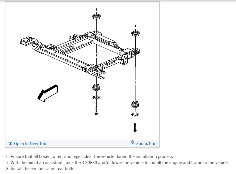

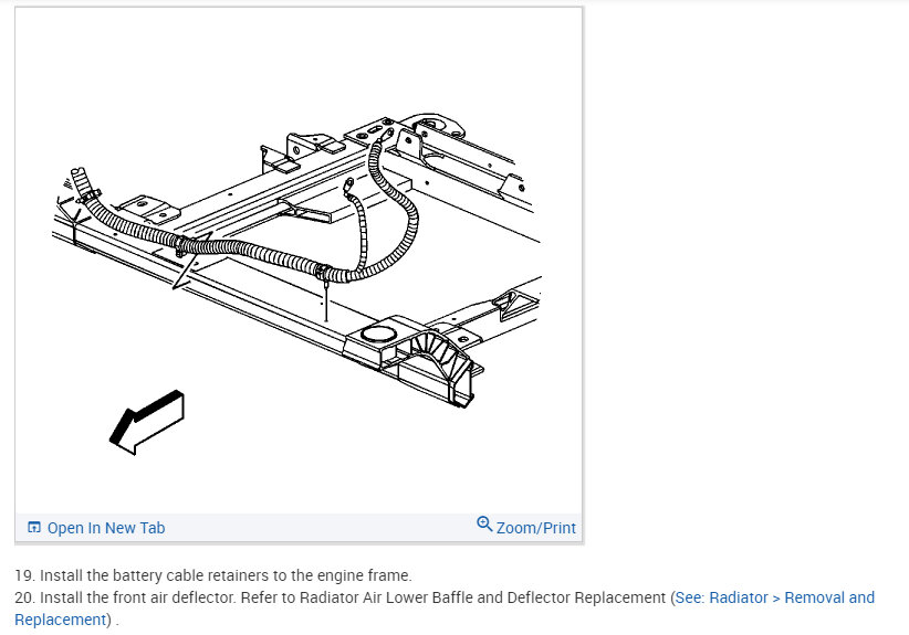

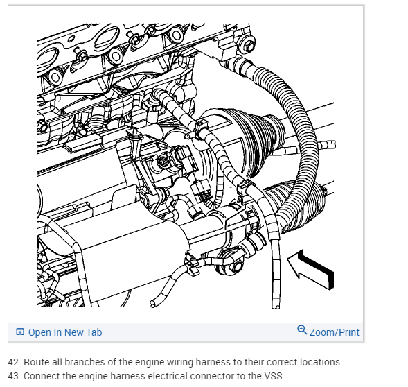

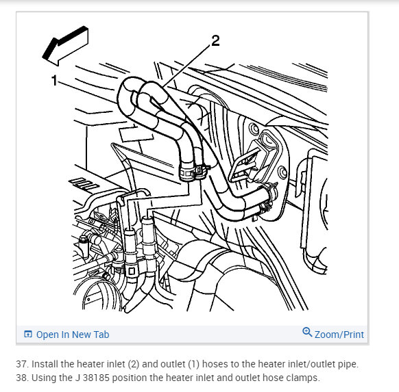

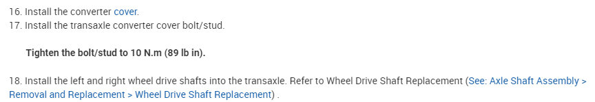

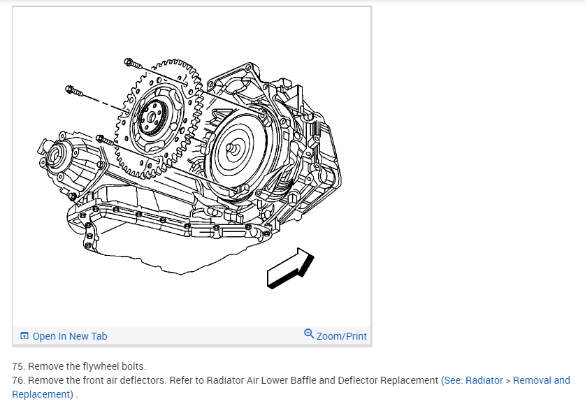

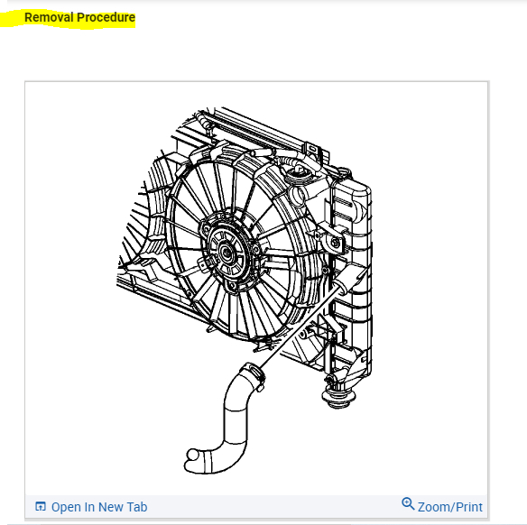

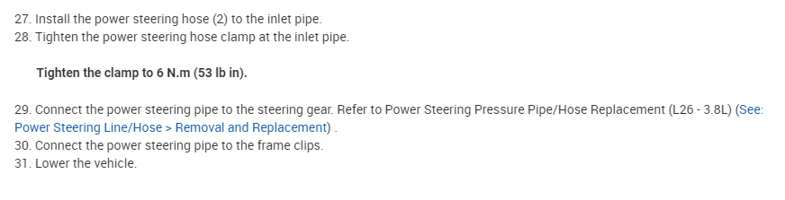

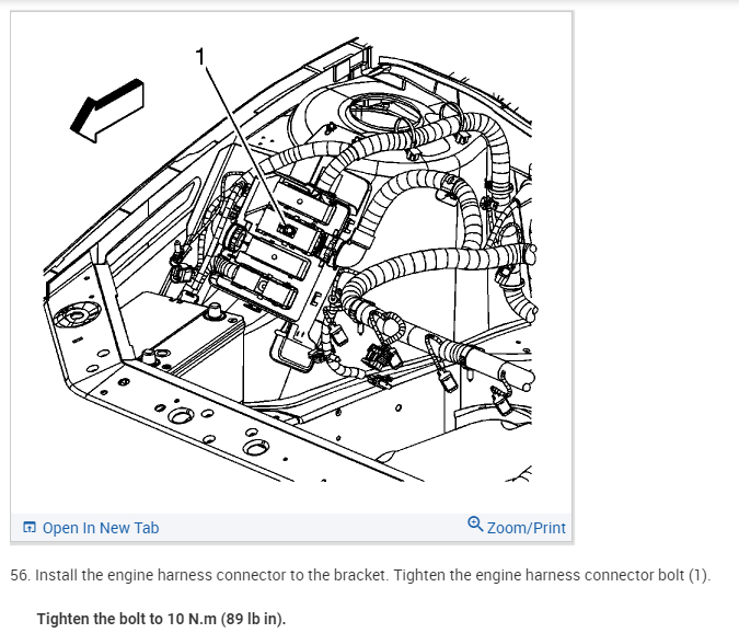

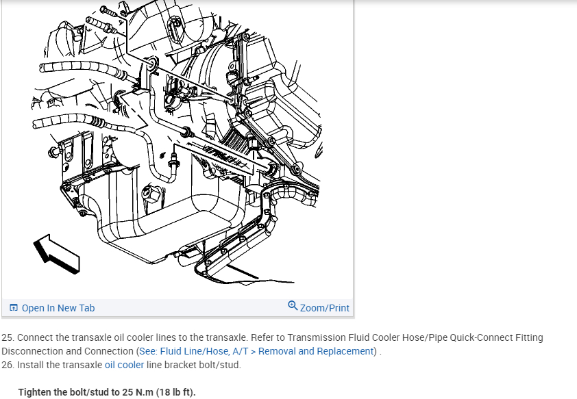

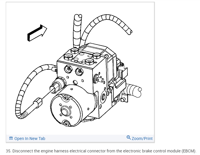

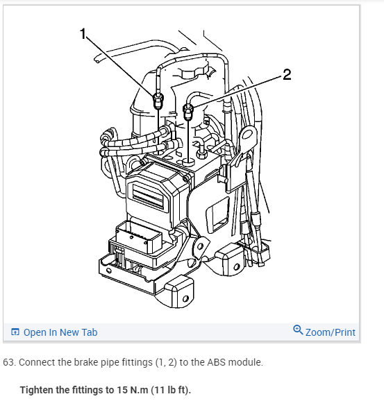

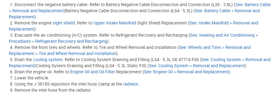

Do y'all have instructions on how to remove my engine from my car?
Thursday, December 1st, 2022 AT 2:07 PM
  • 109,758 POSTS

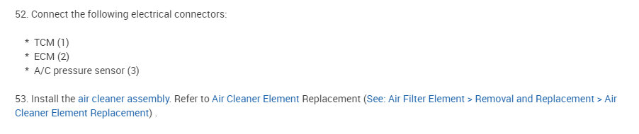

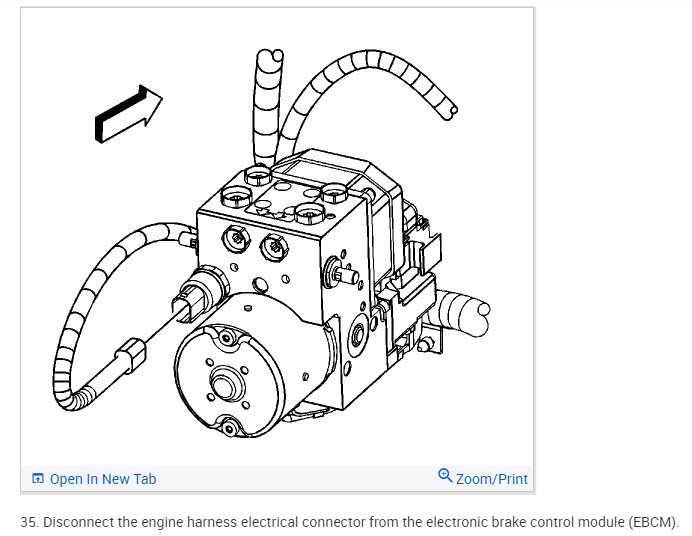

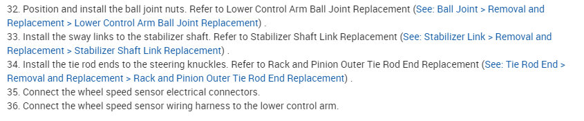

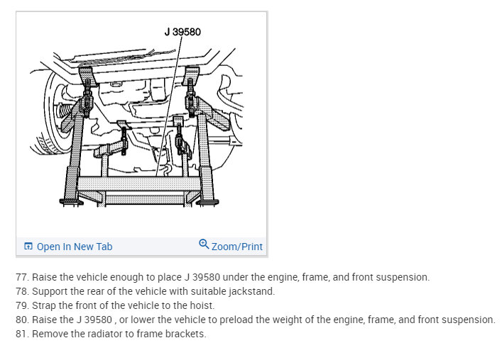

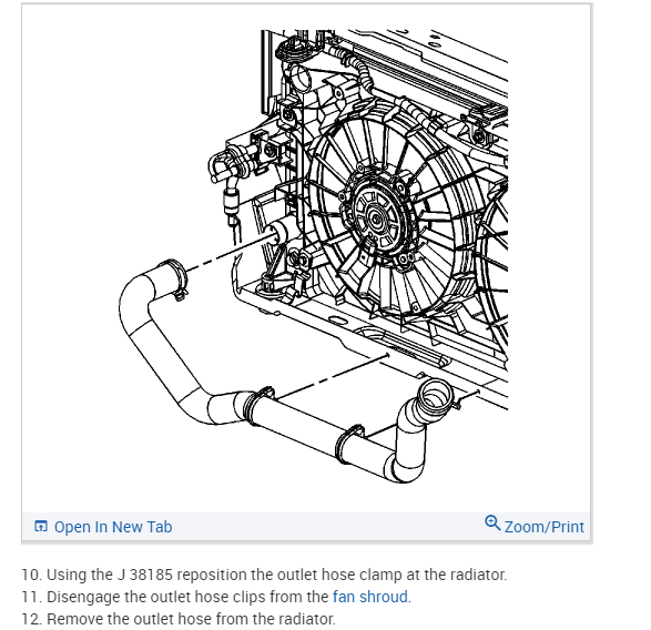

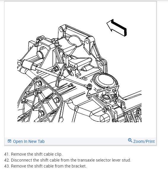

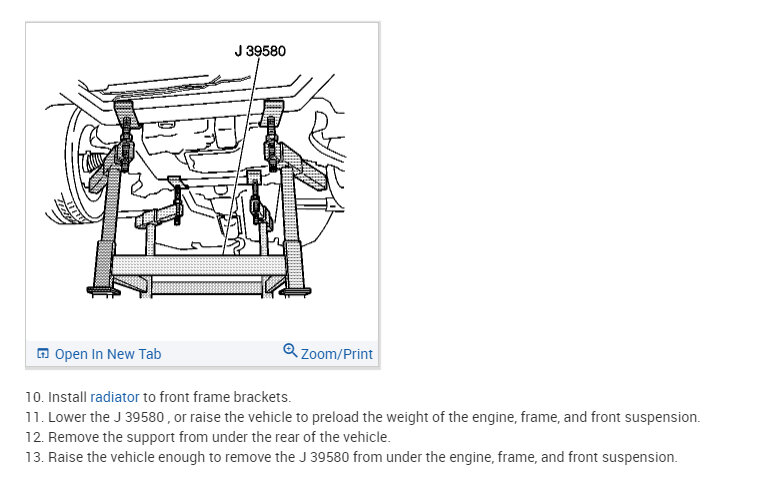

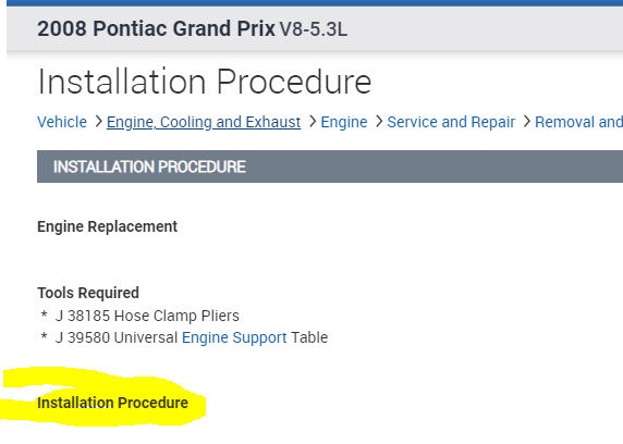

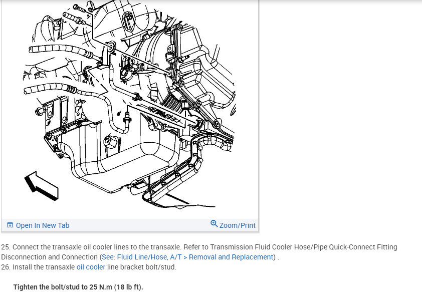

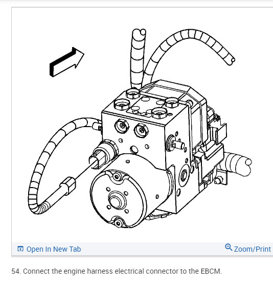

No problem. If you look below, the removal and installation procedures are provided.

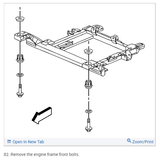

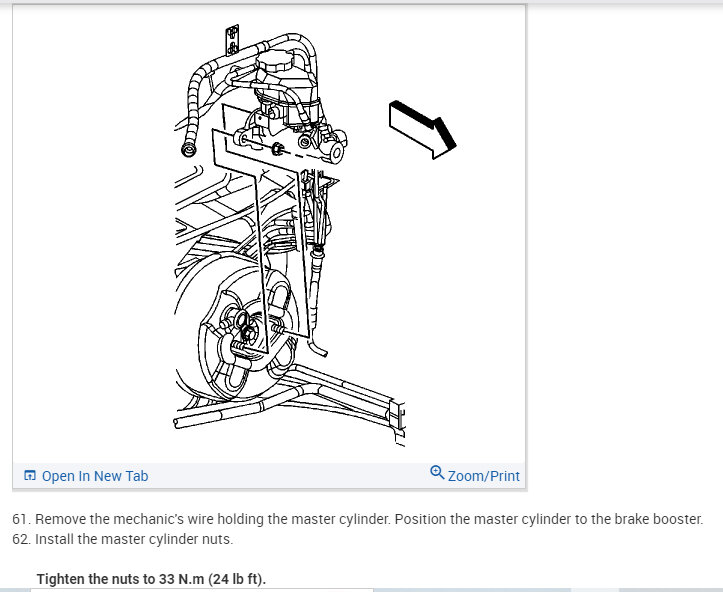

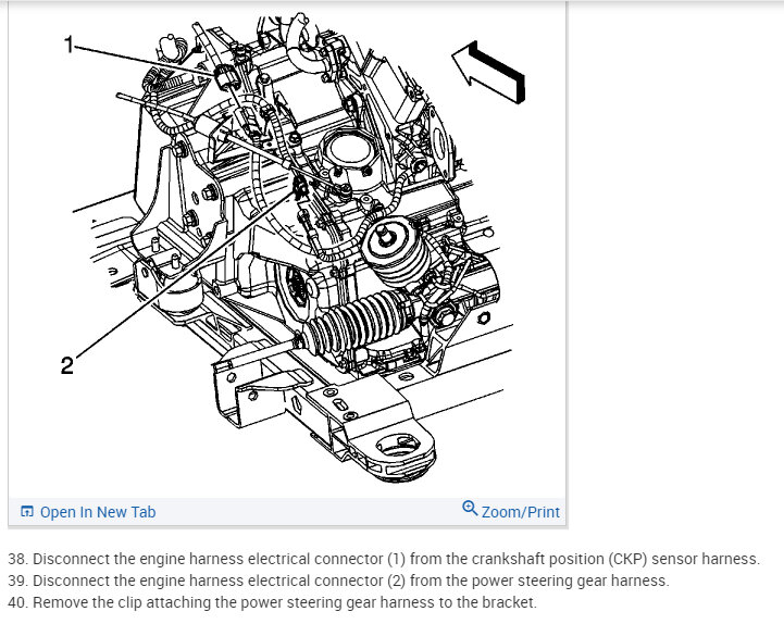

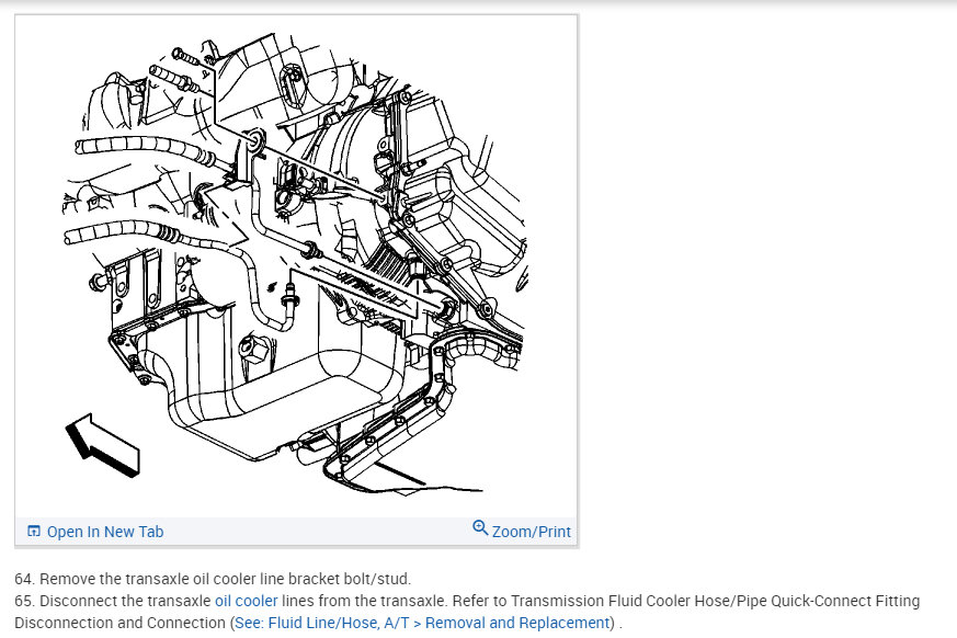

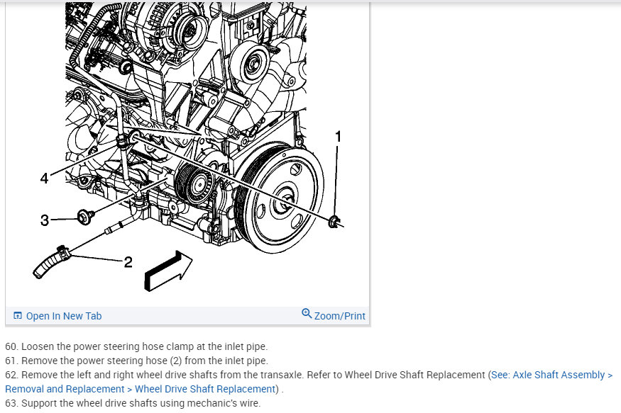

Because this has a V8 engine, most everything needs to be disconnected or removed. Also, the engine and transmission will be removed as a unit through the bottom of the engine compartment. As a result, the cradle or framing under the engine is removed with the trans and engine still attached to it.
Take a look through the directions and let me know if you have questions. Also, I would recommend that you follow the order provided and remove everything it indicates.
Let me know if this helps.
