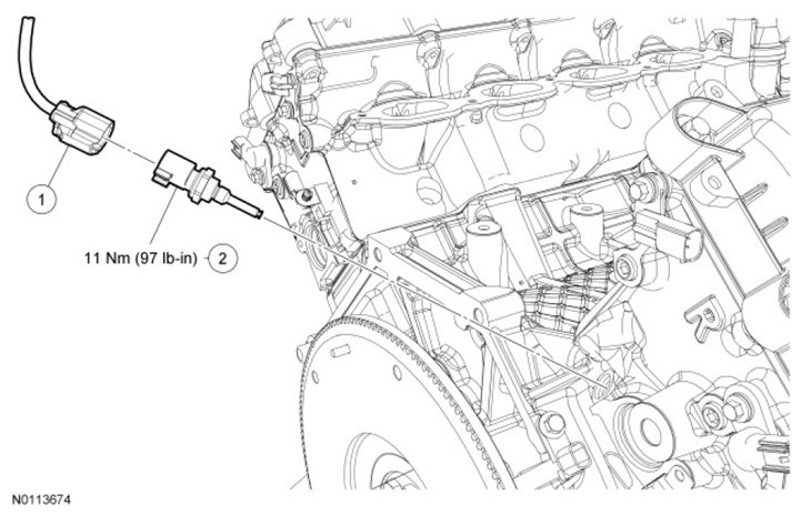

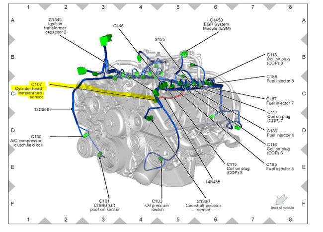

Where is the cylinder head sensor located?
Thursday, May 6th, 2021 AT 7:03 PM (Merged)
PATENTED_REPAIR_PRO
  • 1,853 POSTS
At the rear of the right cylinder head back near the flywheel/flex plate. Here is a diagram and a guide to help you step by step with diagrams BELOW to show your coolant sensor location.

How do you get to it? Do you need to remove the passenger fender well?
+4
Thursday, May 6th, 2021 AT 7:04 PM (Merged)
PATENTED_REPAIR_PRO
  • 1,853 POSTS
I bet if you mark, then remove the hood you can right down in there and remove it, but honestly, I do not think that you would have to. I know you probably will not have to remove the fender.
Have you even attempted to reach it yet?
LEROYBUBBA
Yes, I tried to get to it. Can get my hand on it but having trouble disconnecting the plug. Know I will have trouble getting socket in it.
Decided to change it because cooling fans would not kick on. After checking fuses, relays and making sure fans worked I found the weep hole on the water pump had antifreeze leaning out of it. Yesterday I Changed the water pump and replaced a 185 degree thermostat (changed one month ago due to overheating) with a 165 degree thermostat, the fans now come on. No overheating and noticed gas mileage improved. Old pump impeller good shape and did not slide on shaft but pump bearings had slack. What fixed the overheating issue?

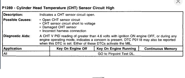

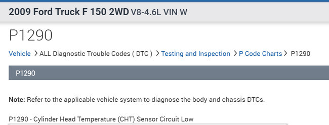

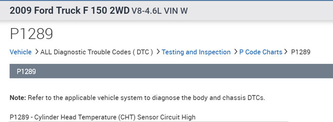

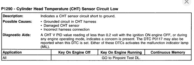

I have error codes P1289 and P1290; high input and low input. And is it fairly easy to replace?Thank you for your time, chuck

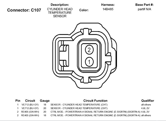

SCGRANTURISMO
  • 4,897 POSTS
I have included the information that you requested in the diagrams down below. I have also included diagnostic information on DTC's P1289 and P1290 as well. Please go through these guides and get back to us with what you are able to find out.
