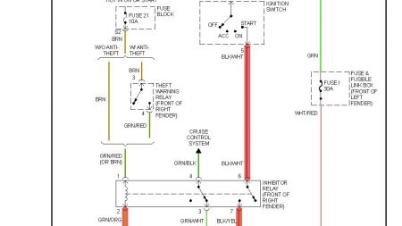

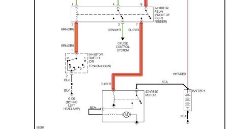

My car stalled after hitting the curb with the front wheel. When trying to start the car again, there were no cranking noise and I heard a click along with something that is trying to rotate (starter?). I could see my air bag light blinking when keyed to the ON position. It turns out that the battery was dead. I replaced the battery. I drove the car couple of times the first day. After two days, the problem occured again. I wasn't able start and when I try to start the same thing happened, no cranking noise, a click on the ignition and something under the hood is trying to spin. I checked the voltage of the battery and it was low about 10V. After a couple of try, the battery was down to 9V-8V. I tried to jump start but no luck. What could be the problem? Ignition switch? Starter? Alternator? Fuse? Fuel pump? Distributor? Maybe the battery just doesn't have enough juice to crank the starter?
One other thing is since the engine light was on, the code was P0505. IAC/AAC value? Does this affect the problem?

Get the battery and alternator load tested then comeback and we'll deal with the IACV/ACC

Yea, I load tested the alternator and the battery. It was acutally the alternator that is not charging the battery. Replaced the alternator and got a reading of 13-14.5 V when engine is on.
Now on to IACV/ACC problem. I haven't look into it much. But maybe it has something to do with the air flow sensor in the intake?
Monday, September 22nd, 2008 AT 12:25 AM
  • 75,992 POSTS
Cranking problems review the starter control circuit below
https://www.2carpros.com/forum/automotive_pictures/12900_st1_17.jpg
https://www.2carpros.com/forum/automotive_pictures/12900_st2_16.jpg
