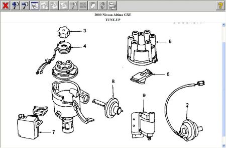

Hello! I tested the spark plug and you're right, there was an orange spak. However, when I went to the auto parts store, the clerk said my vehicle doesn't have an ignition coil. Could it be another part that's comprable to the ignition coil that my car has?
Tuesday, September 9th, 2008 AT 9:40 AM
KHLOW2008
  • 41,814 POSTS
Hi criallen,
All spark ignition engines will have ignition coils. Just that it is either in the distributor or outside or distributorless which will have coil packs.
Can you give me the engine variant and exact car model?
Wednesday, September 10th, 2008 AT 5:59 AM
CRIALLEN
It's a 2000 Nissan Altima GXE. The engine is 4 cylinder.
Wednesday, September 10th, 2008 AT 7:57 AM
KHLOW2008
  • 41,814 POSTS
Hi criallen,
I am surprised why the parts people say there is no coil if you have a distributor.
https://www.2carpros.com/forum/automotive_pictures/192750_Distributor00NissanAltimaGXE_1.jpg
Item # 9 = ignition coil.
Can't get the price list so maybe it is not sold separately.
