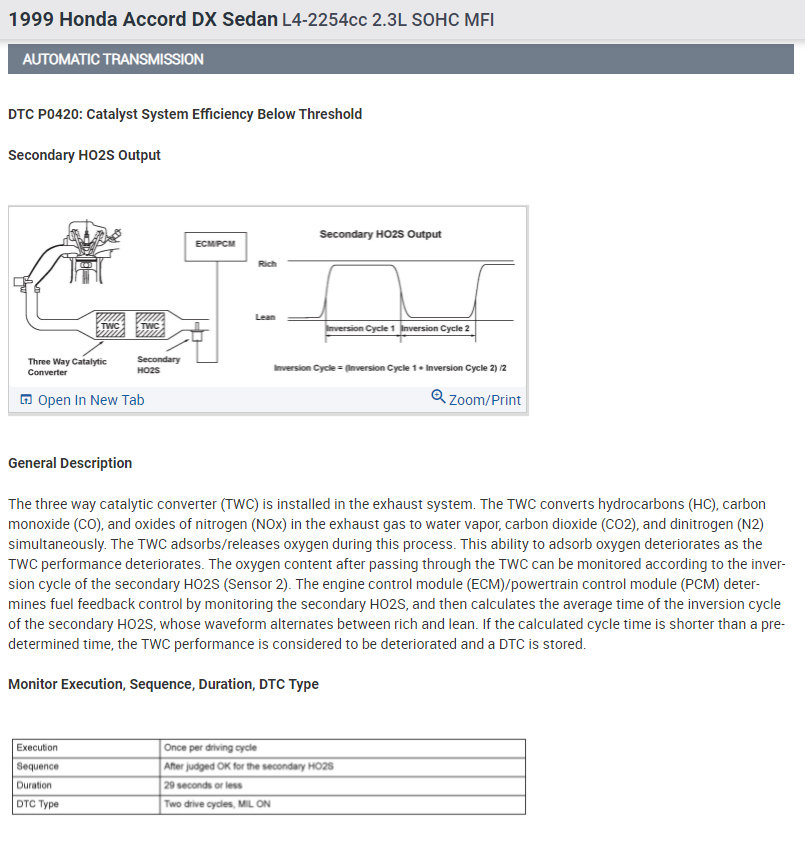

I have been having thi startup problem for 4 years now. Its not a show stopper but would like to fix it. At startup if my engine is warm (or was driven within last 20 minutes or so) my car dies if I don't give little bit of gas. Not giving gas leads to RPM droping to 0. But if I do give little bit of gas the rpm needle jumps and then drops down to slightly above 1000. Lately I have been getting the P0420 code. The first time I saw the Check engine light I read P0420 and turned it off. Next time the CEL came within 3 miles of filling up my gas tank I cleared it and it has not come back on yet in the last 20 miles of driving.
I have had the following done already on my car. Timing Belt, Water Pump, Distributor cap, spark plugs, wires replaced to solve other problems.
Thanks for the help

The code:
P0420: Catalyst System Efficiency Below Threshold
Typically you will get that code when there is issue with the oxygen sensor.
However with the drivability issue you are describing, you could have a clogged catalytic converter.
That's why you have to keep your foot the gas while starting otherwise the engine bogs down and stalls.
The catalytic converter has honeycomb shape fins inside of it and they can get clogged or restrictive to air flow. When this happened it will impact the drivability of the vehicle.

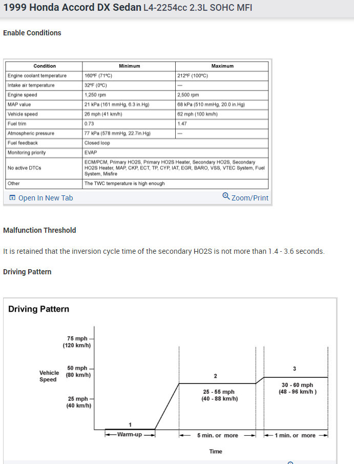

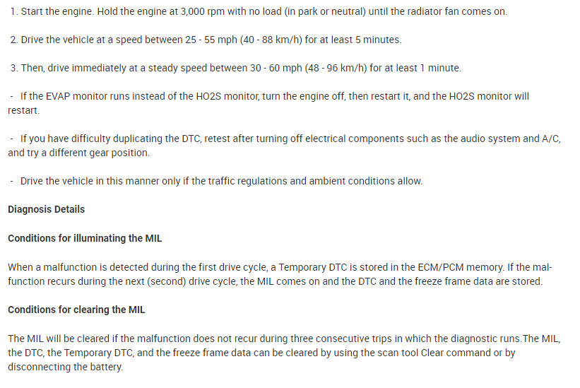

I have attached the diagnostics for the P0420 code.
