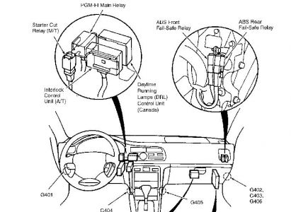

This car dies now and then while driving. Sometimes it starts right back up and other times it takes a while. Fuel? Ignition? We cant figure this out.

If it is intermittent and at times difficult to restart, I woud suspect a fuel related problem. Check the PGM-FI main relay which is known to cause such symptoms.
https://www.2carpros.com/forum/automotive_pictures/192750_PGMFIRelay95Accord_2.jpg
