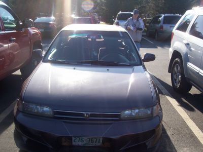

my car overheats bad the needle inside the car goes to the red line and then you can see a little smoke comin from passenger side under hood then when u stop it smokes bad and i am loosen ante freez i can fill the radeator and then 2 min later its all gone can u help me figure out the problum

The first thing you must do is get the cooling system pressure tested to locate this external coolant leak, have this attended to first and see if you still have over heating problems, failure to get this done will cause internal damage to your engine.
