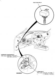

As you cranking do you have injector pulse ?
PGM-FI Main Relay located Behind left side of dash
http://www.2carpros.com/forum/automotive_pictures/99387_Graphic1_535.jpg
Monday, October 5th, 2009 AT 9:23 PM
GISLOC
  • 33 POSTS
Havnt checked that yet. But I did swap the main relay out with one that was suppose to work and still nothing.
