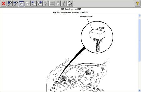

Hi Jessica Jenkins8082,
Get the PGM-FI main relay repaired/replaced and problem should be solved. Resoldering the relay works.
https://www.2carpros.com/forum/automotive_pictures/192750_PGMFIRelay92Accord_13.jpg
