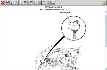

Hi Joelzak,
The PGM-FI main relay relay is faulty and all you need is a soldering gun and some solders to resolve the problem.
Remove the relay and resolder all the joints on the circuit board and it should work again. Take care not to get any terminals joined together due to overflowing of solders.
https://www.2carpros.com/forum/automotive_pictures/192750_PGMFIRelay92Accord_11.jpg
To remove the relay, unplug the connector and with your fingers, push at both sides from inner and oull the relay out. Save the trouble of removing the housing.
