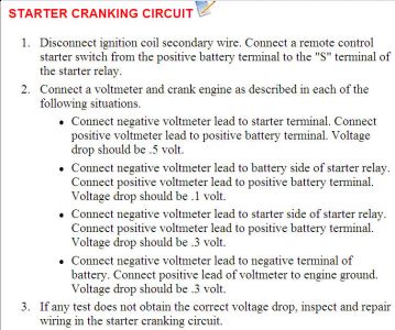

Thanks It worked, but now I have another problem, everytime I try to turn it over the solenoid just clicks. No response except for that click.

The solenoid connects the battery to the starter when the key is put into the start position.
https://www.2carpros.com/forum/automotive_pictures/30961_starter_2.jpg
Be sure the connections are clean and no corrosion present. While someone is holding the key in the crank position, someone else can tap on the starter with a hammer or similiar to jar it. That can flush out a starter going bad.
