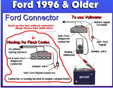

Yes the check engine light stays on. My girlfriends brother looked at it and he thinks it could be the intake gasget out. He said their is water in the oil and oil in the radiator.
Sunday, February 7th, 2010 AT 3:19 PM
MERLIN2021
  • 17,250 POSTS
https://www.2carpros.com/forum/automotive_pictures/62217_Pre_95_FordJump_7.jpg
Jump the two termnals shown together and turn key to "ON" and count the flashes... a 22 will flash as 2 flashes then a short pause, then 2 flashes, if more than one code is stored, the pause will be longer. The codes will display three times and end with 11 or 111. Write them down and post here. First do this with the key on engine off, then again with it running.
As for the oil abnd antifreeze mixing, this can be either a blown head gasket, cracked head, or cracked block, compression test the engine...
https://www.2carpros.com/dia/how_to_check_compression.htm
