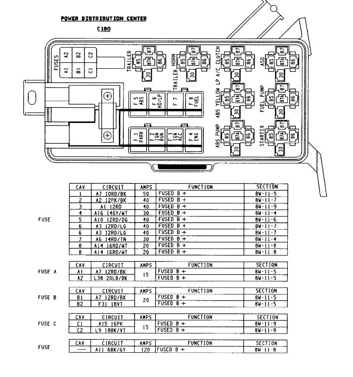

My truck stops running will driving down the road, It will start back up sometimes, but stops again. If I let it set for a hour or so it will start back up and run for about 5 to 10 mil and stop aging. I replaced the the fuel pump
can you help. Thanks

Check for spark, hook up a noid light to the fuel injector connector if you both check your IAC/MAP sensors.

I have seen the ASD relay overheat and stop working on these cars. Here is the location so you can change it out in the diagrams below. Check out the diagrams (below). Please let us know what happens.
