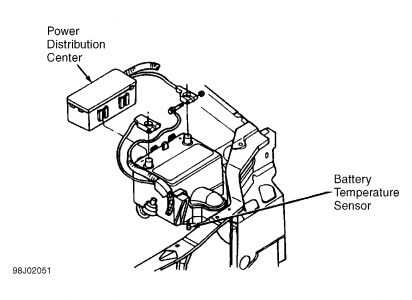

Please post the code that they got from the computer. Also check your Automatic Shut Down relay and possibly the camshaft sensor. CKP and CMP sensors work together for fuel delivery and ignition timing. Engine will not start if either one is not working properly.

I will go down there and find out what code # was tomorrow and let you know. And where is the Automatic Shut down relay located and what does it look like! Also thank you for your help!

Under the hood inside the power distribution box (fuse/relay box). Refer to the box for location of the relay.
http://www.2carpros.com/forum/automotive_pictures/55316_99neonpdc_1.jpg
http://www.2carpros.com/forum/automotive_pictures/55316_asdrelay_1.jpg

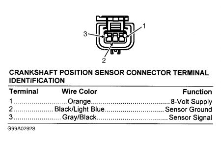

http://www.2carpros.com/forum/automotive_pictures/55316_99neonckps_1.jpg

7. Turn ignition off. Disconnect connector at crankshaft position sensor. Crankshaft position sensor is located on cylinder block, behind generator, near oil filter. See Fig. 41 . Turn ignition on. Using voltmeter, check voltage at terminal No. 1 (Orange wire) on connector for crankshaft position sensor. If voltage is more than 7 volts, go to next step. If voltage is 7 volts or less, go to step 16 .
8. Turn ignition off. Connect jumper wire to terminal No. 3 (Gray/Black wire) on connector for crankshaft position sensor. Turn ignition on.
9. Using scan tool, note state of CKP sensor. Momentarily touch remaining end of jumper wire to
terminal No. 2 (Black/Light Blue wire) on connector for crankshaft position sensor several times while monitoring CKP sensor state. If CKP sensor state changes to present, go to next step. If CKP sensor state does not change to present, go to step 11 .

11. Turn ignition off. Using ohmmeter, check resistance between ground and terminal No. 2
(Black/Light Blue wire) on connector for crankshaft position sensor. If resistance is less than 5 ohms, go to next step. If resistance is 5 ohms or more, repair open circuit or high resistance on Black/Light Blue wire between PCM and crankshaft position sensor. PCM is located at driver's side front corner of engine compartment, between battery and fender. Perform TEST VER-2A .
12. Ensure ignition is off. Disconnect connectors at PCM. PCM is located at driver's side front corner of engine compartment, between battery and fender.
13. Using ohmmeter, check resistance between terminal No. 3 (Gray/Black wire) on connector for
crankshaft position sensor and PCM connector terminal No. 32 (Gray/Black wire). If resistance is
less than 5 ohms, go to next step. If resistance is 5 ohms or more, repair open circuit on Gray/Black wire between PCM and crankshaft position sensor. Perform TEST VER-2A .
14. Ensure connectors are still disconnected at PCM. Using ohmmeter, check resistance between ground and terminal No. 3 (Gray/Black wire) on connector for crankshaft position sensor. If resistance is 5 ohms or more, go to next step. If resistance is less than 5 ohms, repair short to ground on Gray/Black wire between PCM and crankshaft position sensor. Perform TEST VER-2A .
