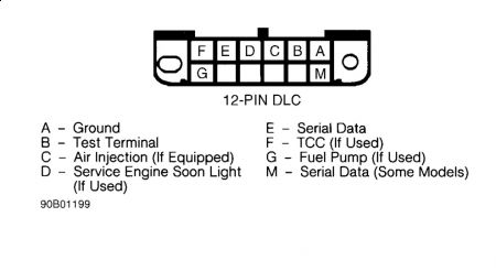

Hi, if your OBD1, you can get mil codes without a scanner. If you have the spider fuel system, the fuel poppets may need cleaning. Do you have the 12 pin data link connector? If so, if you use a jumper wire between A & B terminals of the data link connector, turn key till dash lightes come on, no further. The mil starts flashing, you count the flashes to get the codes. Your looking for two digit codes.
https://www.2carpros.com/forum/automotive_pictures/170934_astro_dlc_1.jpg
