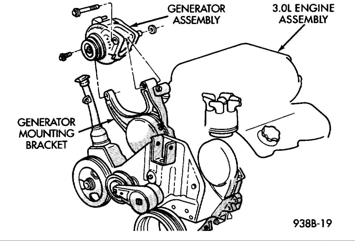

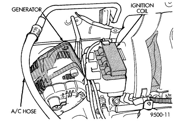

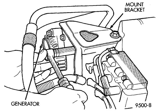

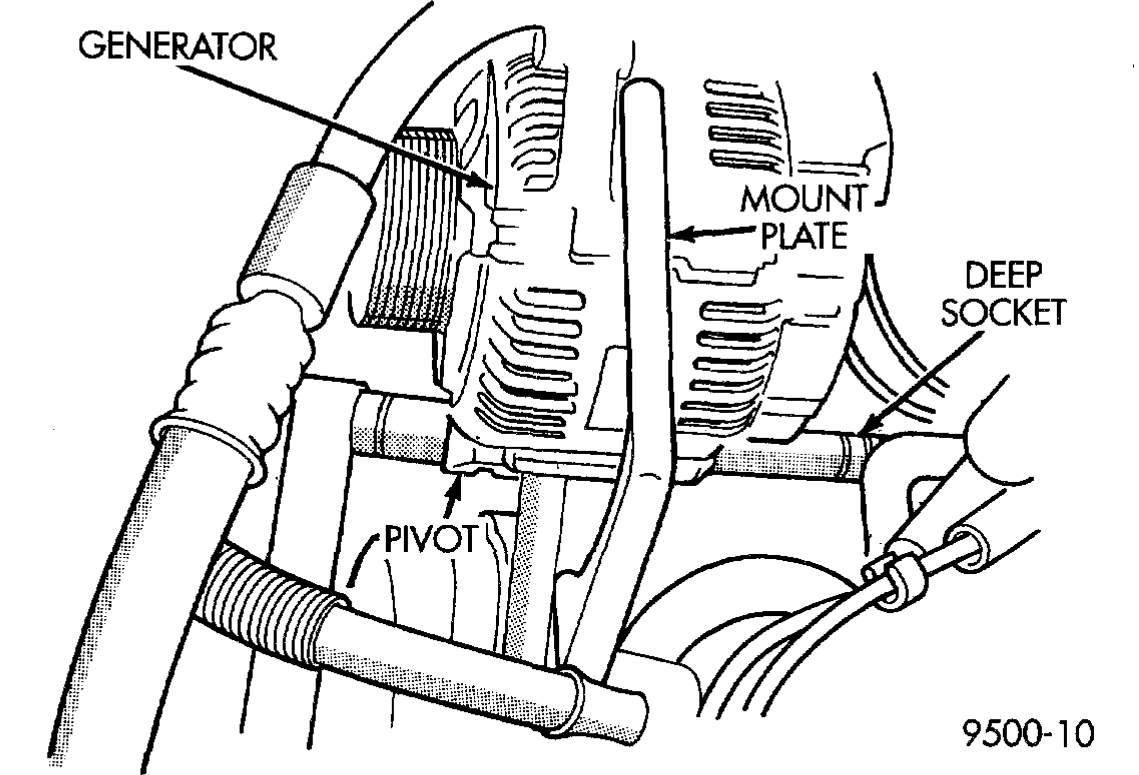

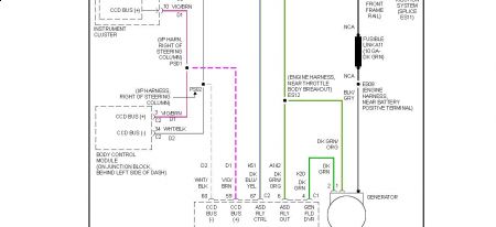

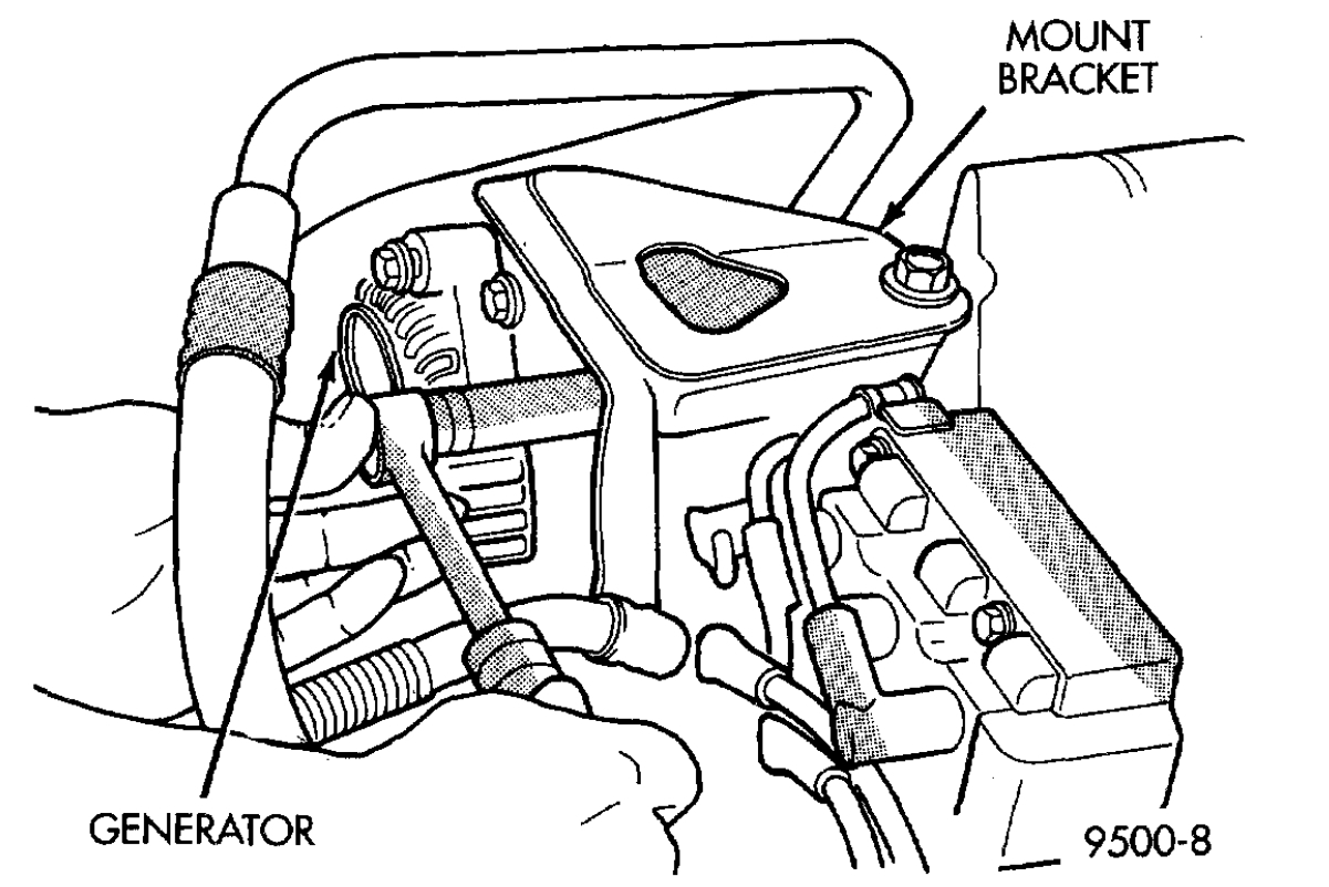

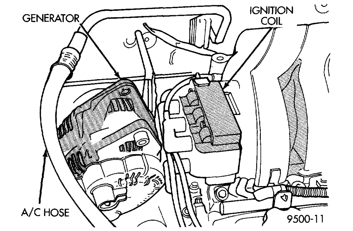

Okay, I attached a procedure for the replacement of the alternator for you and the test for verifying the repair when completed.
https://www.2carpros.com/articles/how-to-replace-an-alternator
I also attached a wiring diagram of the system for you.
REMOVAL
1. Release hood latch and open hood.
Removal/Installation Of Battery Cables
2. Disconnect battery negative cable.
3. Remove windshield wiper housing, refer to Windshield Wipers and Washers for proper procedures.
4. Remove accessory drive belt.
Generator Mounting Bracket
5. Remove bolt holding top of generator mount bracket to engine air intake plenum.
6. Remove bolts holding outside of generator mount bracket to generator mount plate.
7. Remove bolt holding top of generator to mount bracket.
8. Remove generator mount bracket from vehicle.
9. Rotate generator toward rear dash panel.
Generator
10. Disconnect the push-in field wire connector from back of generator.
11. Remove nut holding B+ wire terminal to back of generator.
12. Separate B+ terminal from generator.
Generator Pivot Bolt
13. Remove bolt holding bottom of generator to lower pivot bracket.
Generator
14. Remove generator from vehicle.
INSTALLATION
1. Place generator in position on vehicle.
2. Install bolt to hold bottom of generator to lower pivot bracket.
3. Place B+ terminal in position on generator.
4. Install nut to hold B+ wire terminal to back of generator.
5. Connect the push-in field wire connector into back of generator.
6. Rotate generator forward away from dash panel.
7. Place generator mount bracket in position on vehicle.
8. Install bolt to hold top of generator to mount bracket.
9. Install bolts to hold outside of generator mount bracket to generator mount plate.
10. Install bolt to hold top of generator mount bracket to engine air intake plenum.
11. Install accessory drive belt.
12. Install windshield wiper housing, refer to Windshield Wipers and Washers for proper procedures.
13. Connect battery negative cable.
14. Verify generator charge rate.
Friday, February 12th, 2021 AT 1:22 PM (Merged)

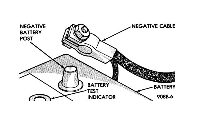

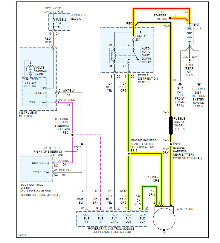

Hello sirs. My battery light is on in my van. The check engine light is not on. I had the alternator checked and that is good, I installed a new battery and thats good. When I start it up the car starts up good, but sometimes I hear some fluttering from the Auto shutdown relay. I have a semi-loud squeeling from below in the engine, but somewhere between the alternator and the battery, something isnt right. When the car was started, I took off the negative lead on the battery and the car went off! Please help!
  • 75,992 POSTS
Inspect and test fuse no.2 10amp and fuse no.17 20amp and the ASD relay-could be the computer controlled of the alternator field generation driver that's built within-See Charge system EWD.
https://www.2carpros.com/forum/automotive_pictures/12900_c1_25.jpg
https://www.2carpros.com/forum/automotive_pictures/12900_c2_23.jpg

AAAGGGGHHH! Don't pull the battery cable off!
That trick worked years ago with carbureted cars, but if the charging system is working, the computers on your van can be destroyed. It's possible for system voltage to go as high as 18 volts at idle, and 35 volts if you raise engine speed, without the battery in the circuit to help regulate system voltage.
Do you have a digital voltmeter? I assume the battery light is still on. Is that correct?

  • 75,992 POSTS
Read the battery's open voltage before you start the vehicle should read 12.4 or better, start vehicle read again should be 13.5-15.5volts with a load-if its reading battery open voltage-the alternator is not doing its job or wiring and computer problem-review the EWD

  • 75,992 POSTS
But my battery light is still on and my hanes book told me to take it to the dealer for it is nothing I could do for this problem.
Battery light keeps coming On-could mean a problem with the computer controlled of the alternator's field generation driver circuit
